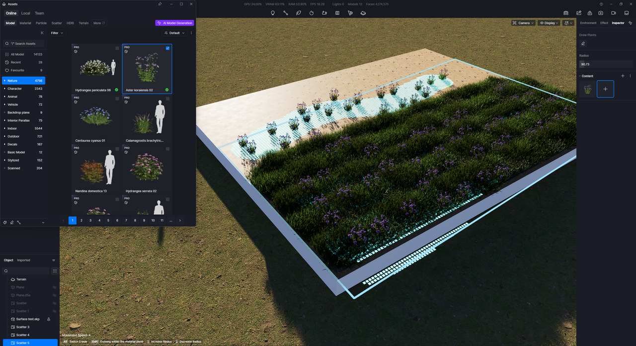

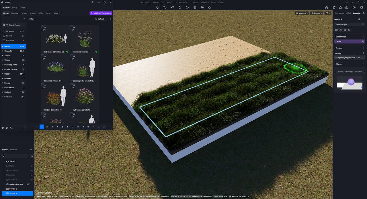

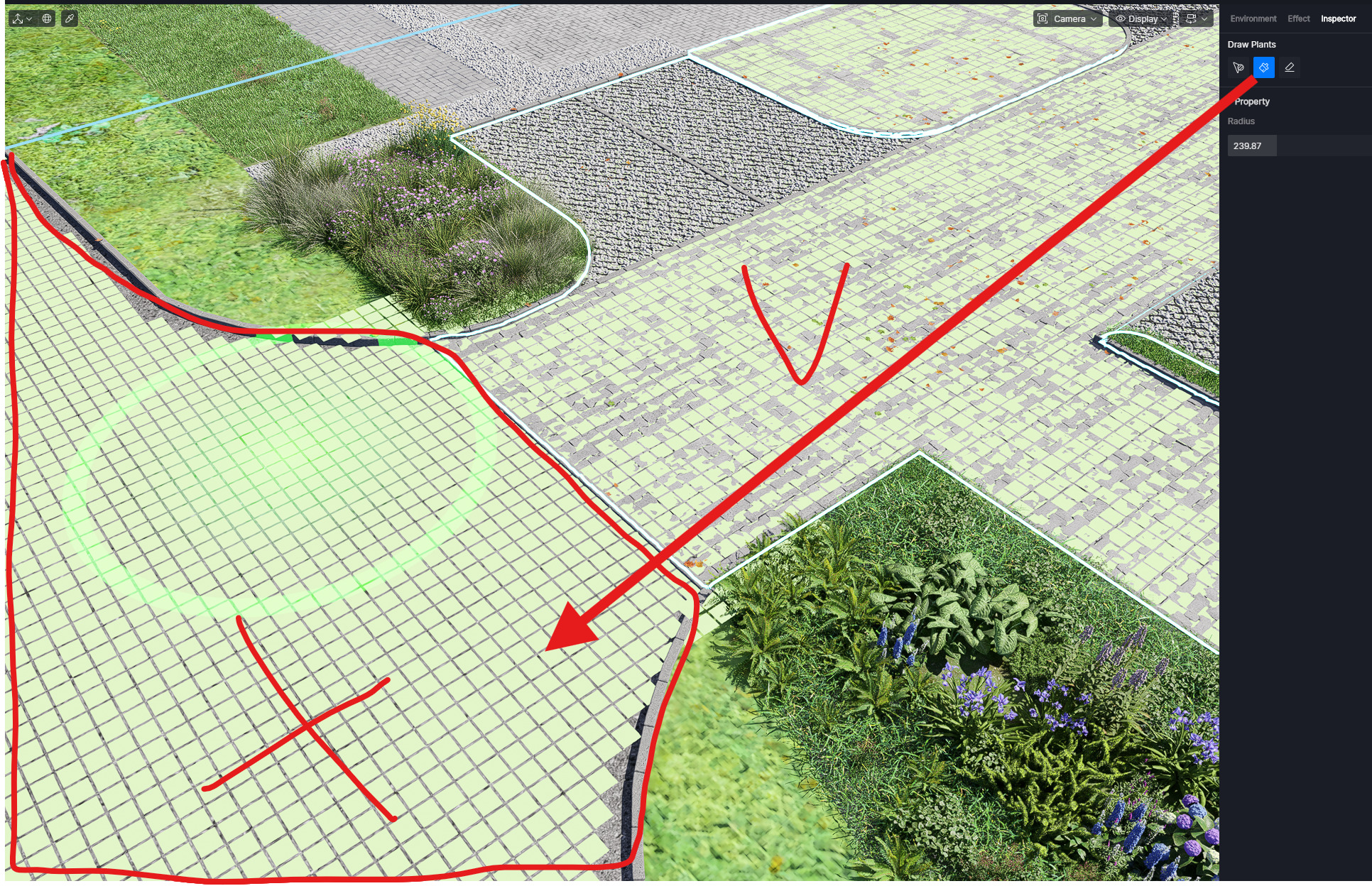

Advanced brush doesn’t work inside Scatter if we paint outside main Scatter material area :
It doesn’t create object instances here.

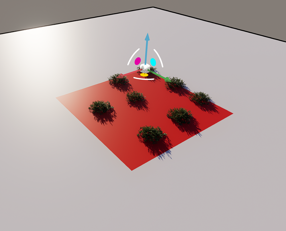

Plants doesn’t grow outside red area painted by advanced brush

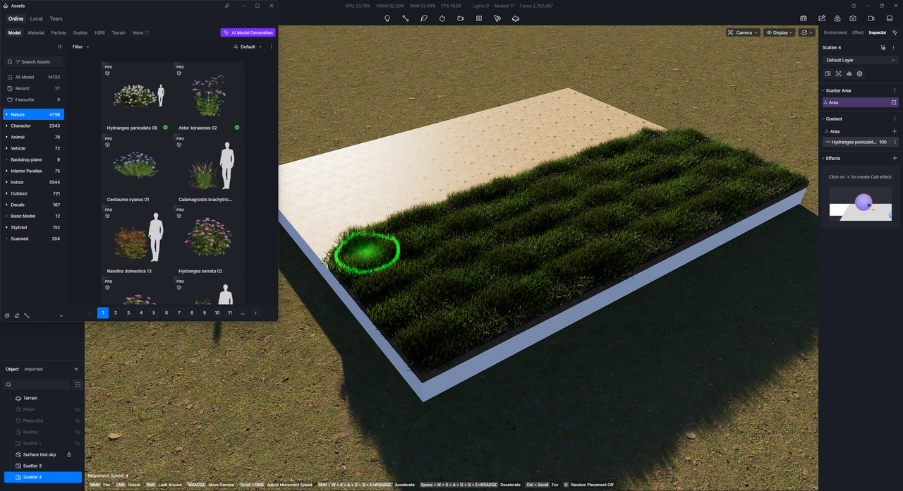

Tested your file and redid the advanced brush with the same assets, and I have even tried creating a new advanced brush with another asset.
I tried creating a similar surface with a different material in the middle, using the same setup you showed.
Vegetation generated outside the first surface, where the advanced brush tool is used, still generates normally. This applies to both the file you provided and the new one I created for testing.

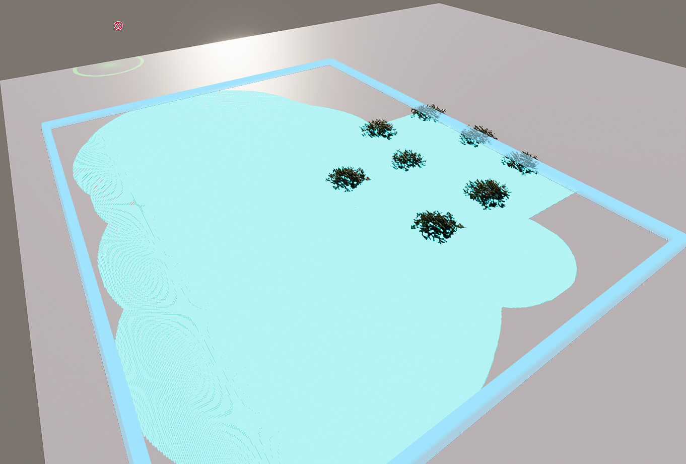

Hi @Clov it works for you because you started to paint using advanced brush. Please set Scatter for red material first after that update Scatter area by paint outside red area using Advanced Brush - plants doesn’t grow here.

It looks like these two Scatter modes doesn’t work together. While you have set Scatter for material area adding Advanced Brush doesn’t work outside this material area.
