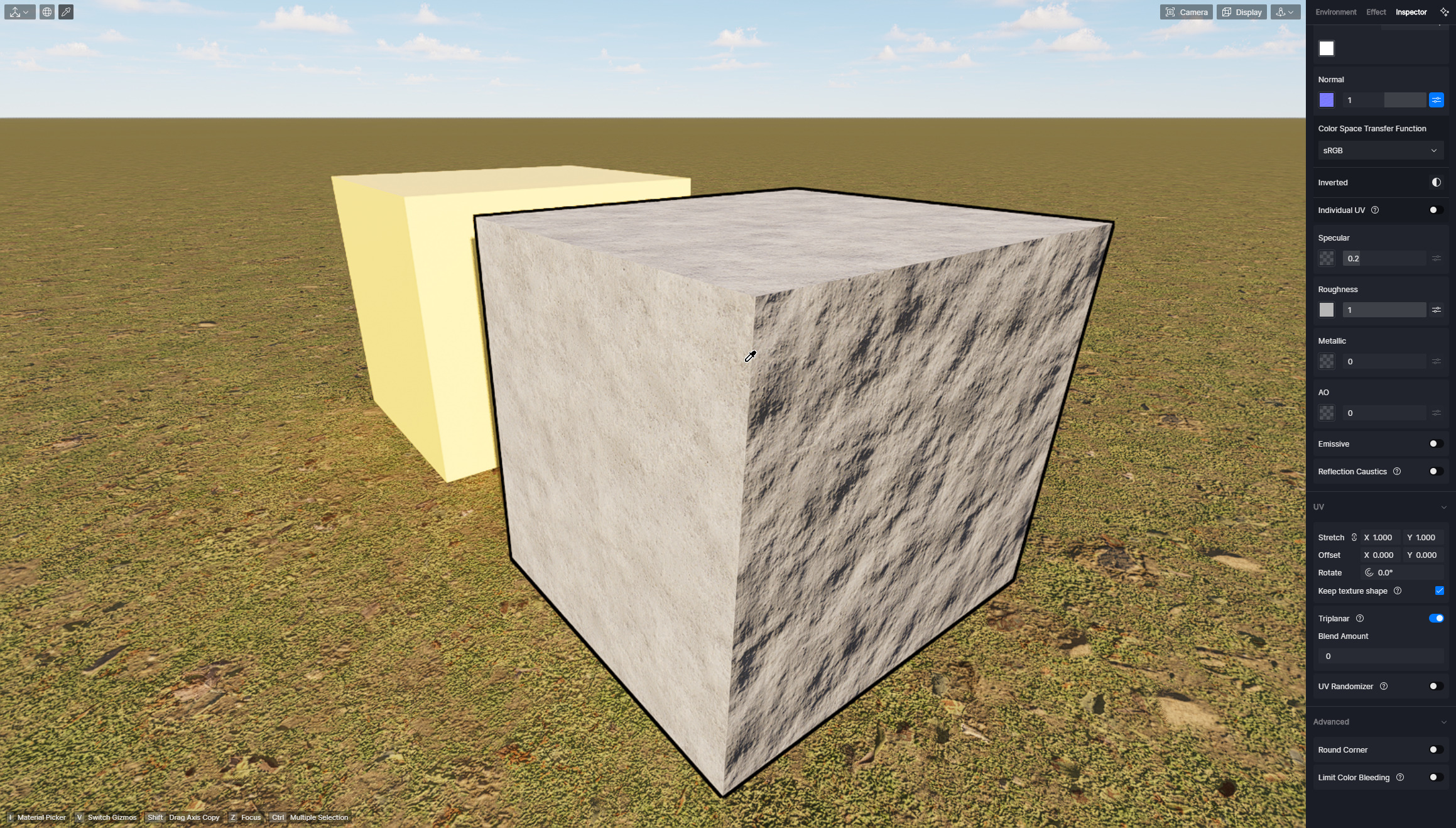

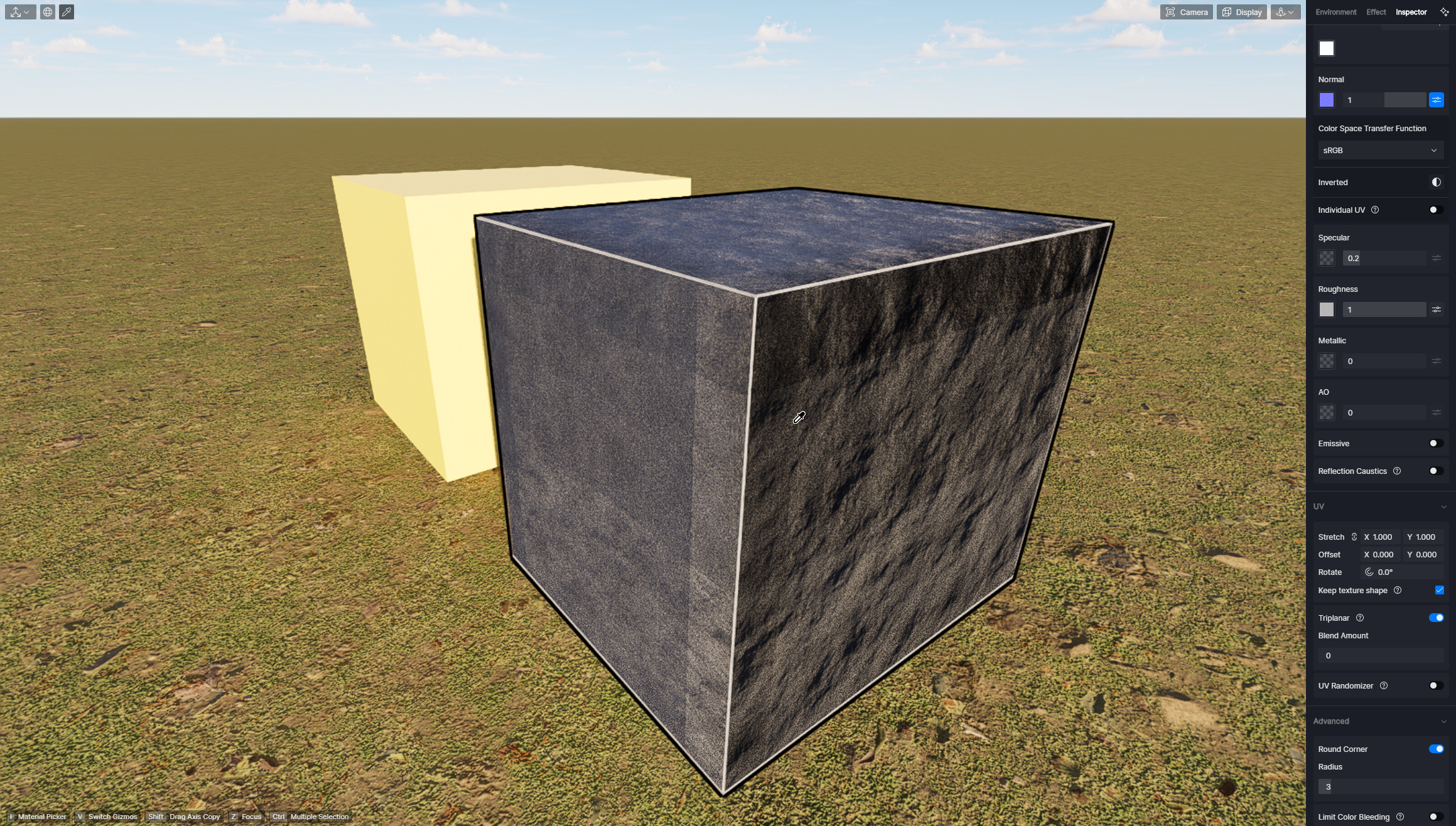

Issue Description: when I ‘‘activate’’ the ROUND CORNER option, the texture become dark, grainy and weird. The problem is persistant on every files and every types of materials. My computer+graphic card are brand new. The drivers are up to date. I’ve tried MANY things but nothing work… any help? is this a 5070Ti problem? Thanks! (french Canadian here, sorry for my bad engrish)
Hi @maxime
I apologize for the inconvenience. Please check the pinned forum post about this problem. This issue is caused by the NVIDIA Graphics Card Driver 576.02 and beyond. We recommend reverting back to the version before 576.02.
