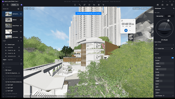

Issue Description: Loading time in 2.7 ver 49mins to load/open this file @500million faces.
is there any way we can make it similar or close to the 2.6 ver.? wherein the loading and opening time is really really shorter than this…
