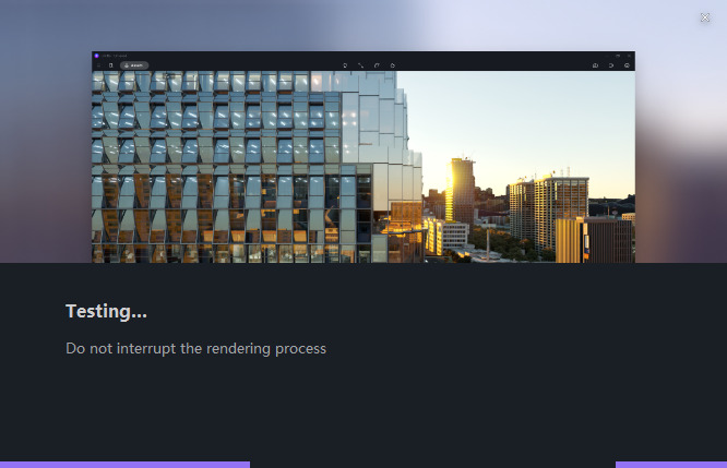

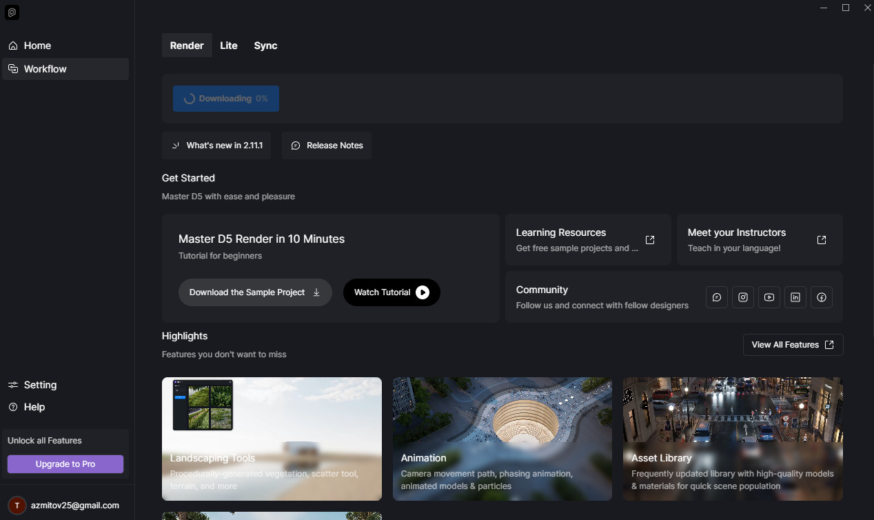

after finishing downloading D5, it’s stuck at this screen. It’s not installing.
After force quit and rebooting, it installed. However, it isn’t still working.
The launcher shows it as installed, but the test won’t run, saying D5 Render isn’t installed.

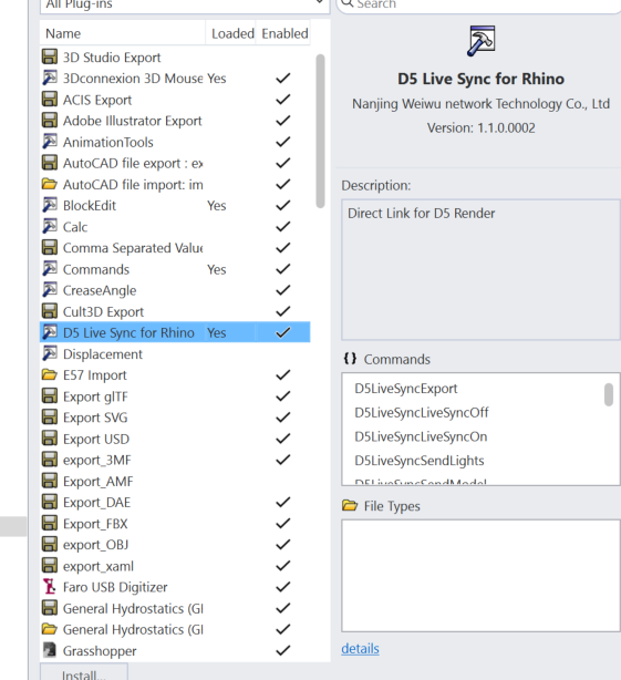

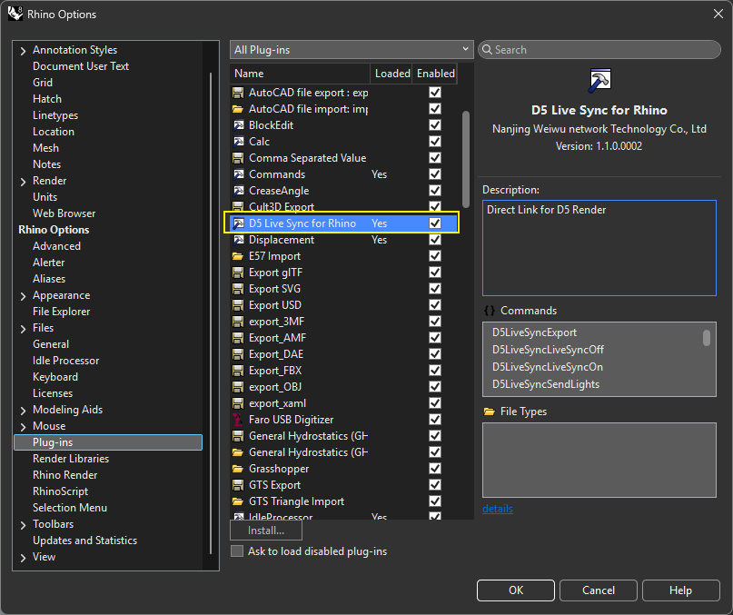

Rhino Live sync is installed, but it won’t open in Rhino
D5Sync is unknown command, and there’s no D5 plugin in the plugin list.
The livesync still doesn’t work, but opening a d5 separately worked without syncing - obviously this shouldn’t be that way.

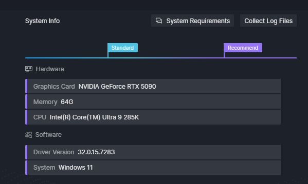

  1. Benchmark Tool - Tested with a newly installed benchmark tool from the official website, it acknowledges the the application normally.

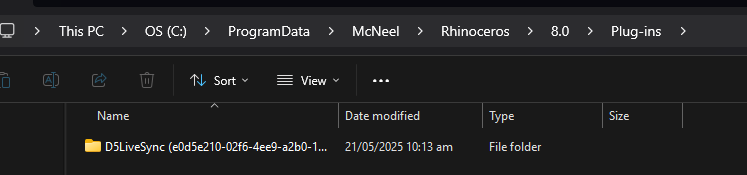

  • Check if the plug-in folder exists in this typical file address: C:\ProgramData\McNeel\Rhinoceros\8.0\Plug-ins , If it has the D5 Livesync folder, try to delete it then reinstall

Your suggestion on LiveSync is what I found on the forum already, and it didn’t work. I finally solved the issue by installing LiveSync “only for me” not “for everyone” even though D5 recommends installing “for everyone.”
Benchmark didn’t work with 2.11 even though D5 render opened. The benchmark tool only worked after uninstalling 2.11 and reinstalling 2.10.

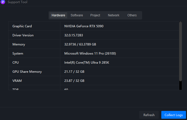

Here’s screenshots from 2.10. Log file is attached.

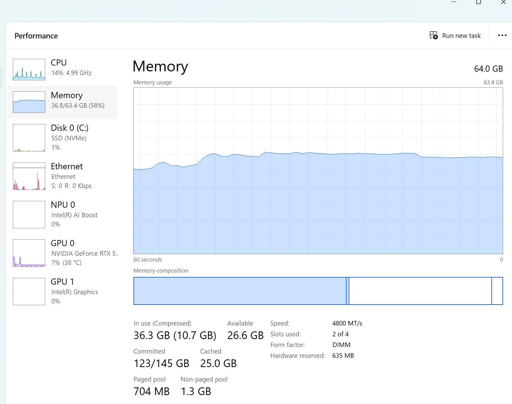

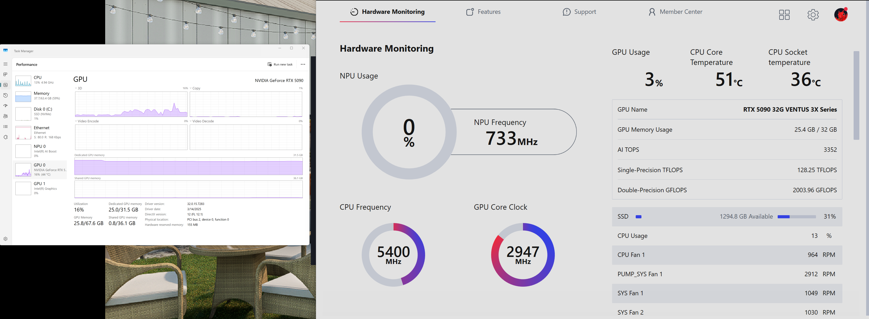

Here’s task bar and MSI Center hardware view while rendering in 2.10.
Strangely, it doesn’t seem to utilize the GPU? I wonder if there’s a way to make it use it more so that it renders faster. In MSI Center, it’s set as Extreme Performance.

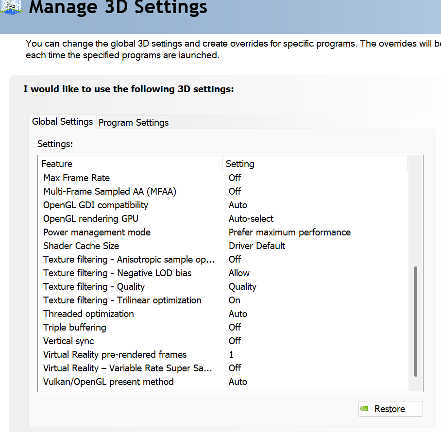

Nvidia setting is also set as maximum performance and Vsync is turned off.

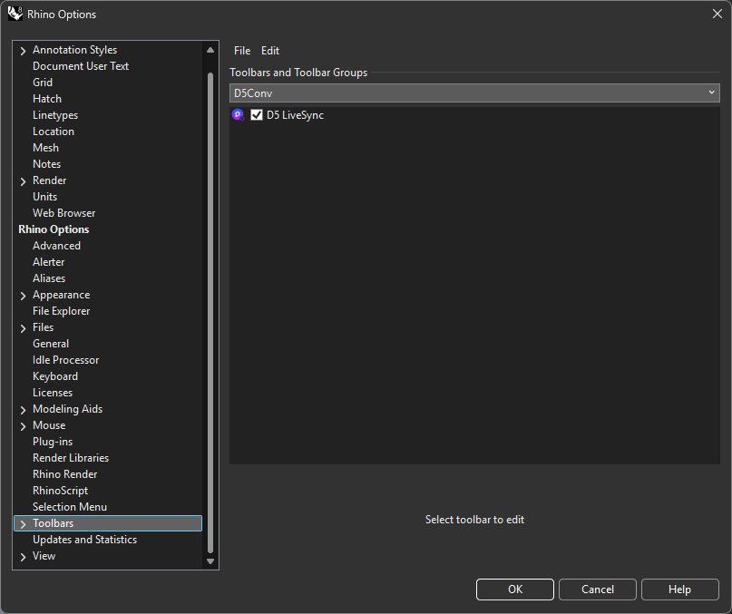

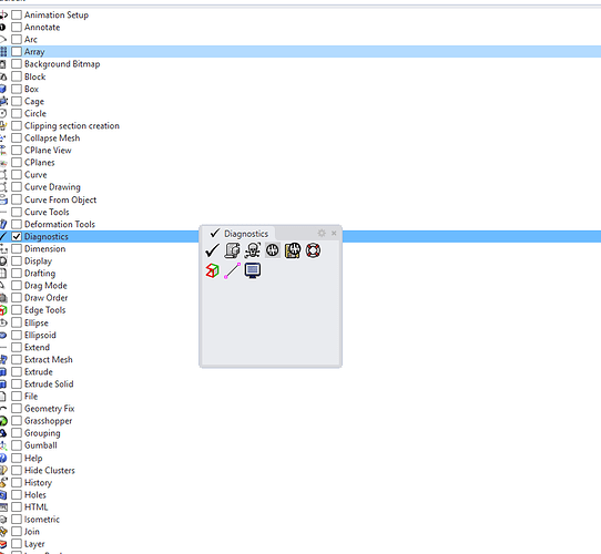

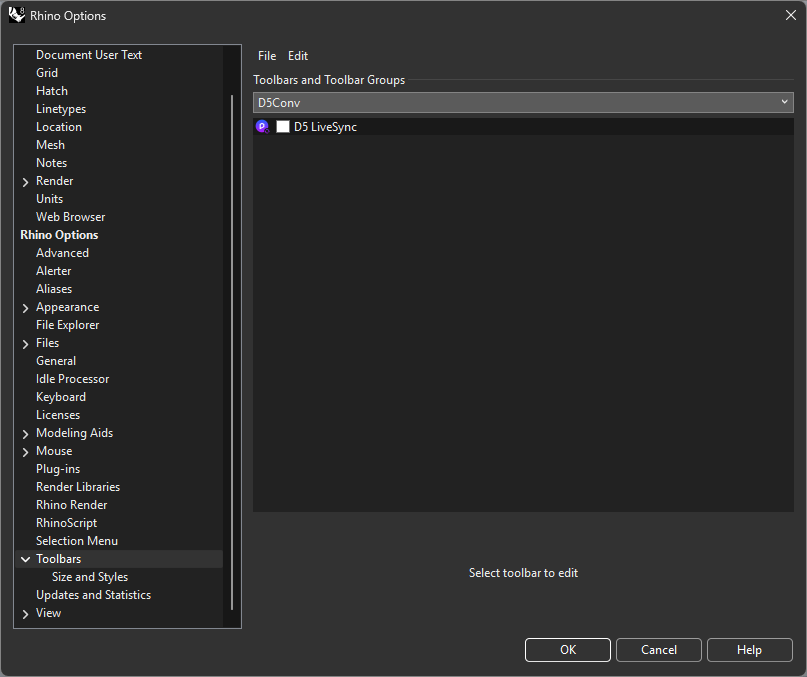

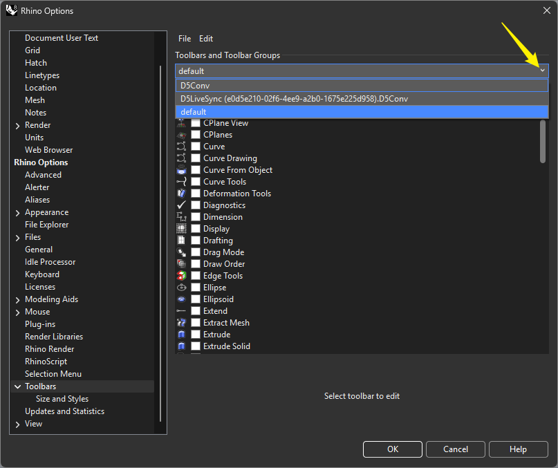

By the way, even though I got LiveSync working by installing “only for me,” tool bar is missing.
I can use it, and it shows up in Plugin list. However, it’s missing in Tool Bar list.

Regarding, plugin / toolbar:
The post above, I attached screenshots of both Plugin and Toolbar.
Below Plugin screenshot showing D5, the Toolbar screenshot shows D5 missing in the list.
Plug in is not missing. As I said, I can use the livesync with a command. It’s just that, the toolbar is missing.
