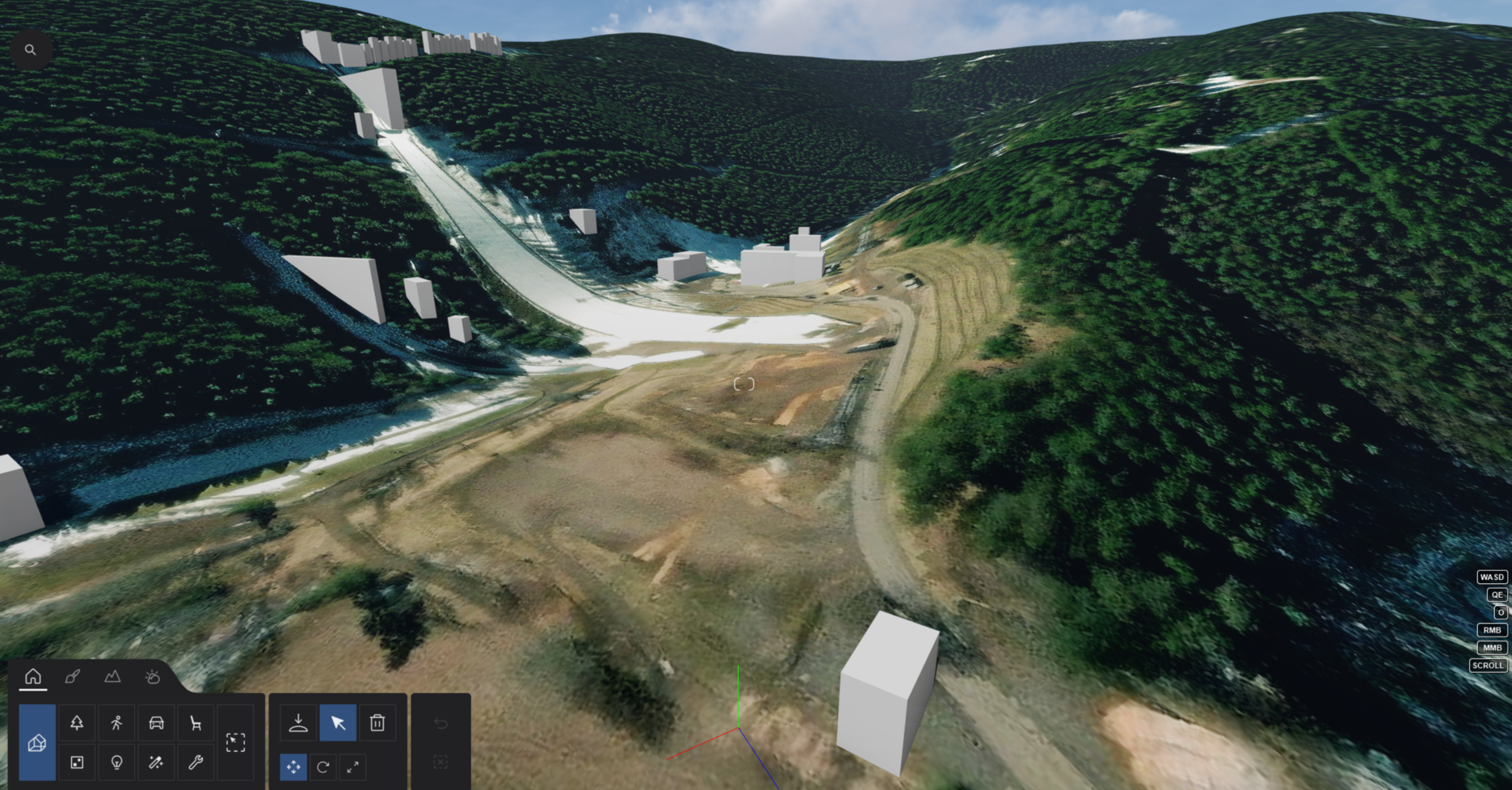

I have a Project, in which I want to show the surrounding landscape. Like in the Screenshots: The Screenshot of the final Rendering I did with Lumion and the Terrain outside the Building came from OSM automatically with the heighmaps. The other Screenshot shows the hilly Terrain of my new Project (made in Lumion). The Bulding I´m working on will be placed in that landscape.
I noticed, that the OSM-Import inside D5 does not came with heighmaps, everything is flat. But I need that hilly terrain. So what can I do? Going back to Lumion? :upside_down_face:
I of course want work with D5, but I don´t know how to manage the hilly landscape.

Thx Clov, but I need the Sat-Image, Streets, Water, some Buildings etc…
I started this Topic, because I thought other Users have already figured out, how to prep all this stuff and use it in D5 (cause it does not come out of the box within D5).
