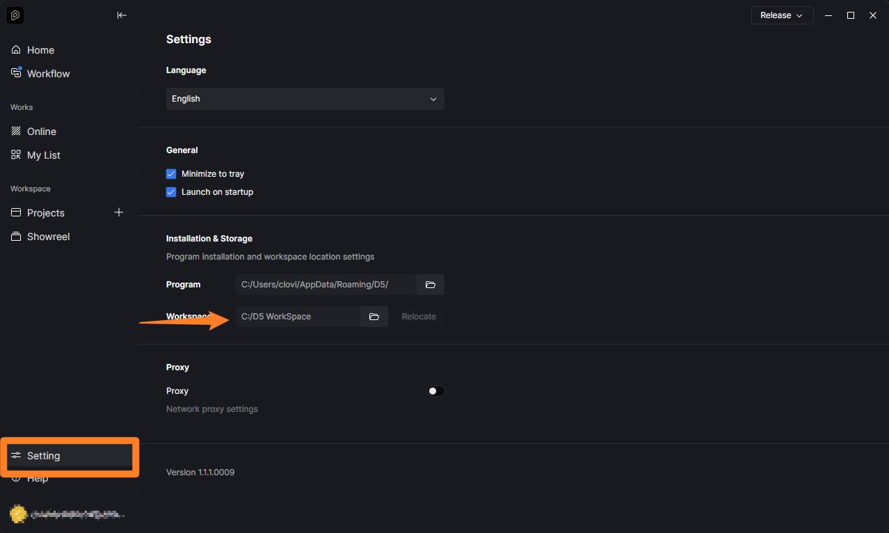

  • Did you modify your Workspace folder location? Can you send us a screenshot?
  • Please check if your Windows username or folder contains special characters. If it does, try replacing them with standard letters to see if the issue persists.

  • Workspace is default C:/D5 WorkSpace with no special characters
