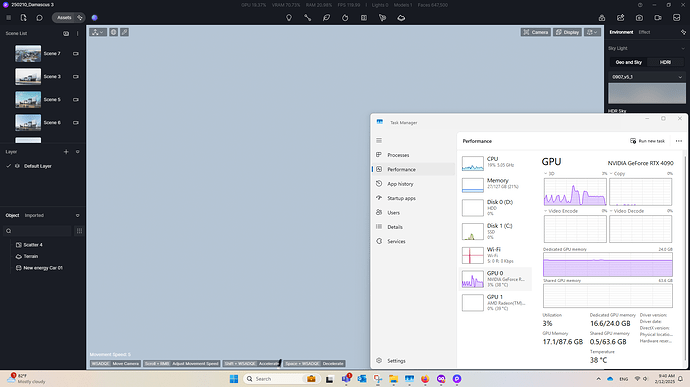

Hi @maslu. Having some what the same issue. I realized even if I deleted everything in the working file. The Vram still not automatically unload what just been deleted. So eventually everything adds up over time even if it’s not there anymore. How to counter this ??
Hi there,
I apologize for any inconvenience. Have you tried reopening your file after deleting the elements? For a more accurate number, I do recommend using GPU-Z for it.
Additionally, if you wish to lessen your VRAM Consumption, you can organize the assets by layers and enable them only in scenes where they are evident.
