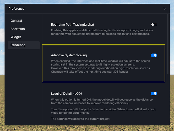

By chance, are you using a large external monitor? If so, were you able to enable “Adaptive System Scaling”?
