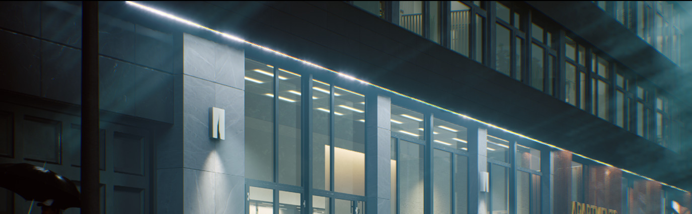

Another issue is that colored volumetric fog is way too strong compared to white one. It has much more impact and completely ignore height parameter which works more like additional strength. It is more visible on night views :
fog_col.zip (1.8 MB)
