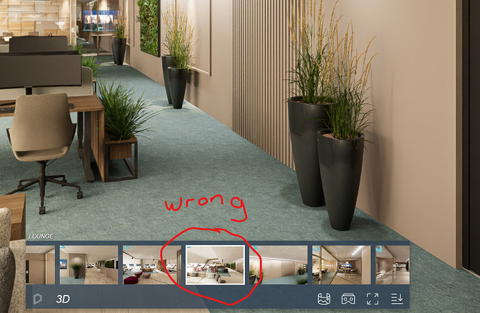

I have noticed when making a new virtual tour (over riding the old) the thumb nails are not updating. Is this a user error or a bug ?
**D5 Render Version:2.10.2.0589
**Graphics Card:3090
**Driver Version:576.52
Issue Description:

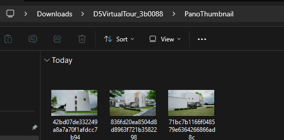

I just tested it on my end, overriding the existing Virtual Tour file. It seems that we have different results; the thumbnails are updating on my end, but the view itself did not change; it is still the same view before it was updated which is a known issue.
VT Link - Virtual Tour 1
Can you share with me the following:
  • Virtual Tour Link
  • D5 Render Version
You may also check your VT folder and check the thumbnail folder.
Pano Thumbnail
