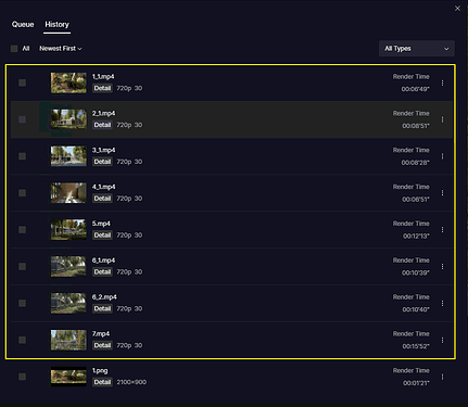

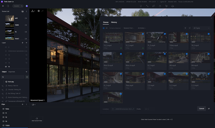

However, the most serious issue I’m facing right now is that every time I try to render video clips — even in a file that is fairly optimized and doesn’t lag much — the program freezes on the second or third clip every single time I queue multiple videos for rendering. I’m attaching an image showing how it gets stuck. (I don’t render all the videos in a single clip because when I do, character animations stop working.)

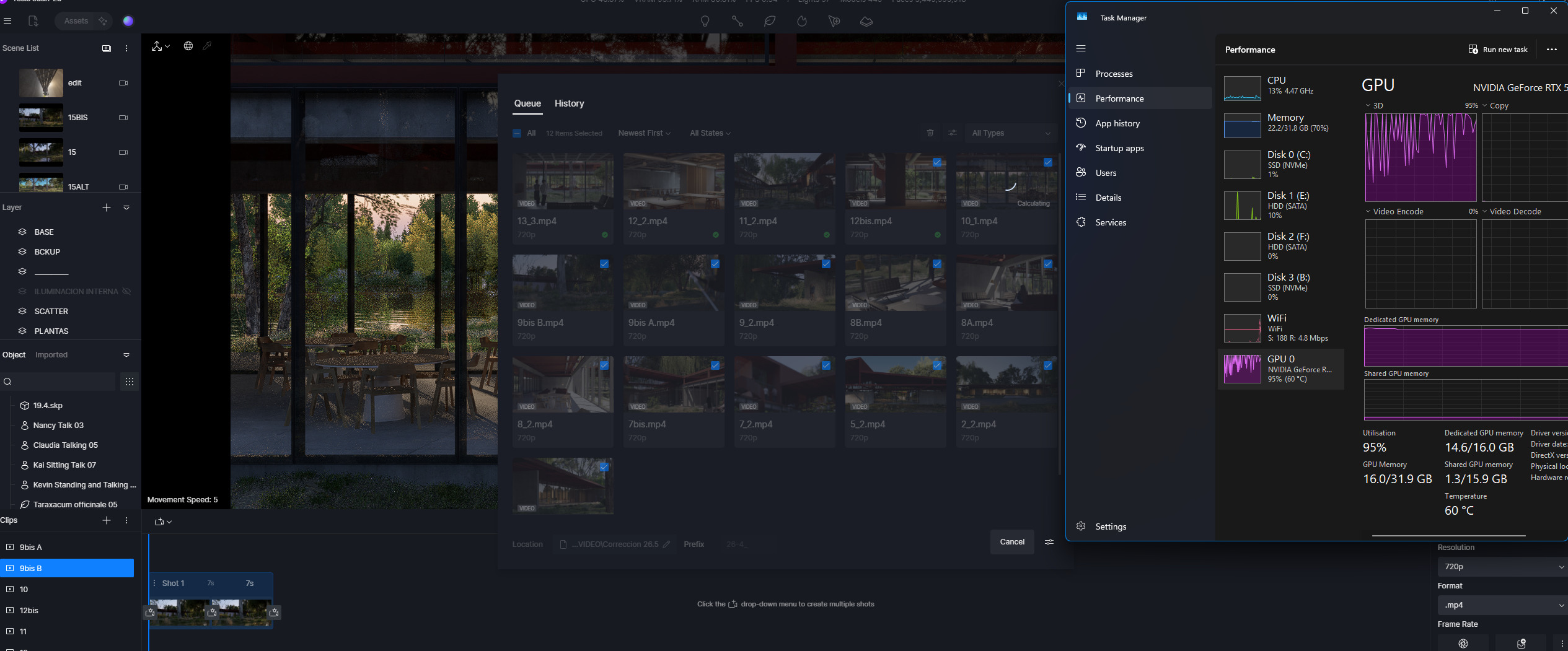

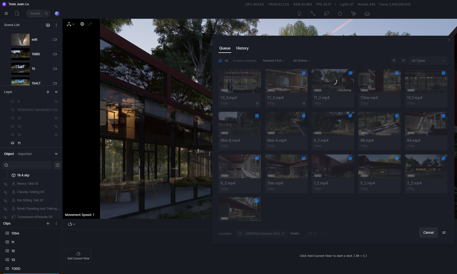

it just got stuck on the scene “10_1”. I attach this file with the task manager.
It doesn’t let me attach files, but it also generates temporary folders with the videos that were left halfway through. If I manage to open them, it’s clear that they’re corrupted — the video looks crashed or glitched, everything shakes. In some cases, I can’t even open the video at all.

I just sent the email with one of the files attached — the one that’s giving me the most trouble. Even though I optimized it and reduced the poly count by over 50%, it’s still very laggy, and it’s the file that causes the most issues when navigating between scenes. What usually happens is that when I switch scenes, the program crashes — the screen goes black and then the application closes.
This also happens frequently when I regenerate scatter elements. Every time I open the file, I have to regenerate the scatters because they don’t appear otherwise — this happens consistently with the file I just sent. Often, when I try to regenerate them, the program crashes immediately.
In both files — this one and the other — I’m also experiencing one of the most critical issues: when I queue multiple video clips for rendering, the program freezes after finishing the first one and stops rendering the rest. When this happens, the program still generates the video that was rendering at the time, but it comes out very choppy and seems to have compression or rendering issues — like something went wrong during export.

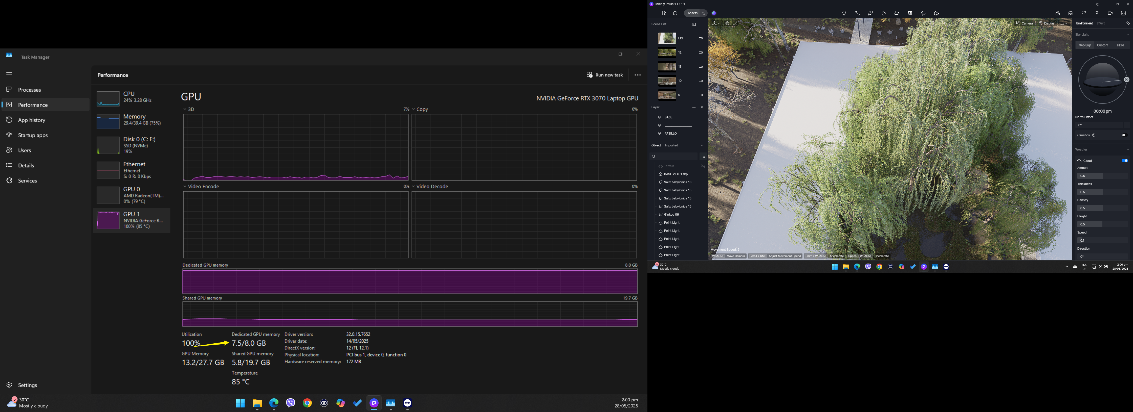

I just tested your file with two devices.
  1. Device 1 - RTX 3070 Laptop 8GB VRAM
Just to check if there is something technically wrong with your file (e.g. bug, glitch, etc.), so opening it on a less powerful device would confirm it, if it renders and moves smoothly, then it might be caused by some underlying issue. But upon testing, it is behaving as expected, since it is a less powerful device with 8GB VRAM only, it is very laggy and video render is very slow.
Although I was able to check your scenes and the surrounding environment, I think disabling “Scene Transition” helped a lot.

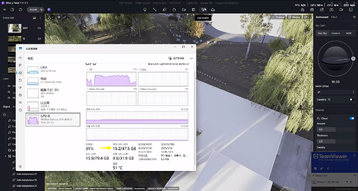

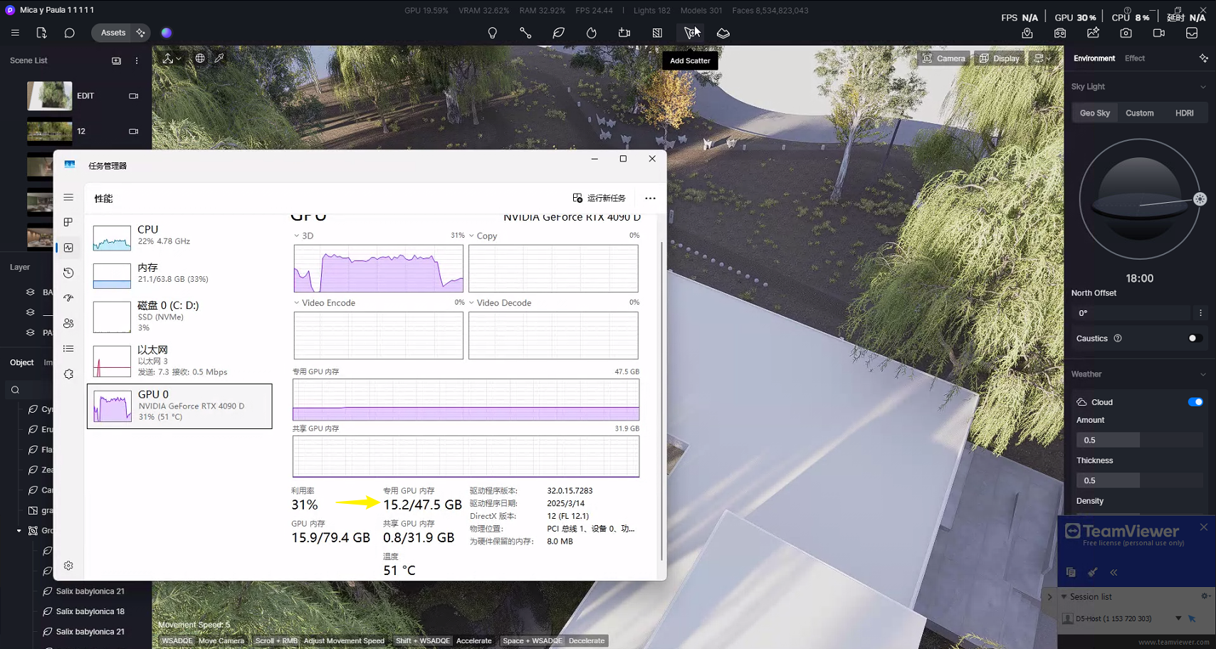

  1. Device 2 - RTX 4090 with 47.5 GB VRAM
Fairy smooth and is functioning normally despite being a large file with a lot of high-definition tree Assets. After updating the assets, VRAM has spiked to 15.2 GB, which is an indicator that the crashing is occurring due to the amount of vegetation assets.

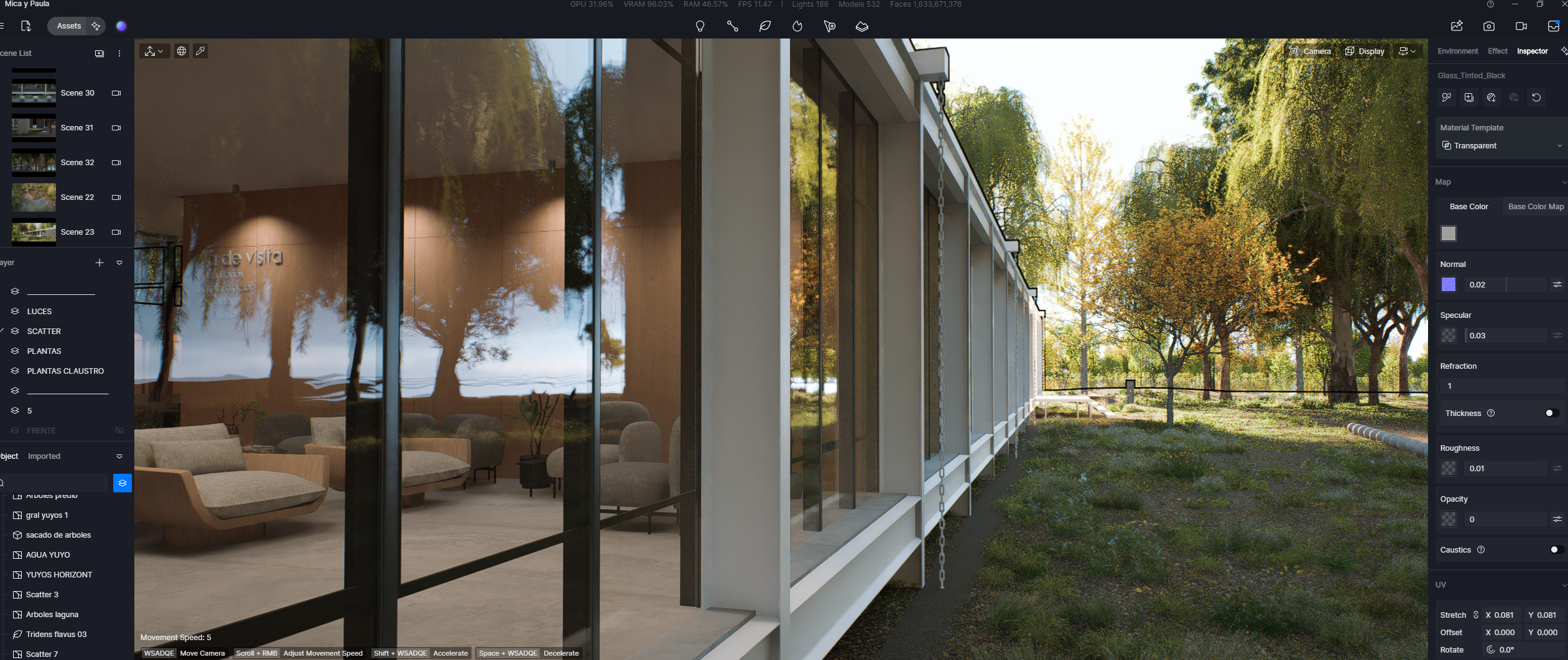

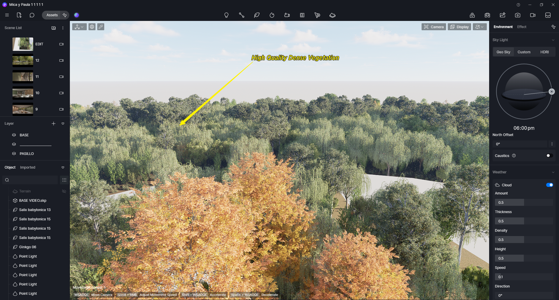

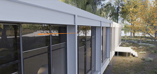

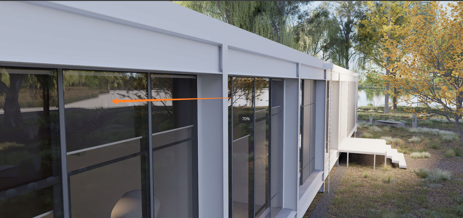

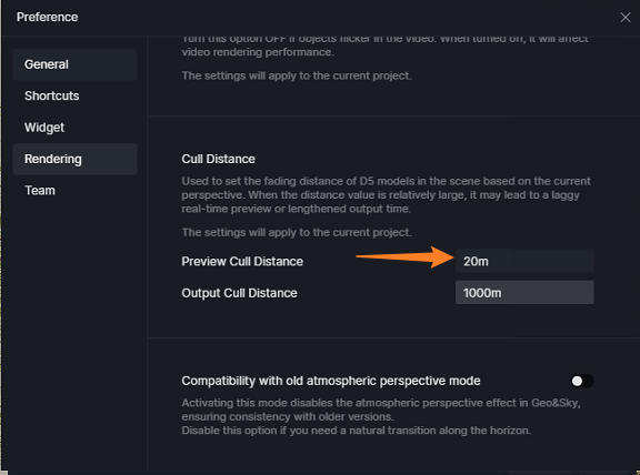

On another note (as I already mentioned in a DM), I’m still having an issue with reflections. I’ve attached a screenshot showing it clearly — the reflection doesn’t appear in the preview, nor in the final render. Just to clarify, both preview and render distances are set to maximum.
Hi @render.opera

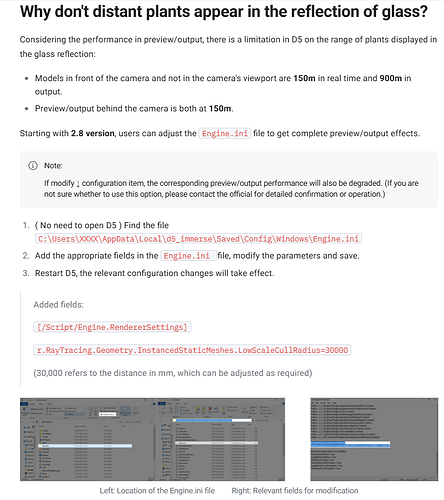

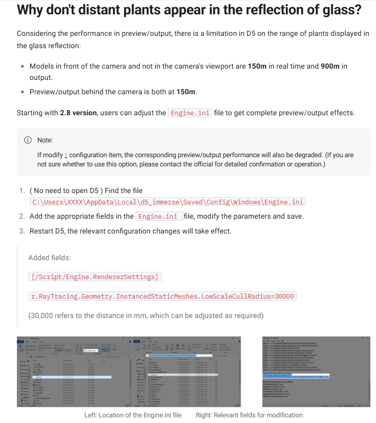

Regarding your concern about the glass reflection, please check this link: Why is the effect of the glass material not obvious/anomalous? | User Manual
  • We have provided the reason as to why it is happening and how you can solve it, Please note that modifying the limit mentioned in the link will surely increase your GPU/VRAM usage, considering that your file is full of HD and Dynamic Vegetation.
Thanks for the link! I had already checked that thread, and I understand how to get distant vegetation to show up in reflections. However, in my case, it’s not just the vegetation that’s missing — the water surface itself isn’t being reflected either. So I think the issue might go beyond the usual distant vegetation reflection setting.
Hi @render.opera
Have you tried the solution? It might include the water surface, please try.

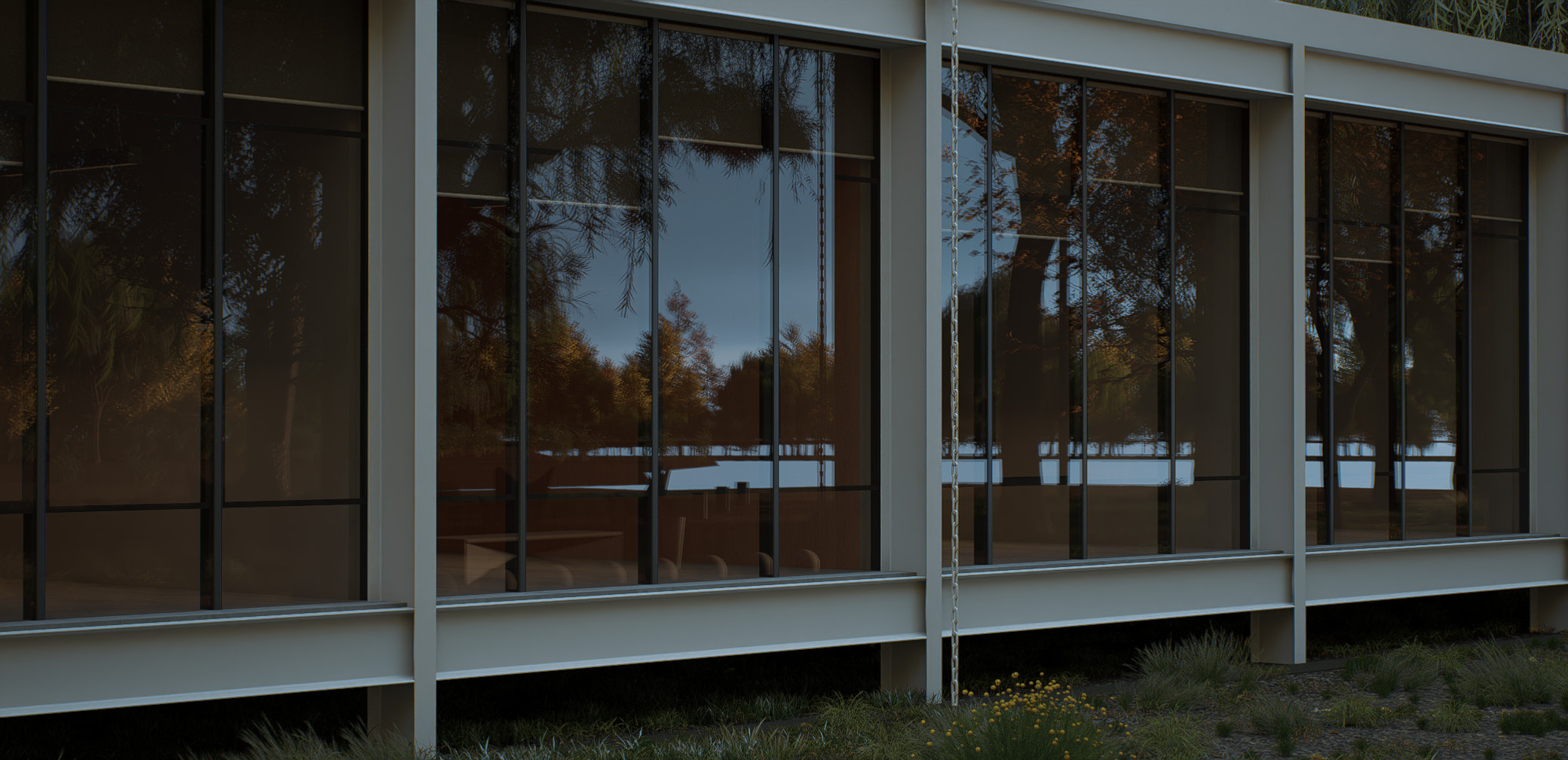

I ran the test, and yes — enabling that setting does fix the reflection of the trees, though it comes with a noticeable drop in performance. It might still be useful for a specific shot. However, the water still doesn’t get reflected, so unfortunately it’s not a viable solution in my case. Thanks a lot for the suggestion anyway — for now, I think I’ll just have to leave that shot out.
Hi @render.opera

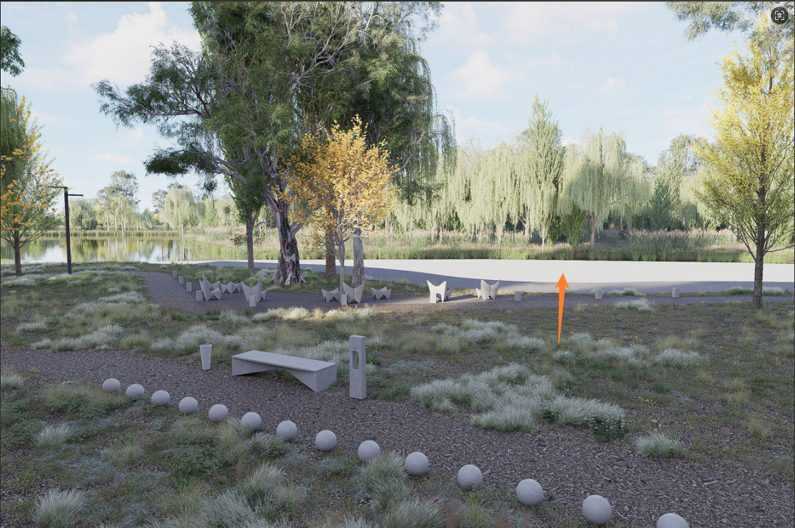

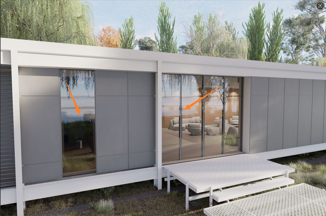

I just tested your file and tried to replicate the same view with the image that you have provided.
