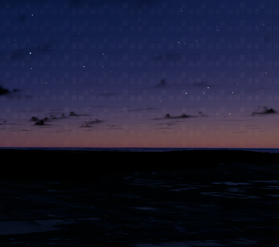

Issue Description: Hello, I have a trouble with this video export, when I have the transition of the athmosphere from afternoon to the night the video shows this squares pixelated in the final file.
The export file is 4k 60fps, transition scenes with auto exposure from the evening to the night

I just tested your file, and this is currently a known issue due to enabling Super Resolution. When super-resolution sampling is turned on and video above 2k output, pixel blocks will appear; 720/1080P does not have this issue, and it will be normal after disabling Super Resolution.
