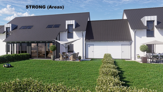

Hello everyone,
in this picture I have only calculated some areas with Strong, hedge, lawn and sky.
Is it possible to calculate different areas differently?
I like the grass with Strong, the hedge with Normal.

I have calculated another image with areas.
This solves most of the problems mentioned above.
Another thing I noticed is that too much reflection creates areas that are too bright on plants (see image Strong), as can be seen on the hedge and the bush on the left in the background.

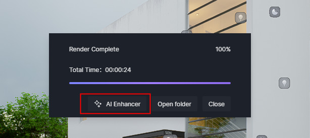

  1. Render the image and tick AI Enhancer in the channel options.
  2. Finish rendering and click on the AI Enhancer button to access its panel.
    3ddafdc2f772701011e444ad4f941821
  1. You can also click on the AI Enhancer button directly from the preview screen to access its panel, and then select previously rendered images for enhancement from the render history list on the left (these images must have the AI Enhancer channel ticked at the time of rendering).
