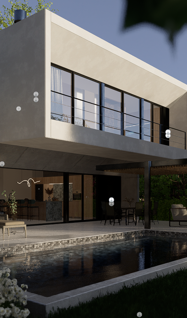

Issue Description: When I render an animation video, some plants disappear from the scene

Hi mate, are these plants placed by brush? did you use smooth mode before rendering it? If it is, it’s a bug, we are fixing it.
If not, Can you show me the preview or the final output? also please tell me the name of the missing vegetation, and we will help you troubleshoot it.
Hi! Here I upload the preview of the video.
I used smooth mode before rendering for better performance and the missing vegetation is Rosa Hybrida 2.
Thanks you for your fast answer.
When I render in precise mode it works well ![]()
It’s a bug when you use the smooth mode before rendering, we are fixing it, sorry for the inconvenience, it will be fixed asap.
