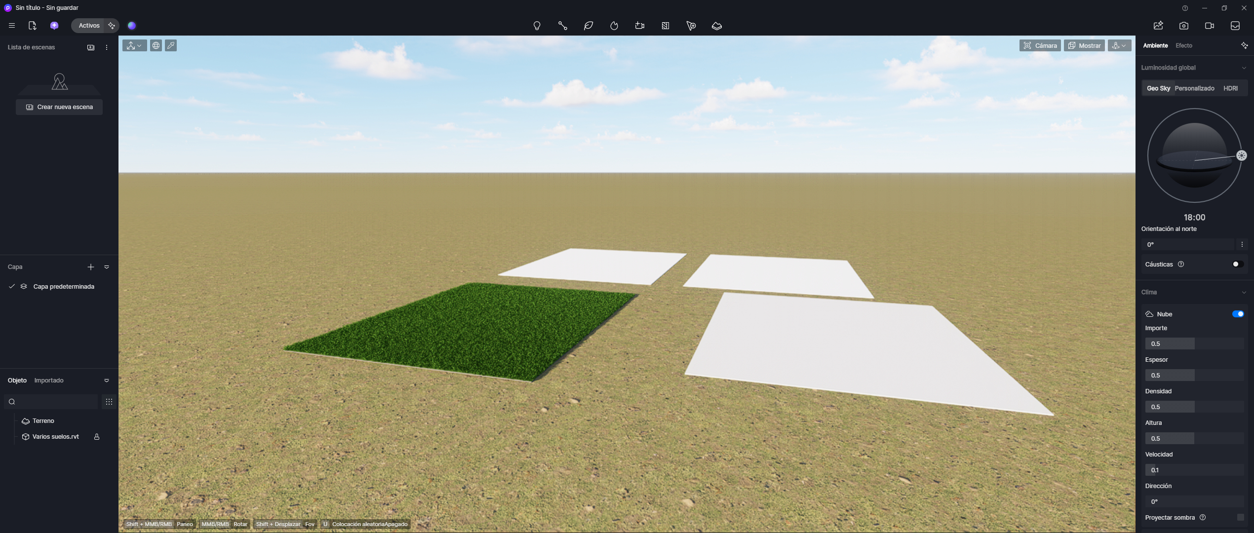

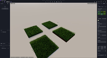

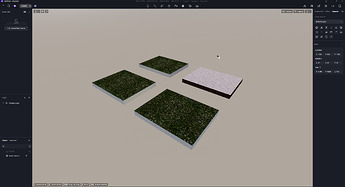

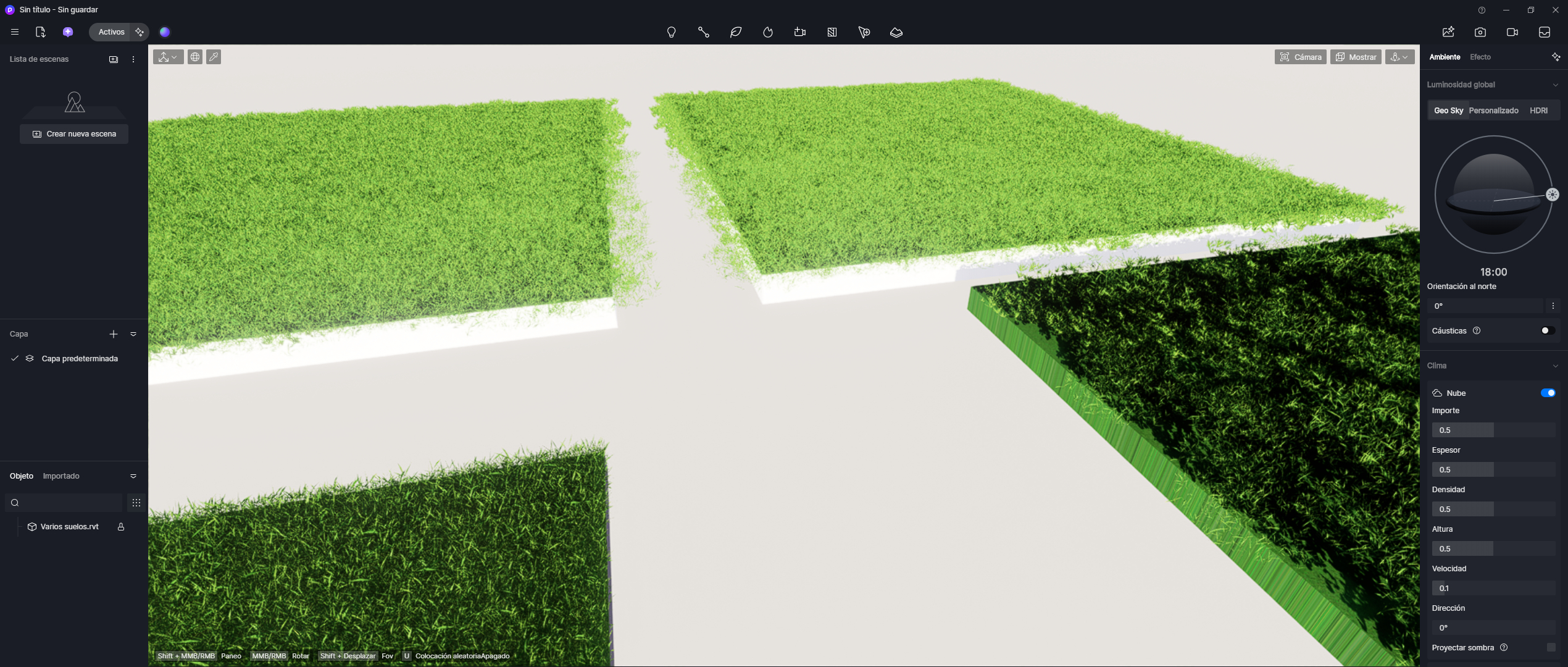

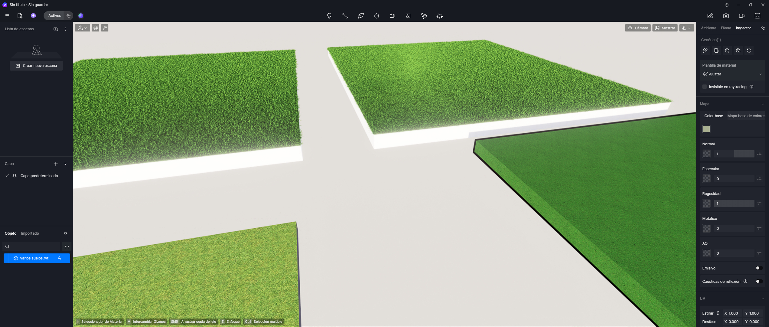

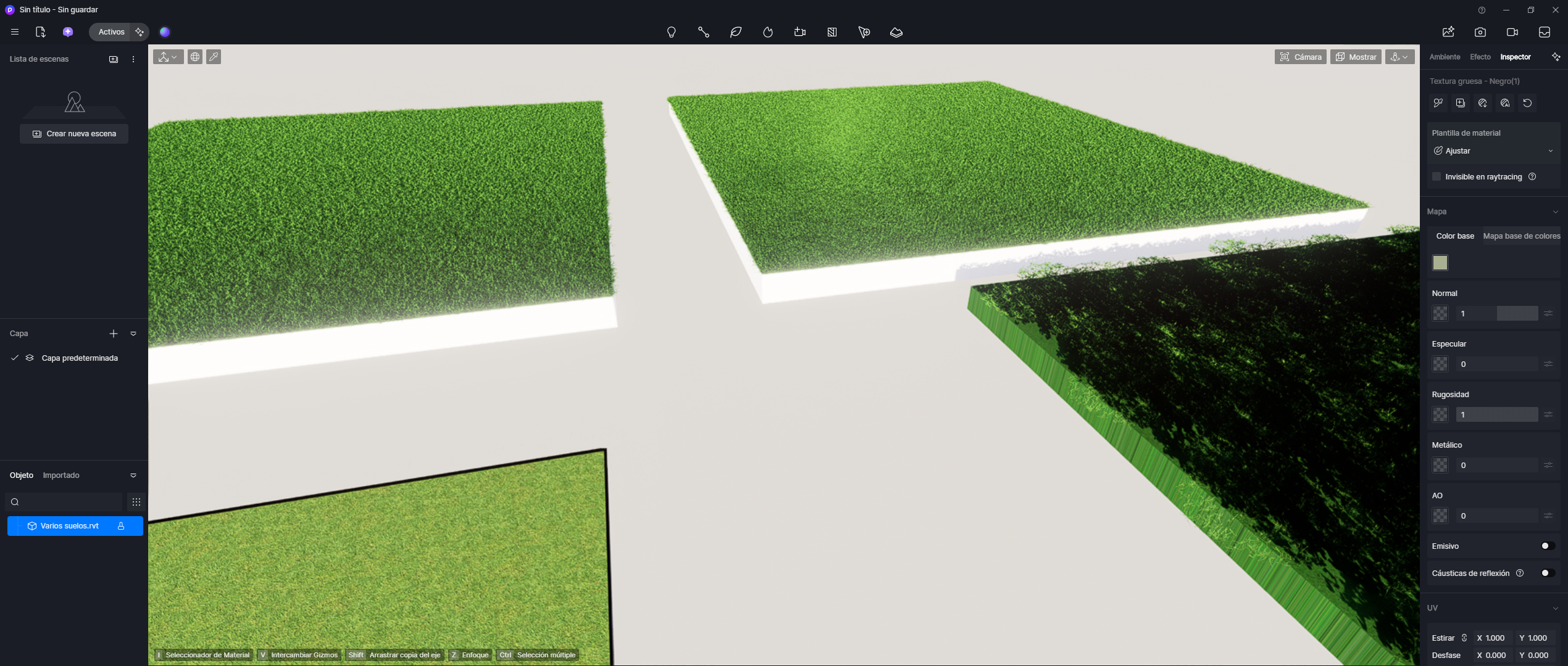

Using the grass material causes anomalies starting with the second surface to which it is applied
D5 Render Version: 2.11
Graphics Card: AMD Radeon RX 7800 XT
Driver Version: 32.0.21025.15001
Issue Description: Material Grass Error
When I apply the grass material to a Revit model, anomalies occur starting with the second surface, where another material is also applied to the grass. The material is applied outside of the surface on the other surfaces. This happens after applying the grass material to two different materials. Removing one of the grass applications corrects the problem.
The same thing always happens when applying the grass material to more than one material in the original model; the materials start failing to apply correctly to the surface.
If only one material is used, the problem disappears and the material is applied correctly. It doesn’t matter what order the material was applied or if it was changed to a different material. If it remains on only one surface, the problem disappears.

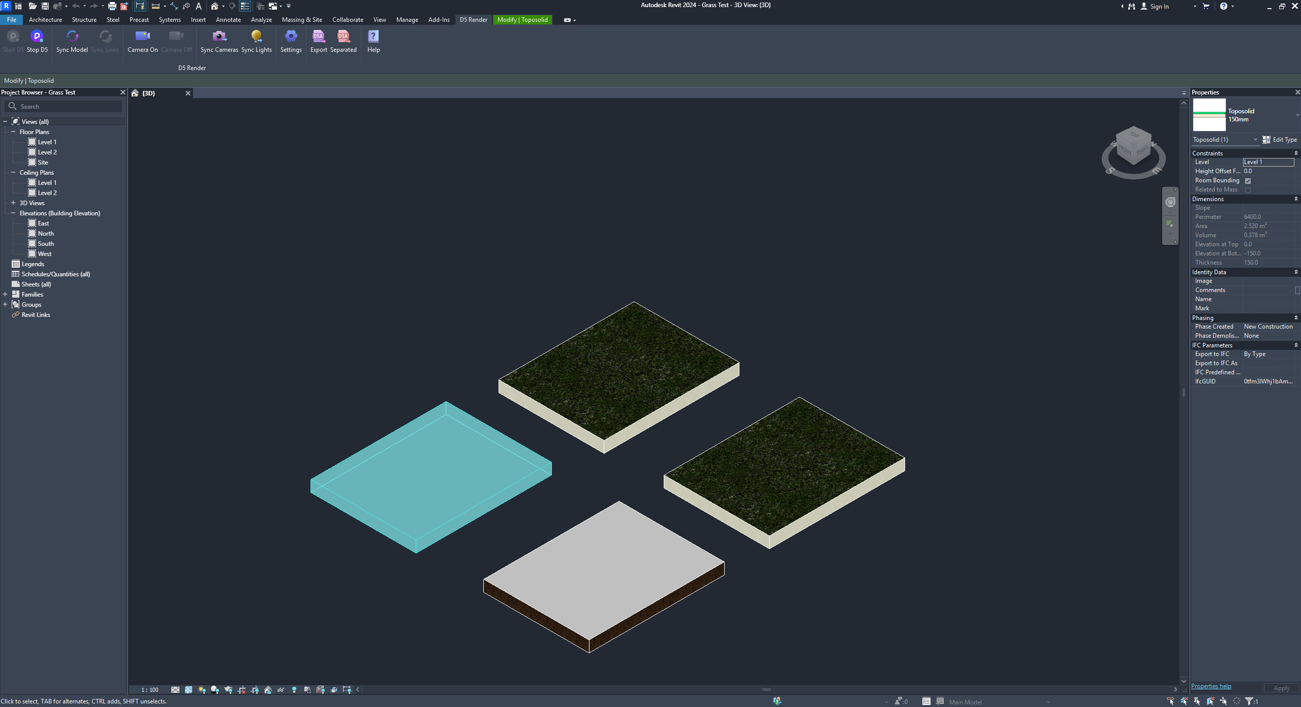

Hi @germanvallverdu
I’m trying to replicate this issue on my end just by following the description and images you have shared.
I don’t think i have replicated the issue. Is there something I have missed on the material assignment in Revit? Or perhaps you can send me the Revit Model that you have used for this one.
Additionally, I am using:
  • Revit 2024
  • Latest Plug-in Version
  • D5 Render 2.11.1.0620
Hi Clov, I’m going to try it on a different computer and then I’ll let you know what happens. I’m using Revit 2026. I’m also using the same version of D5 Render, 2.11.1.0620, and the same version of the plugin, 0.4.8.0006.
Hi @germanvallverdu
Thanks for confirming.
It would be ideal if you could also test this behavior in lower versions of Revit in addition to the version you are currently using.
Alternatively, if possible, please share the test file you created with us. Saving the file in the Revit 2024 version would be preferable.
  • Sharing your test file will give us a consistent model setup for our internal testing, ensuring our results align precisely with the environment and configuration you are experiencing.
