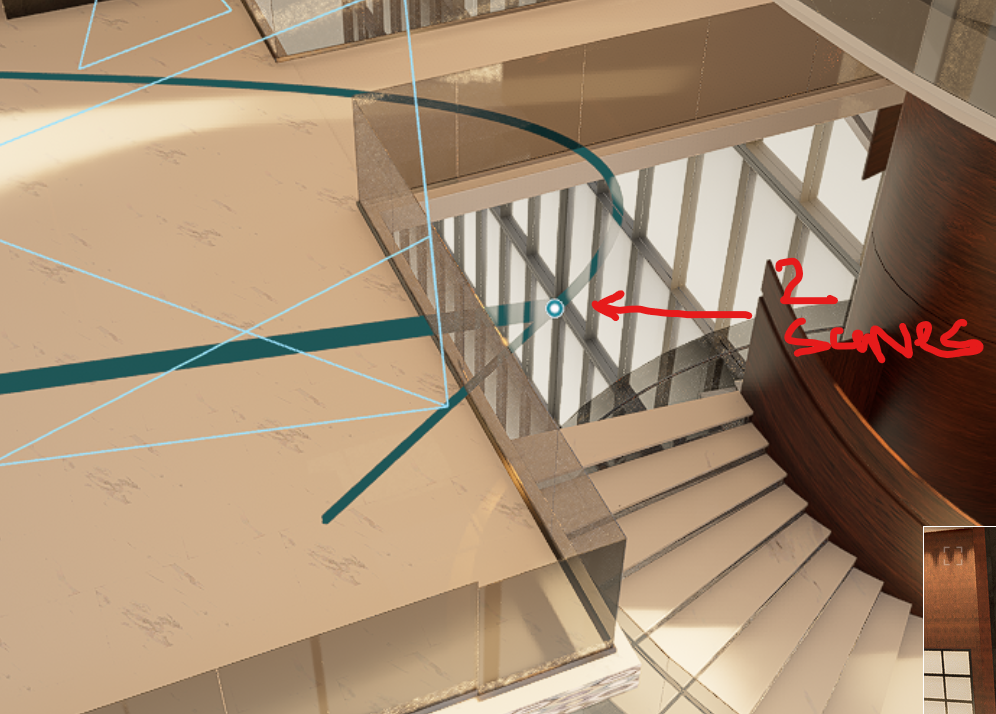

I usually create walkthrough videos using Scenes (not Cameras) to sequence the animation on the timeline. When I try to add a short pause/stop to focus on a specific view (when timeline overall completed), I run into an issue: after adding another scene to the timeline, the camera always shows an unwanted back-and-forth movement.
I suspect this is caused by how the animation path is interpolated (Bezier curves between points)
Is there a recommended way to create a clean pause or hold when adding to a completed timeline?
Or am I missing a setting or workflow to avoid this behavior?
Thanks in advance for any advice.
Screenshot 2026-01-02 093410
Hi @rlakse884
Currently, D5 doesn’t have a dedicated “pause/hold” button in the scene timeline, so the software will always create some motion between views unless the camera path is manually adjusted or planned with additional keyframes. Thanks
Thank you for reply!
Sometimes it works sometimes not
Kinda found workable a way around this issue. I separate the points a little bit from each other. Creating slow progression between points
