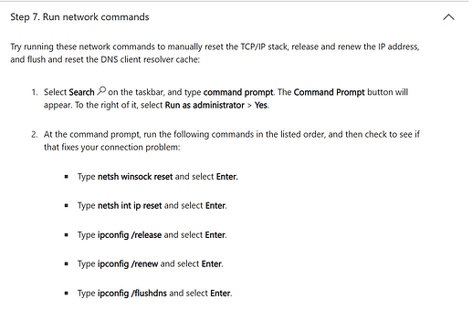

[Update]
The user discovered a solution, and has solved this issue by:
  1. Open Command Prompt as Administrator, then run:
    cmd
    CopyEdit
certutil -urlcache * delete
This clears the certificate cache used by Windows, which can get corrupted over time.
  1. Fix Wi-Fi connection issues in Windows - Microsoft Support
