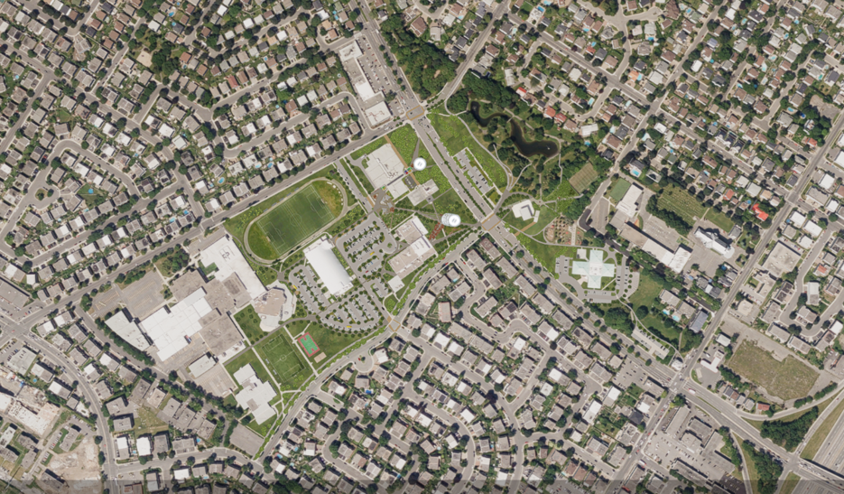

I have noticed that in global site render the brushed, low vegetaion is not rendered.
Attached-please-fin the size of the view to be rendered.
Please advise, if possible - ASAP
PS I have tried to render it 16k to be zommed easily, alas no items (the vegetation, ornamental grasses) to show.

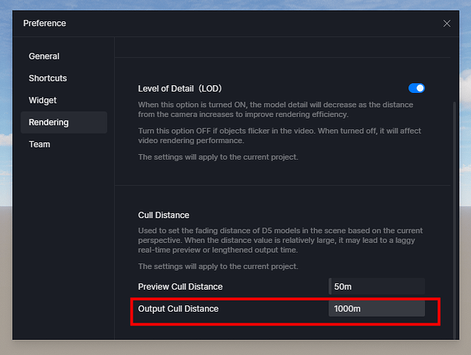

Hi! Sorry for your issue. Does this problem you have only happen in this one scene so far, or does it happen in all scenes? Could you please send us your scene file? We check it for you.
BTW, can you show me a screenshot of your cull distance? I suggest you set your output cull distance to 1000m and try to render again. If this does not solve your issue, please let me know.
Greetings,
I have chnged render distance in preferences to 6000 m and the brush vegetation, grasses are visible in render…
