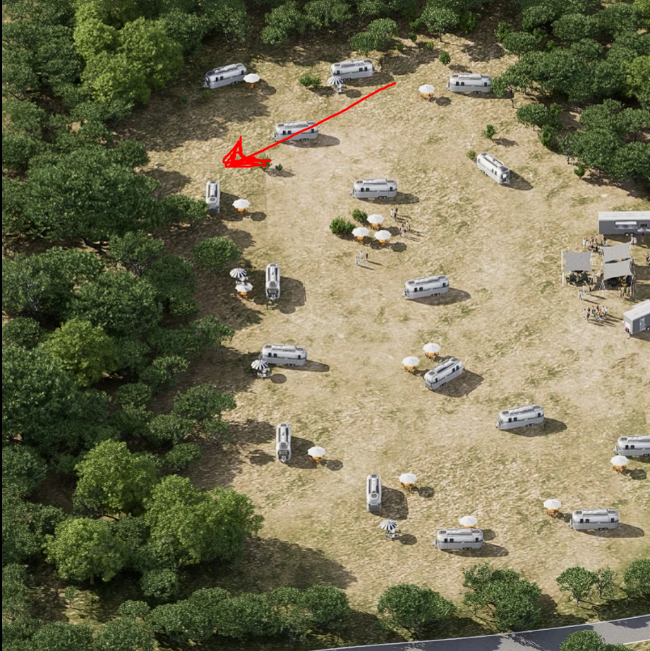

I experience this issue in every project.
Trees or shadows from trees disappear before the camera passes by them on the final renders. Trees and their shadows disappear or appear at the edges of the frame a second or two later than they should. As a result, in the final render, I can see trees or their shadows appearing or disappearing at the edges of the frame depending on the direction the camera is moving.
In this project, the camera is moving from left to right. Therefore, in the final render, I see the trees disappear on the left side of the video a few seconds before they should (i.e., before they leave the frame).
I have several videos, but unfortunately, only images can be uploaded here.

Same thing has been happening to me ! I’ve noticed tree shadows disappearing at edges
Yeah, the cull distance unfortunatelly doesn´t help this issue. I´ve increased it up to 3 km, and did not help:
The only thing I can do is rendering a slightly larger video, then crop it. It´s a bit annoying that I routinely need to re-render sequences in larger crop to solve this.
