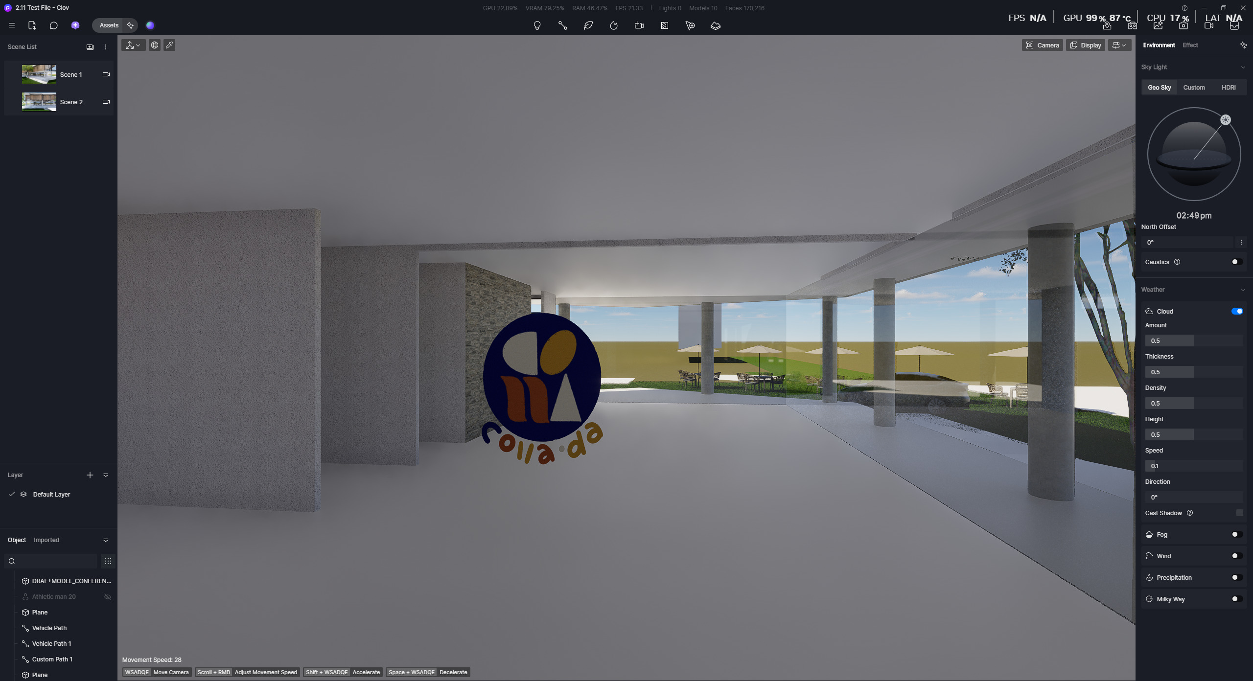

  • Aside from that, can you send us a screenshot of what it looks like on your end? I assume the Custom Alpha Mask is placed under a light source, specifically from a material where its emissivity has been activated.
  • This is how custom alpha looks on my end; the image is in PNG format.
