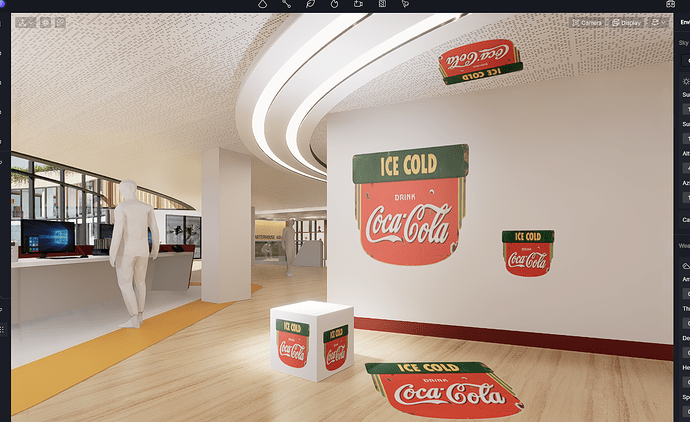

This PNG is used as custom alpha, but there’s a shadow or transparency bug. It still shows the boundary rectangle (I think shadow is catching it). I do remember this didn’t happen a couple of years ago. This must be relatively new bug that was introduced.
I think it’s a shadow bug because a little far away in a different view, the boundary rectangle looks weaker.

did you try on the vertical solid wall? It looks you just placed it on empty space. Could you try placing the PNG graphic .1" off the solid vertical wall and place some lighting to catch the shadow? D5 definitely has a bug with clear PNG and shadow. It happens every single time with all different files.
hi iso… tried your png seem’s perfect on my side…pasted on the wall with spotlight and a cube to show the shadow effect… and all is well… NO BUGS… ![]()

Hope you good today. We found out that this is because the self-emissive casting shadows causes the transparent areas of the translucent sticker material to have shadows as well, this is indeed an issue and I’ve reported it to our Team and we’re planning to optimize it. ![]()
We suggest that you can replace the self-emissive in the ceiling with an artificial light source and you won’t have a problem. ![]()
Nope, nothing to do with placement, normal, or opacity map. There’s a bug with self-illumination casting shadow on Alpha transparency as D5 team found out.
