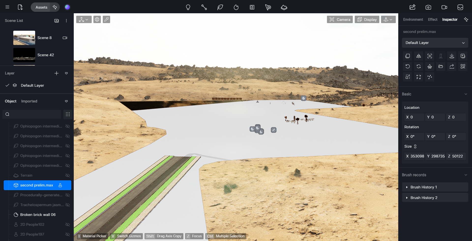

When I reload the model it disappears, even though the project name and File location are the same.

I was working on Live-sync before but there was a problem where 3ds Max and D5 render don’t work together and they close immediately, I suppose the problem related to RAM, now I doubled the RAM but the problem still exists, so I decided to close 3ds Max and keep D5 render only and reload the file, but the file disappears when I reload it, and I can’t start new project because I don’t have much time left to submit my thesis.

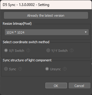

- Did you perhaps download D5 Sync instead of D5 Livesync?
- Which version of the plug-in are you using?
I think this problem stems from either the:
- live-sync version (maybe outdated)
- or the 3d model itself, since there is a crashing that occurred. If the crashing occurs also on another device, then it is most likely the problem otherwise, it’s the plug-in version.
It would be best for you to check whether you’ve downloaded the Live-sync version since this plug-in has also integrated a “sync only” only feature which is similar to D5 Sync.

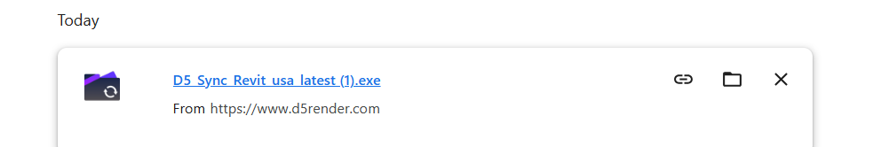

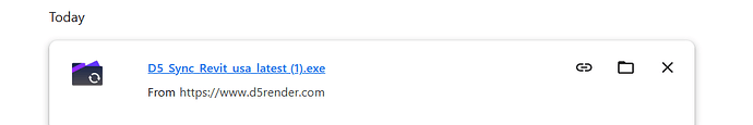

Alright, Revit only has D5 Sync for now. Can you give us more information regarding this issue? Perhaps recording a screen video on your end would provide us with more information.

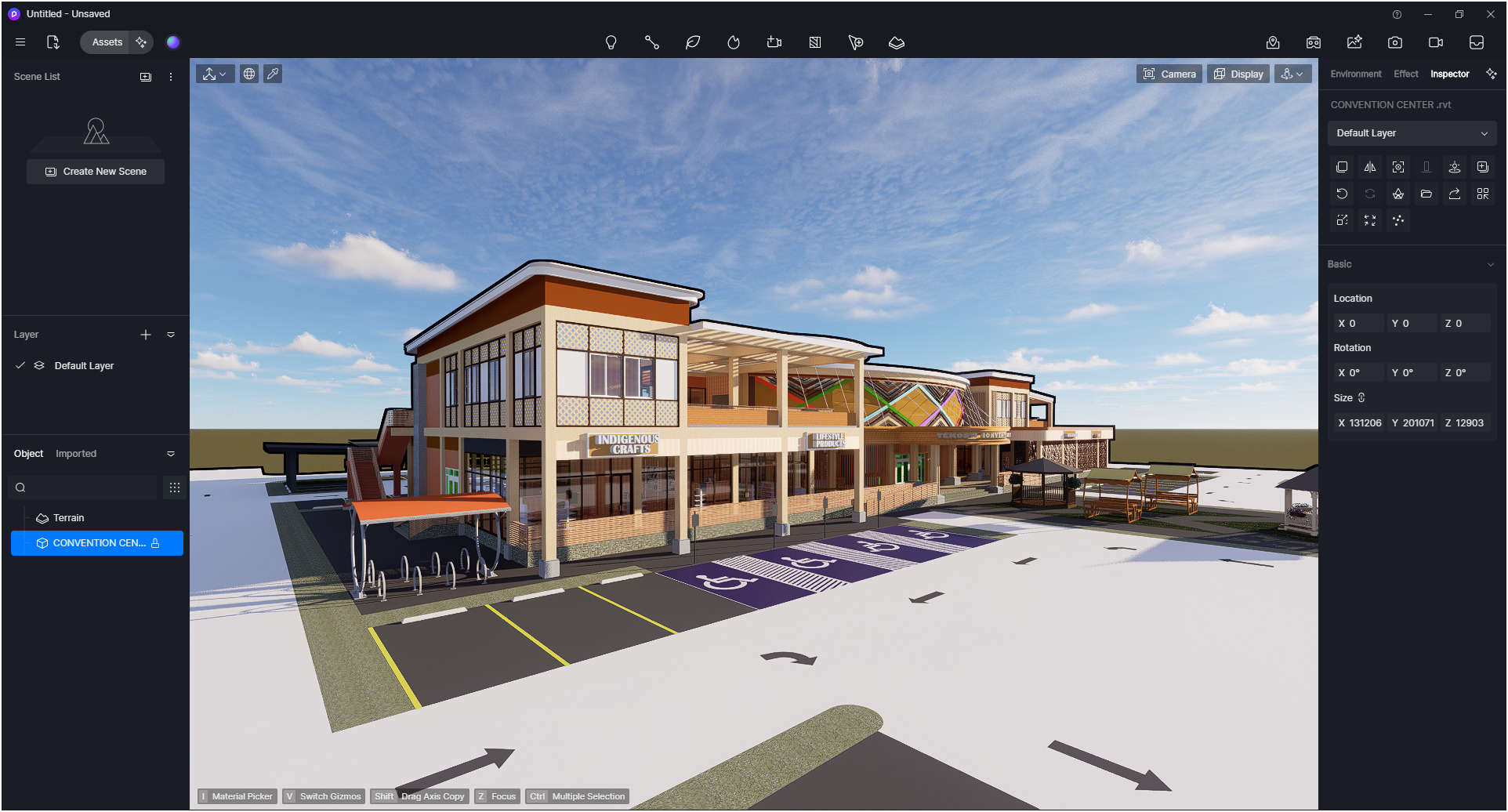

so the issue i m having is when i sync the file it wont show up it disappears in d5
So, does this issue persist upon activating the plug-in version? Are you using any cloud storage to store these files? If so, please download it locally first. As requested, it would be best to record a video of the workflow process on your end so we can check it and try to replicate on our end.

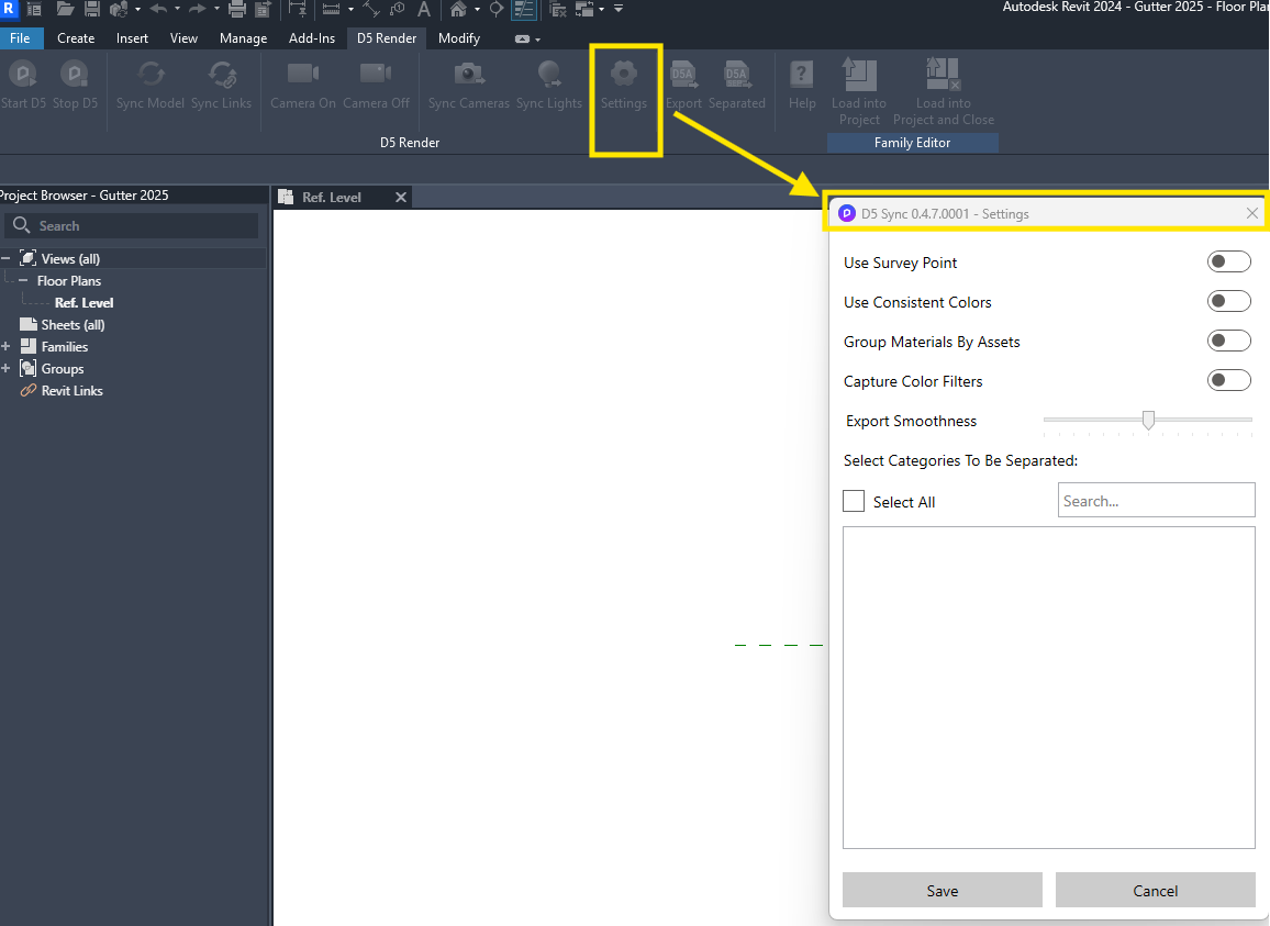

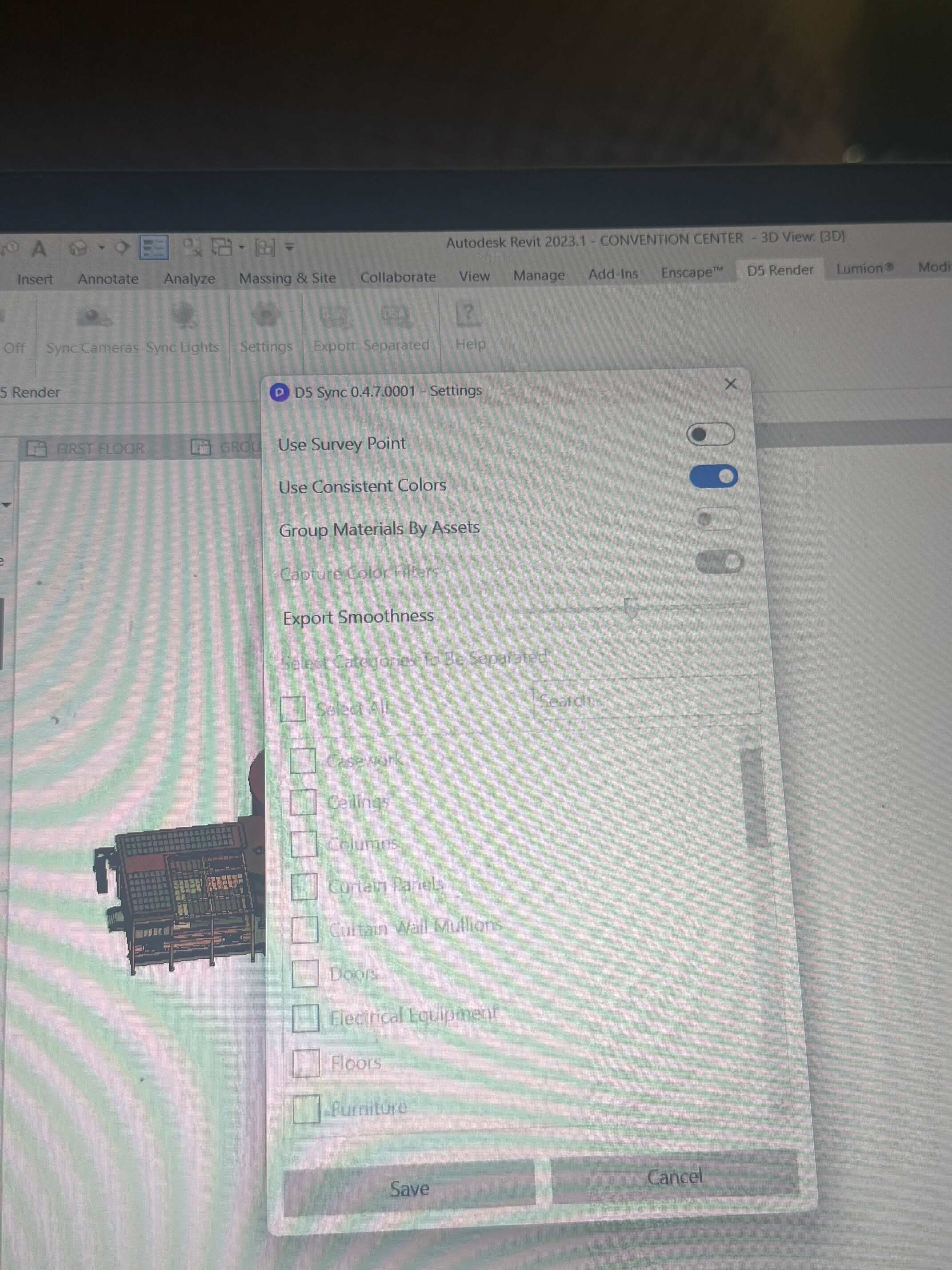

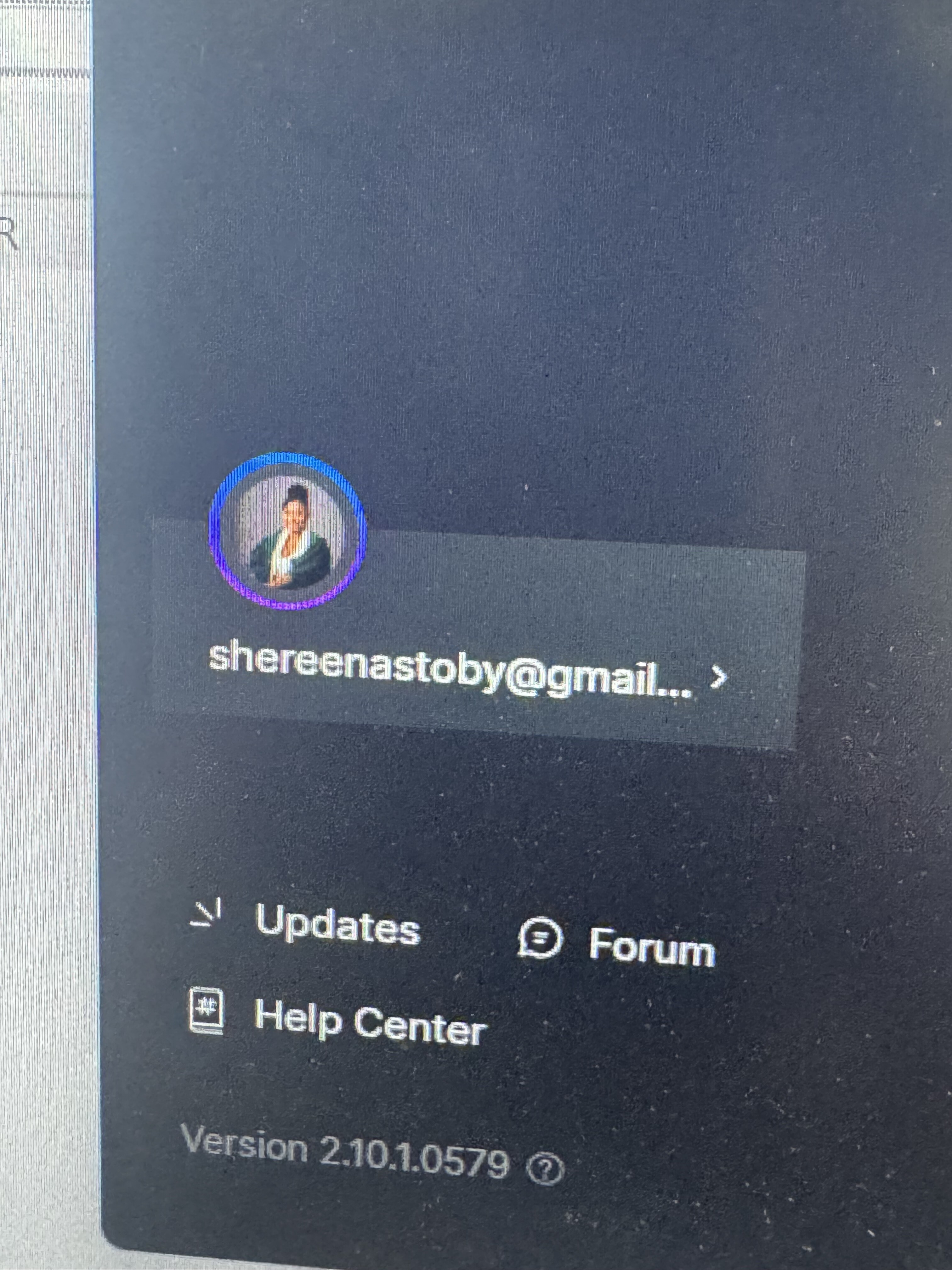

Additionally, please check the following and send us a screenshot:
- D5 Sync Plug-in Version
- D5 Render Version
Can you send us your Revit file? Please send it to support@d5techs.com and have it titled ‘Clov-Forum The Model Disappears’
Ok i did that
I just tested your file and activated the plug-in; it was successfully brought to D5 Render. Can you perhaps record your process on your end so I can check?
