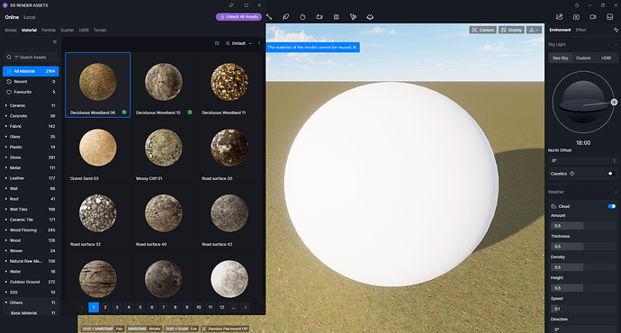

"The material of the model cannot be reused"
D5 Render Version: 2.10.2.0589
Graphics Card: AMD Radeon RX 6700XT
Driver Version: 25.6.1
Issue Description: Every time I try to apply a material — even in a brand new file — I get the message: “The material of the model cannot be reused.”
I’ve tried everything. I even opened the same file on another computer, and it worked perfectly there.
However, I need it to work on my main PC.

Hi, the file I used in the example photo is a new file created in D5. Previously, I used a model created in Rhino, which I imported into D5 using LiveSync and also directly, but it never worked for me.
In the case of the Rhino model, it was heavy, but when I imported it on another device, I was able to apply the materials without any issues.
HOWEVER, thanks to your idea of giving “full control” to the folder where the model was located, I figured that since the problem was with textures, maybe the folder where the materials were stored was the one causing issues. So I went into the “D5 WorkSpace” folder and gave it “full control”, and also unchecked the “read-only” box.
This solved the problems, thank you so much for your help!!! Really appreciate it!
