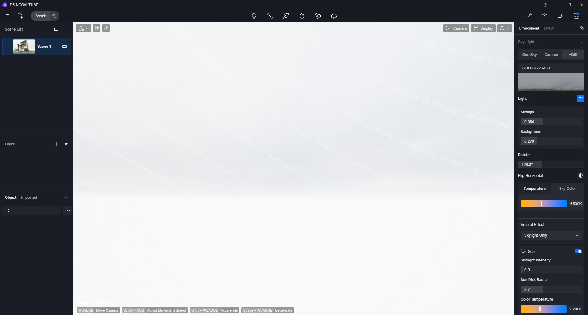

The file saved in portable hard drive now blank when opening
D5 Render Version: 2.10
Graphics Card: NVDIA GeForce RTX 3060
Driver Version: 32.0.15.7260
Issue Description: After saving the file, when opening there aren’t anything, the file folder are still heavy so i guess somehow the default layer got missing

  • I have try history version too but it have been grayed out so i can’t recover it.
  • I have try to open the 1.save file inside asset folder with notepad and i still be able to view the model that i have import/placed.
  • Since i think the problem are the disappearance of the default layer, i have try to use the merge project to merge it with a clean and new project but when opening the merged project, the problem still occur.
    In case you have any other solution, please help me, thank you!
