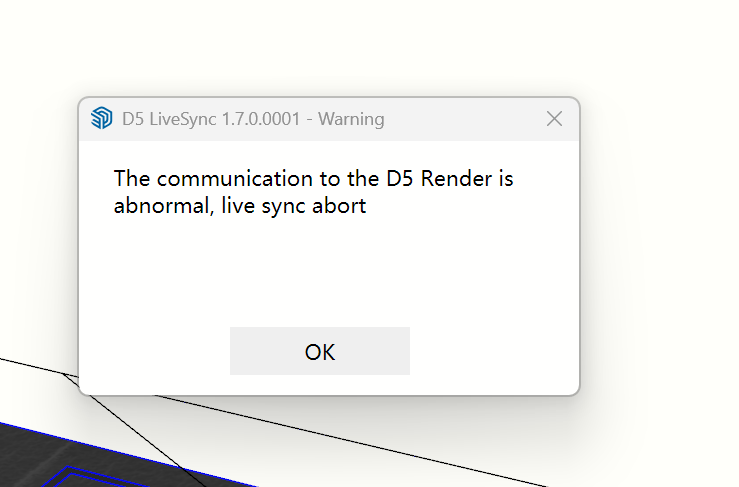

The connection to the D5 Render is abnormal
this file was okay and everything was normal, and I rendered a lot of photos. I had been working on it for 2 weeks, and suddenly it gave me this error, and I have no idea why.
and closing the file and starting again when it syncs normally and suddenly gives me this error once I change anything in the SKP file.

Same problems, with a 4070, i just recently start having sync problems between sketchup and D5, textures dint’ sync property or lost start connection between d5 file and sketchup. Any idea?
I have no idea, everything was working fine with this file, and it happened suddenly, and it is really an urgent project and I don’t know what to do.
Does this model contain too large areas with the 3D grass?
Can you send the model, scenes, and log files to us for troubleshooting?

hi thank you for answering, there is no 3d grass or anything in the SKP file,
but now what I did is there was a huge scale modeled walls I did in SketchUp and there are small ones I also modeled in Sketchup
I deleted the huge scaled one and made a cleanup for the file and it syncs up normally now.

Hi @althea.cabual. A newer version of the livesync plugin is available on the official website. Please install it and let me know if the issue persists. Apologies for the inconvenience.
