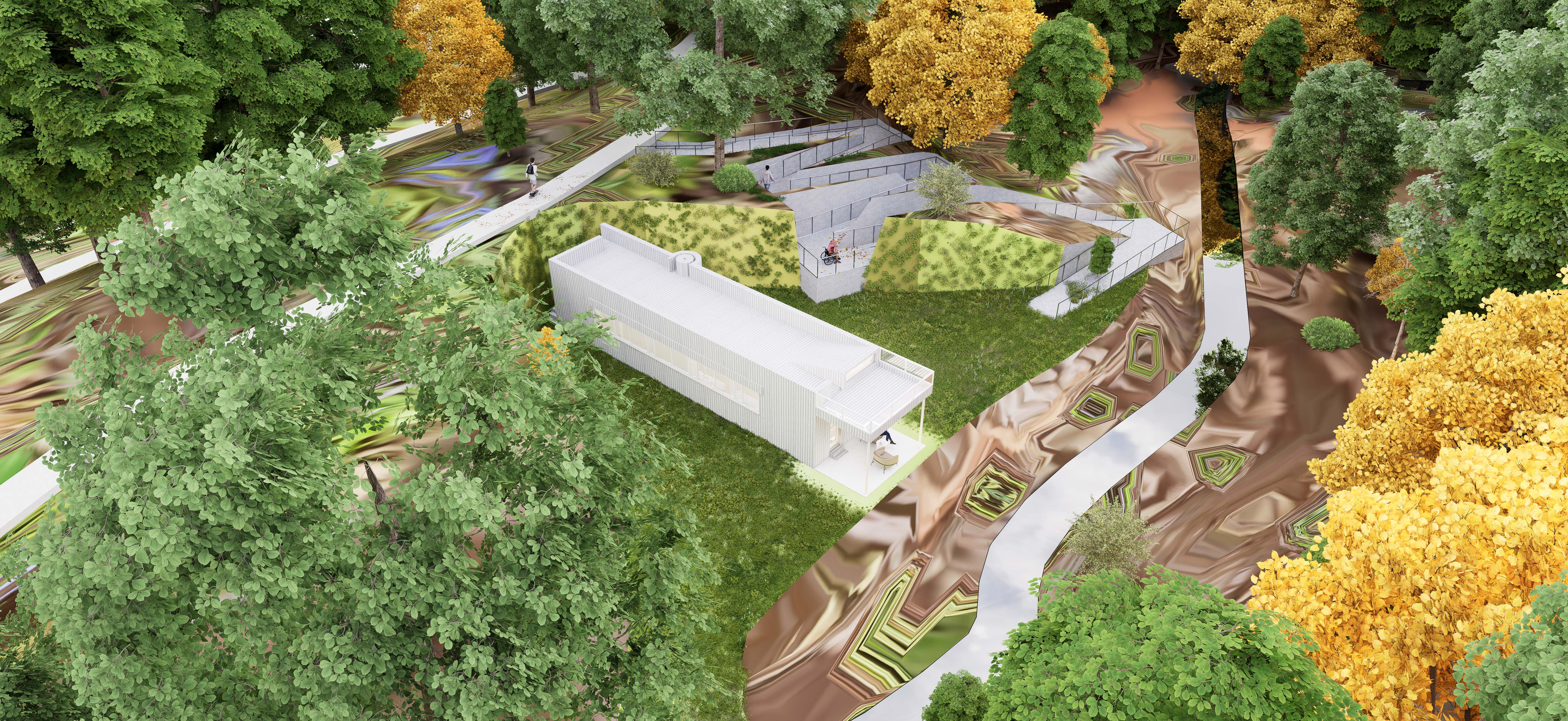

textures are not loading correctly
when i try to apply a texture to this material it doesn’t scale properly and has a weird geometric pattern on it. any suggestions on how to solve this issue?
(the model was made in 3ds max)
Hi @ishrimali
How was this 3dsMax file brought to D5? Is it by direct import or via the Livesync plug-in?
Please check the following:
  • Check if your model is far from the origin (X and Y Values), it’s best to keep them near 0,0, otherwise some materials may malfunction. This is for both the D5 file and the 3dsMax File.
  • You may also try changing the material template that you have assigned for this specific surface, if it’s set to Displacement try to change it to custom or vice-versa
