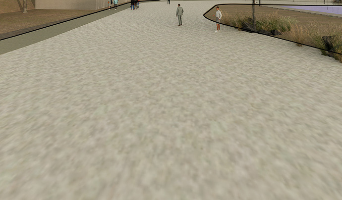

Texture in my file loaded all blurry
D5 Render Version:2.11
Graphic Card:NVIDIA RTX3060Ti
Driver Version:32.0.15.8180
I loaded up a quite heavy file, which took a long time to open, when it opened all the files textures look blurry and even if I try to set new textures they now look like this… I rendered a test image and it also comes out like in the preview. Could it be due to the file being to heavy (my Vram is at 93%) is there any way to fix this, yesterday the file was even heavier and the textures loaded up correctly. And the backup files all have the same problem…
Hi @saunfita
Please check the following:
  • Try to adjust your model’s location, preferrably near the origin (0,0)
  • What happens if you activate Tri-Planar mode for this surface?
  • Does the same issue occur to all materials applied in this surface?
  • Where was this model created? Try changing the UV Mapping of it in your 3d Modelling software
