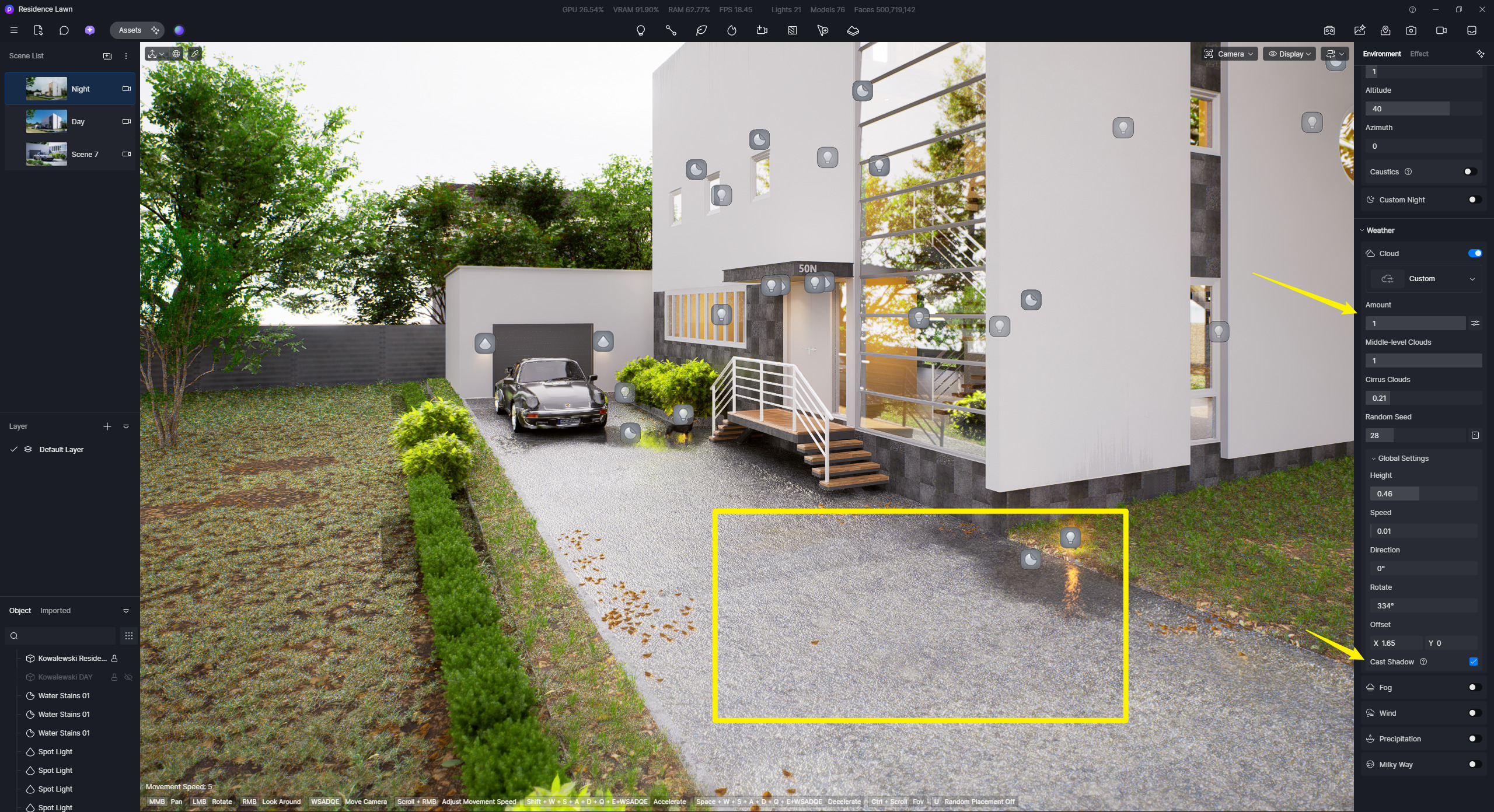

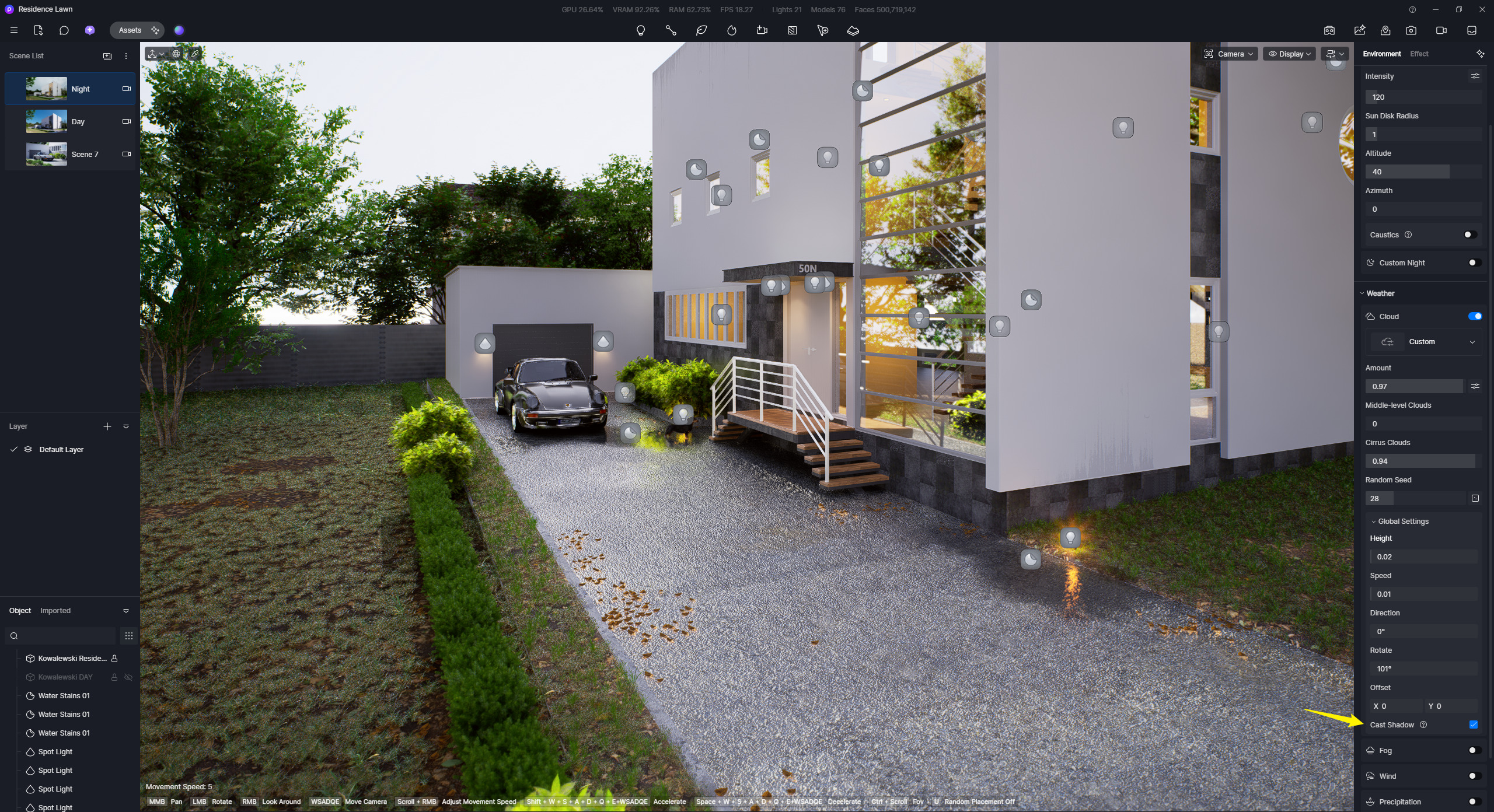

Sun shadow still visible in GI and reflection channels using Cloud Shadows
Sun shadow still visible in GI and reflection channels calculations using Cloud Shadows turned on ( 100% cloudy )

Hi @Smolak
Can you please include the D5’s UI while you’re recording so I can check the settings that are observed in your file?
I can replicate this, but only when using thinner cloud presets.
Cloud type matters; some presets (e.g., Altocumulus, Cirrus) are naturally thinner and allow more light diffusion than Cumulonimbus or Stratus.
  • Even with high cloud amounts, D5’s physical sky model may still allow diffuse skylight (not direct sun rays).

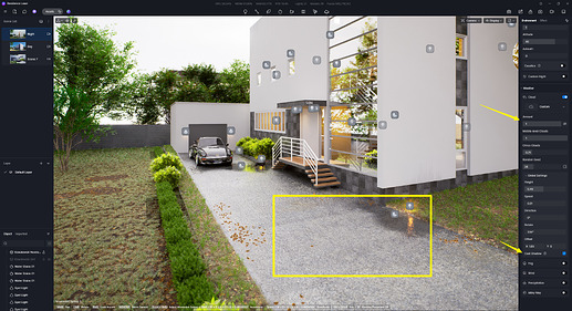

Hi @Clov,
Please observe glass reflection where is visible sun shadow and GI under balcony while changing Sun orientation. The same in beta.
sun_visible (2).zip (3.7 MB)
