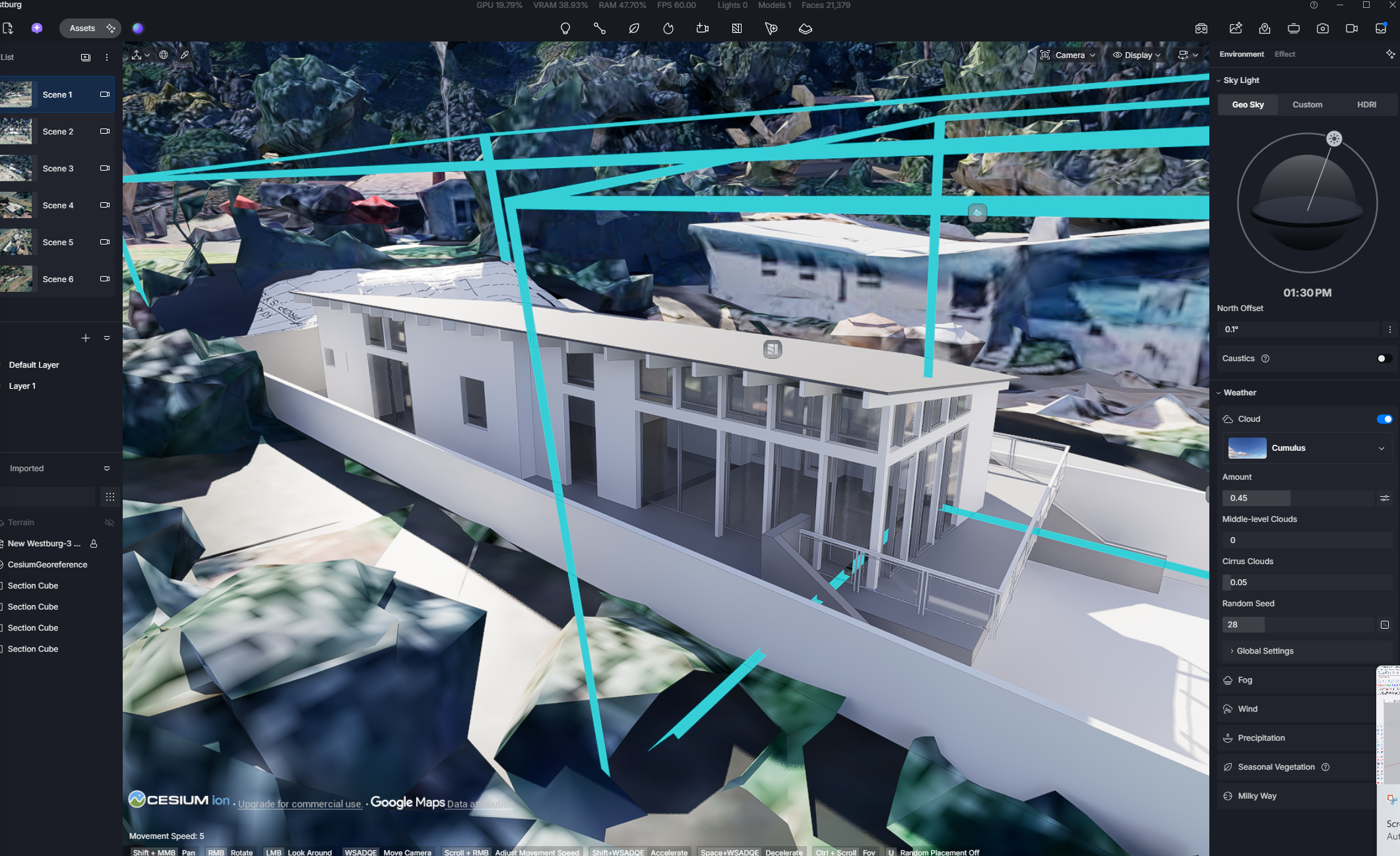

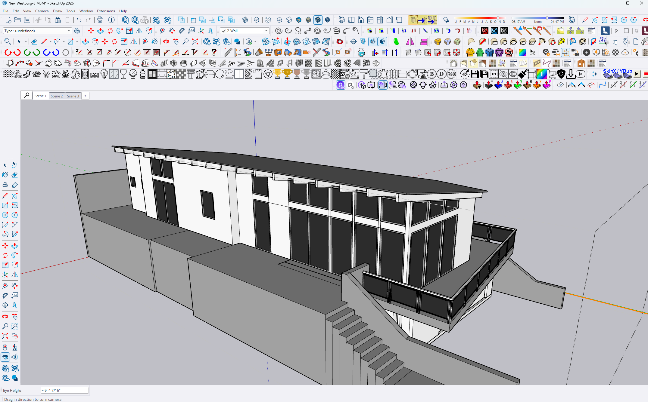

I am having an issue syncing a model. For some reason some elements are offset from the original model. I have included a screen shot to show to issue. The glass and window frames are offset along with the handrail system. If I create a new model file with d5 everything looks correct

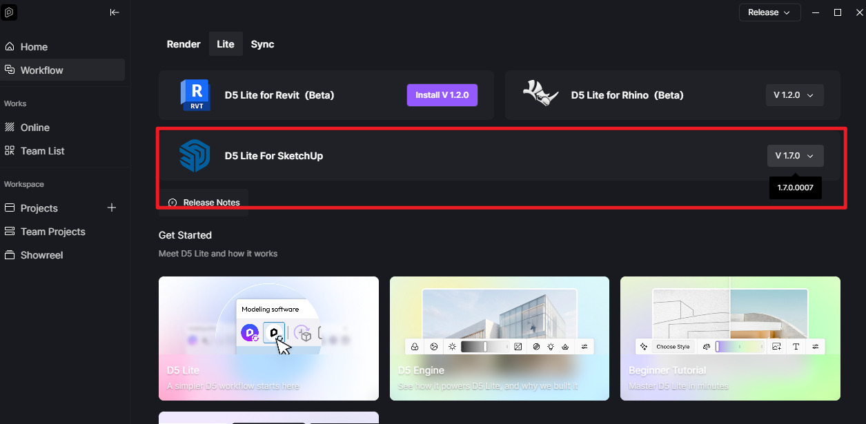

Can you also check your D5 Lite version?
