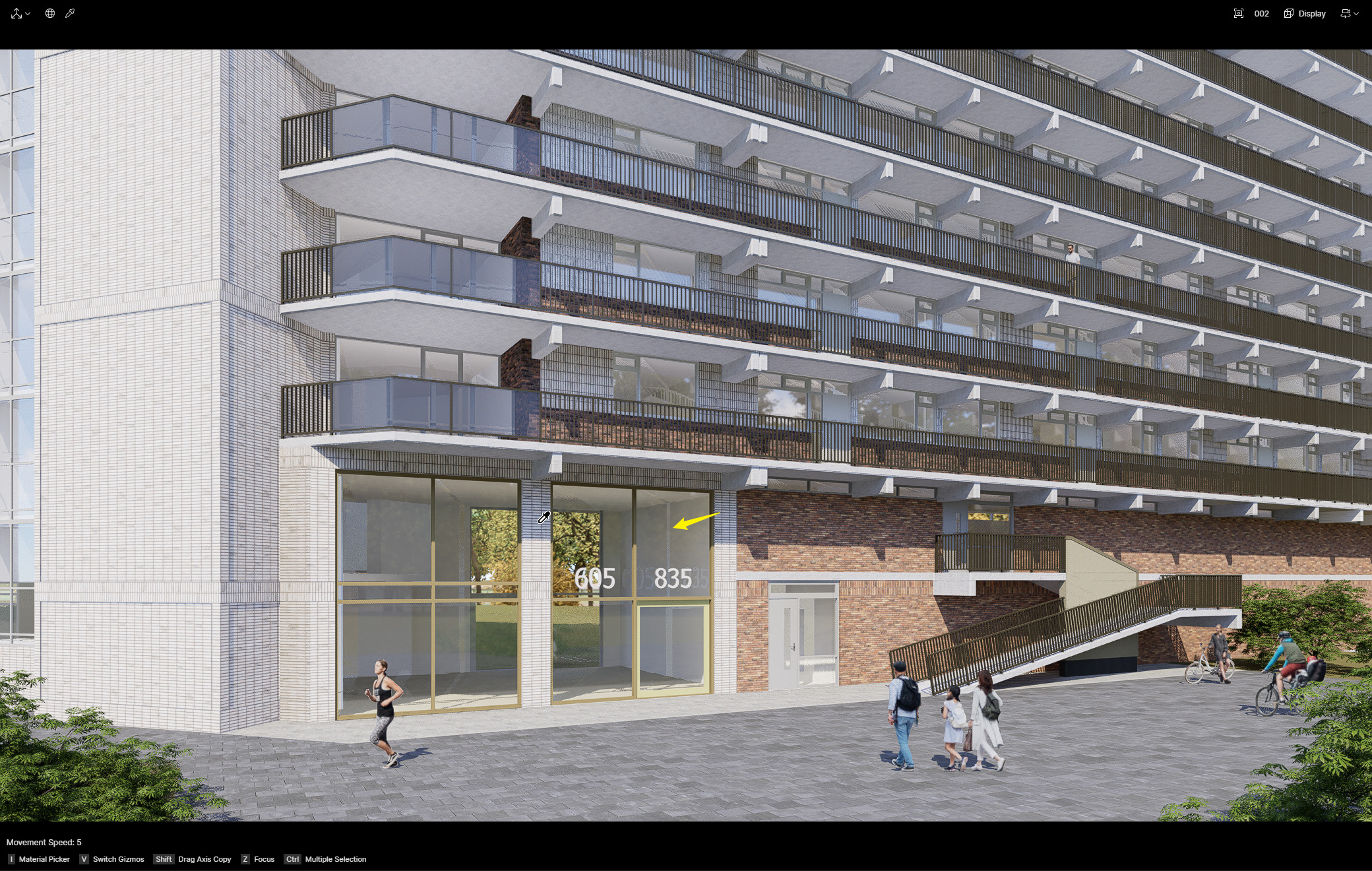

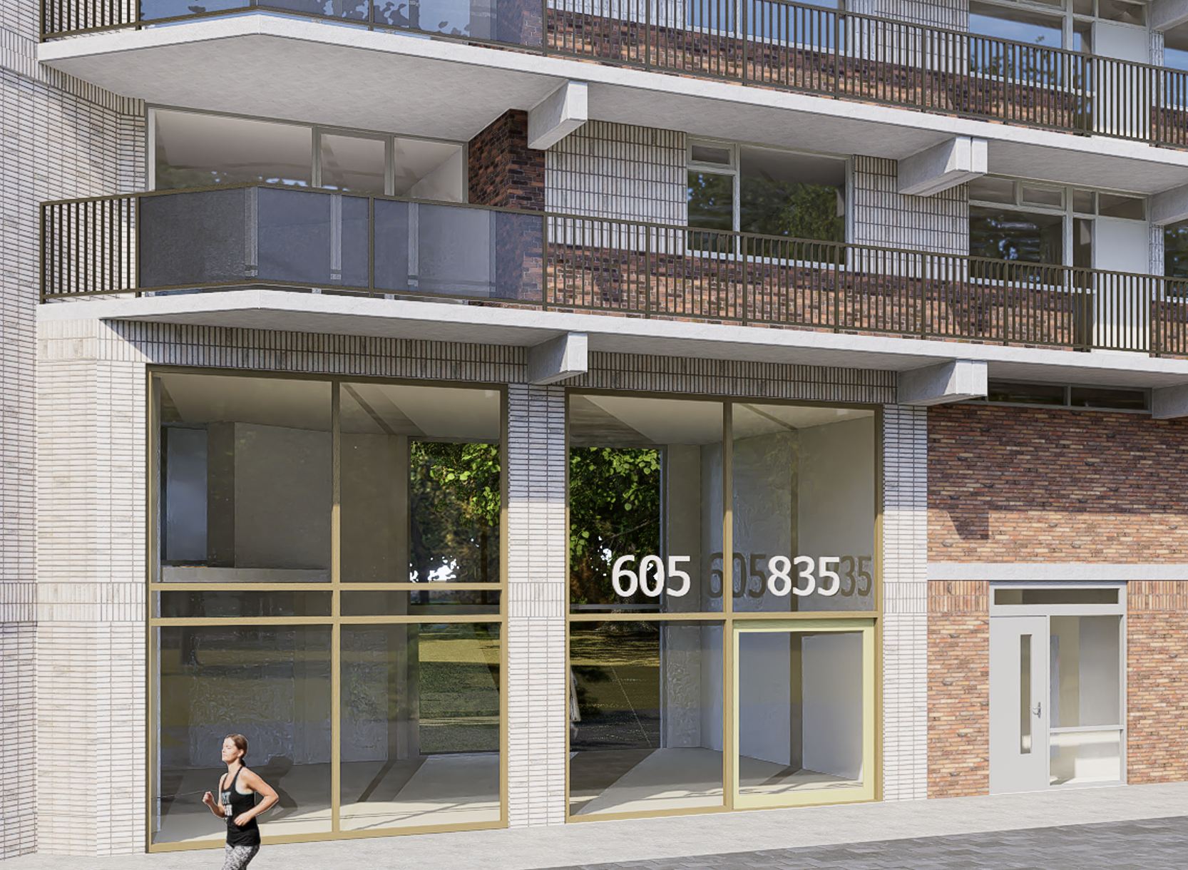

Strange reflections behind glass (not shadow)
D5 Render Version: 2.11.0.0603
**Graphics Card: NVIDIA GeForce RTX 3090 **
Driver Version: 32.0.15.8108
**Issue Description: I encounter these strange reflections behind glass. It basicly reflects a window frame, but it is not a shadow. the normal shadow is being cast just fine. It changes direction when i change the camera angle. It also reflects on the ceiling. I have tried changing glass material and window frame material. Help would be appreciated! Thank you

Hello Clov,
This issue disappeared immediatly when i checked off the ‘Thickness’ box in the glass materials properties. As i am new to D5 and a long time Lumion user i might have run into a D5 beginners mistake. Sorry for that.

Hi @martijn
How is this specific glass panel modeled on your end? Any polygon or another surface present inside? It seems like it stems on how it was modeled.
Hello @Clov
Thank you for looking into the matter.
The glass is a single flat plane in SketchUp. I also replaced it in the proces of troubleshooting myself earlier. It still persisted after that. Also tried to open a clean D5 file and imported the model, same issue.
Hi @martijn
Can you separate these windows and save them in another SKP File, then send it to me?
