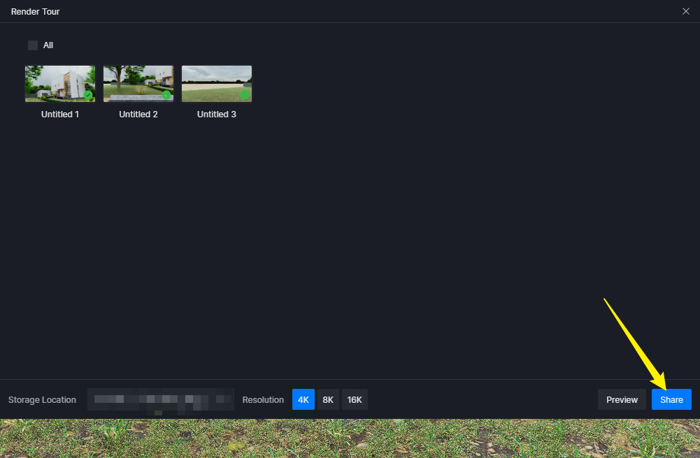

I am rendering a spatial tour, and when it finished rendering the pop-up window to upload it to the online showreel didn’t appear, however the spatial tour did save locally to my device. Can I manually upload the Spatial tour to the online Showreel based on the files produced locally on my computer?
Thanks!
Hi @bcross

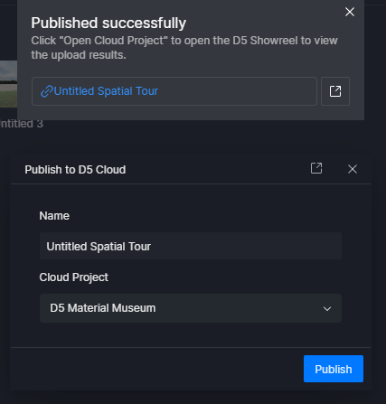

After the rendering process, try to click “Share.” It will be published to your D5 Cloud which is accessible by logging in to your account in d5’s official website (MySpace)
