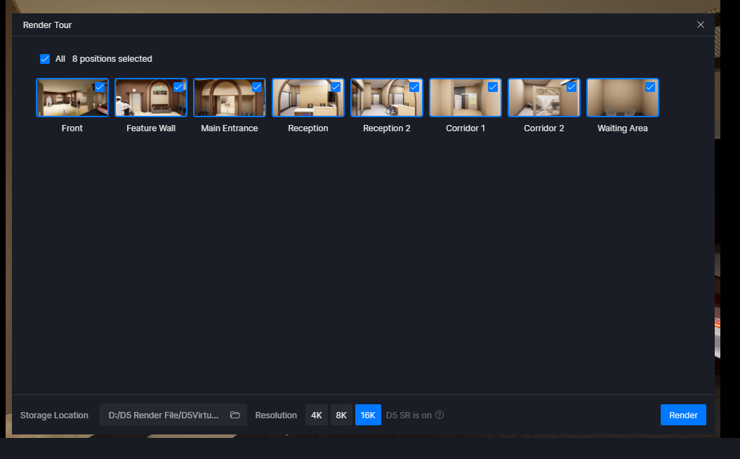

Hi, i have an issue of export button is missing in spatial tour setting, is anybody able to help me about this?

Thanks for reaching out. May I know if you changed the save path after starting or completing the render? When the save path is switched, the Export button may become unavailable in the Spatial Tour settings. Even if the path is switched back, the project usually needs to be rendered again before the Export option appears.
Thank you for the response. I did not change the path, i use the default path same as when i installing the software. I had tried to render few time without touching the path setting, the export button still not showing.
Sorry for the delayed response. The export button for Spatial Tour will not appear if you select “All” during export. Please try selecting the objects individually, then attempt the export again.
Let me know if this resolves the issue or if you need further assistance. Thank you for your patience
