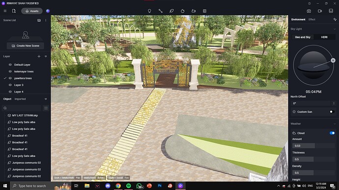

Issue Description: d5 very laggy and hard to work with. My file is relatively small compared to all the videos that convinced me to subscribe d5. I’m so sad. please help me make it smoother. idk if my file is too big and i’m honestly helpless in this

![test 2k|690x485](upload://mIrx9CxK2yI5jtPnBnnOGTT23rn.pn
this is the 2k picture i managed to render, it took 2 minutes which i think is okay?

i am very new to d5 so i’m not sure how to check T-T. Share scene means send you my d5 file? picture attached is all i get after following googled instructions. so sorry, i’ll try my best to cooperate :<
update, i ran d5 as administrator and it worked. The lagginess however, is still very much here :confused:
Hello! This pop-up shows you that you have insufficient VRAM. Your problem may be caused by a large scene. I suggest you to reduce the use of effects such as depth of field, tindal effect, etc. Also, you can try to reduce the use of high-precision assets and textures in your scene. Alternatively, you can try using maps instead of plants in the distance.
