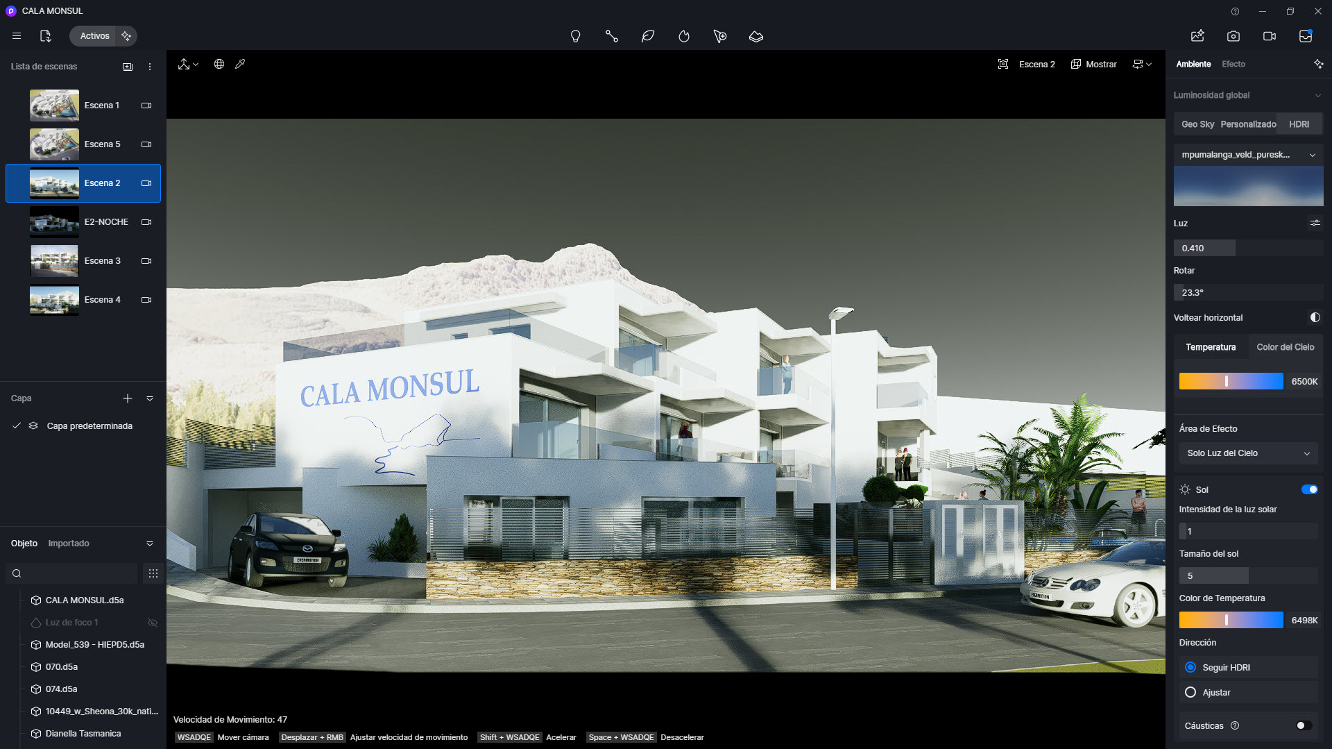

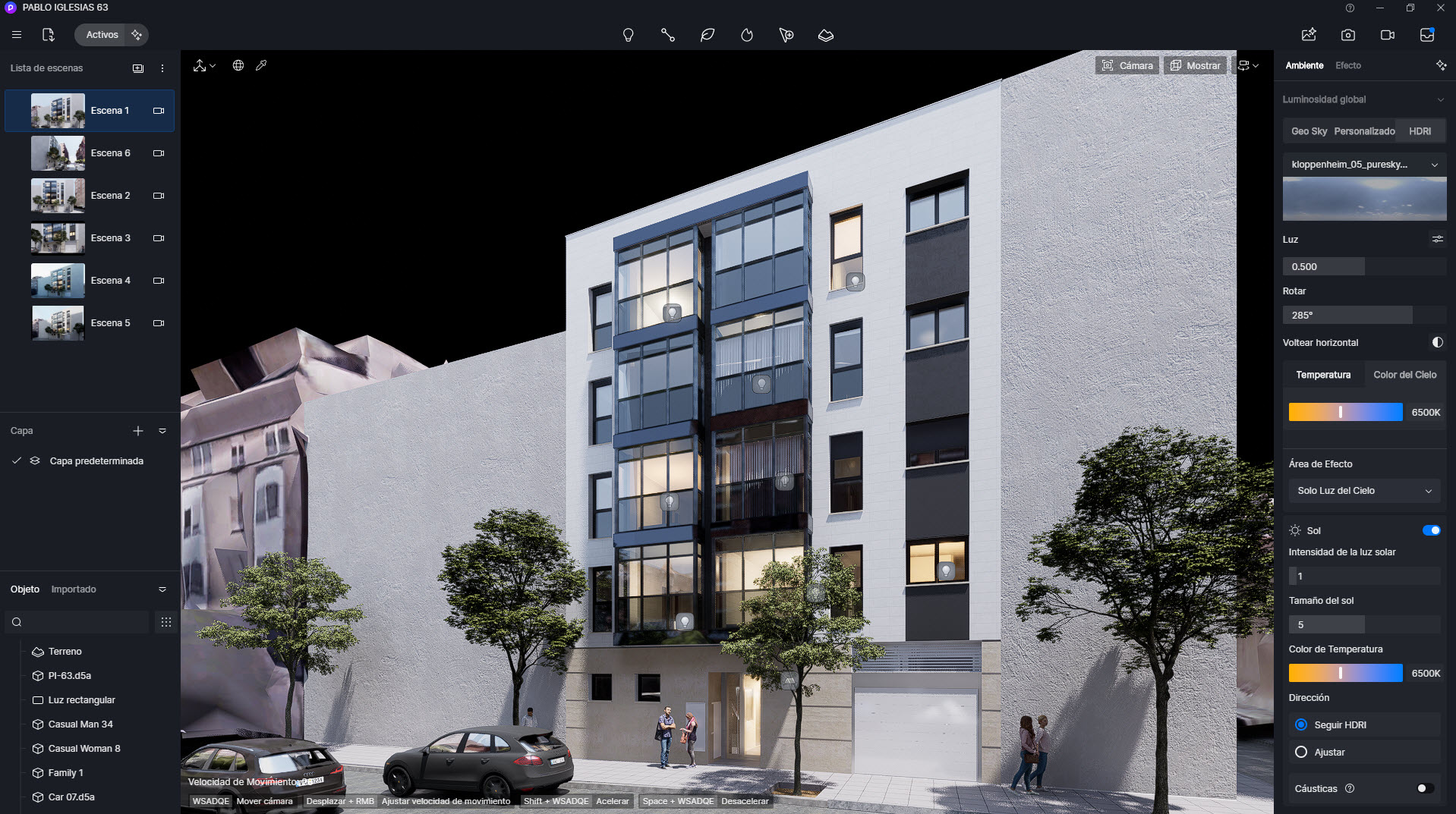

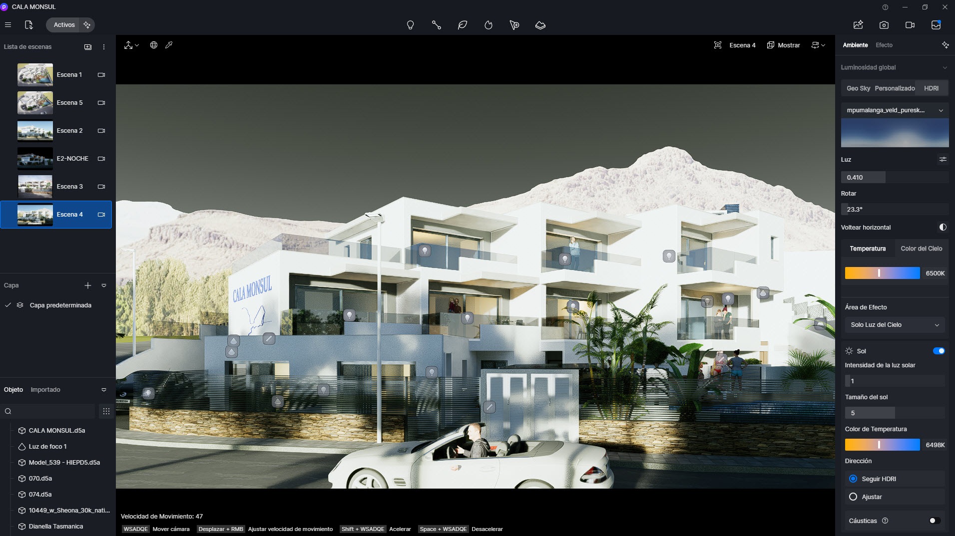

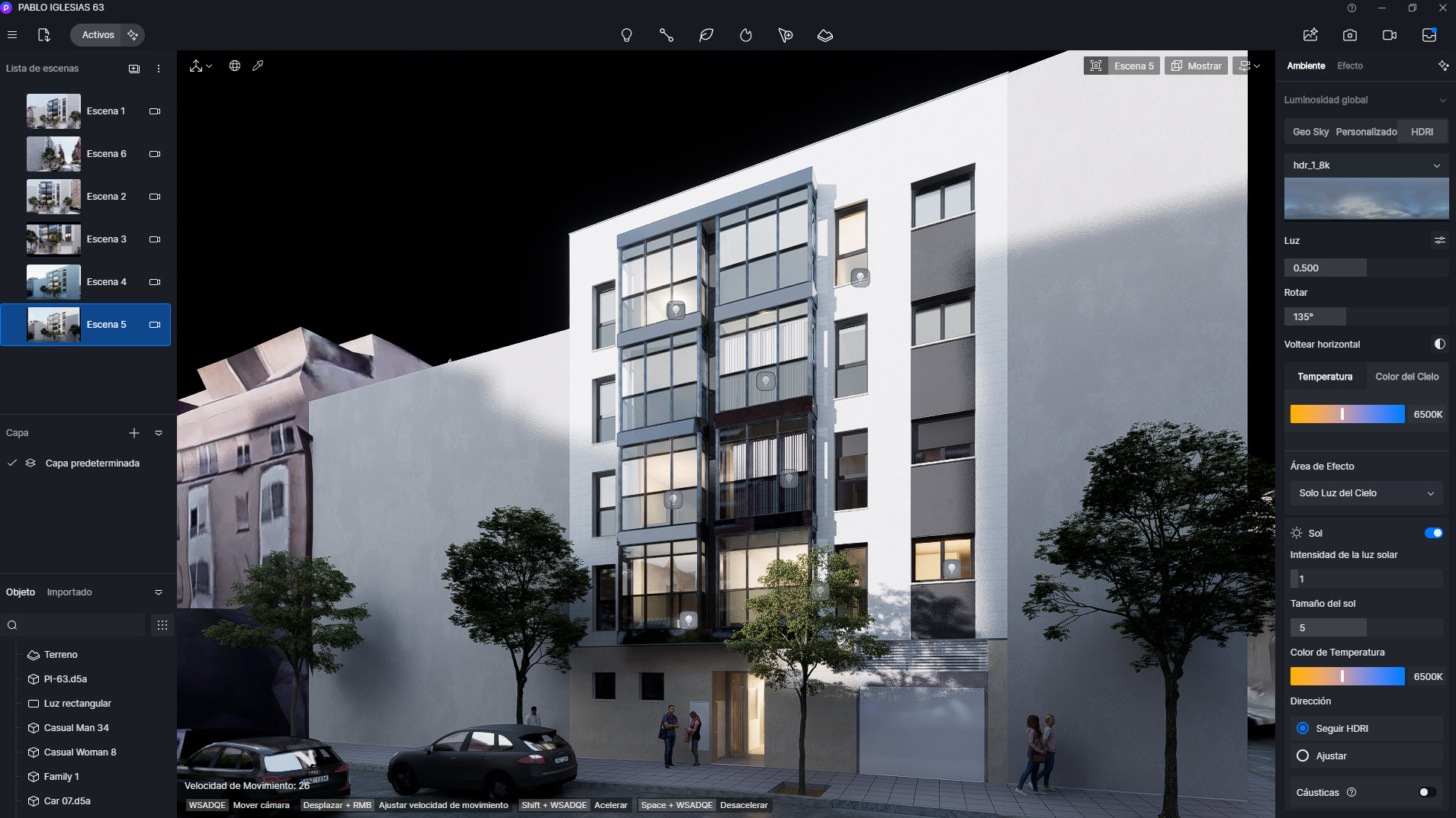

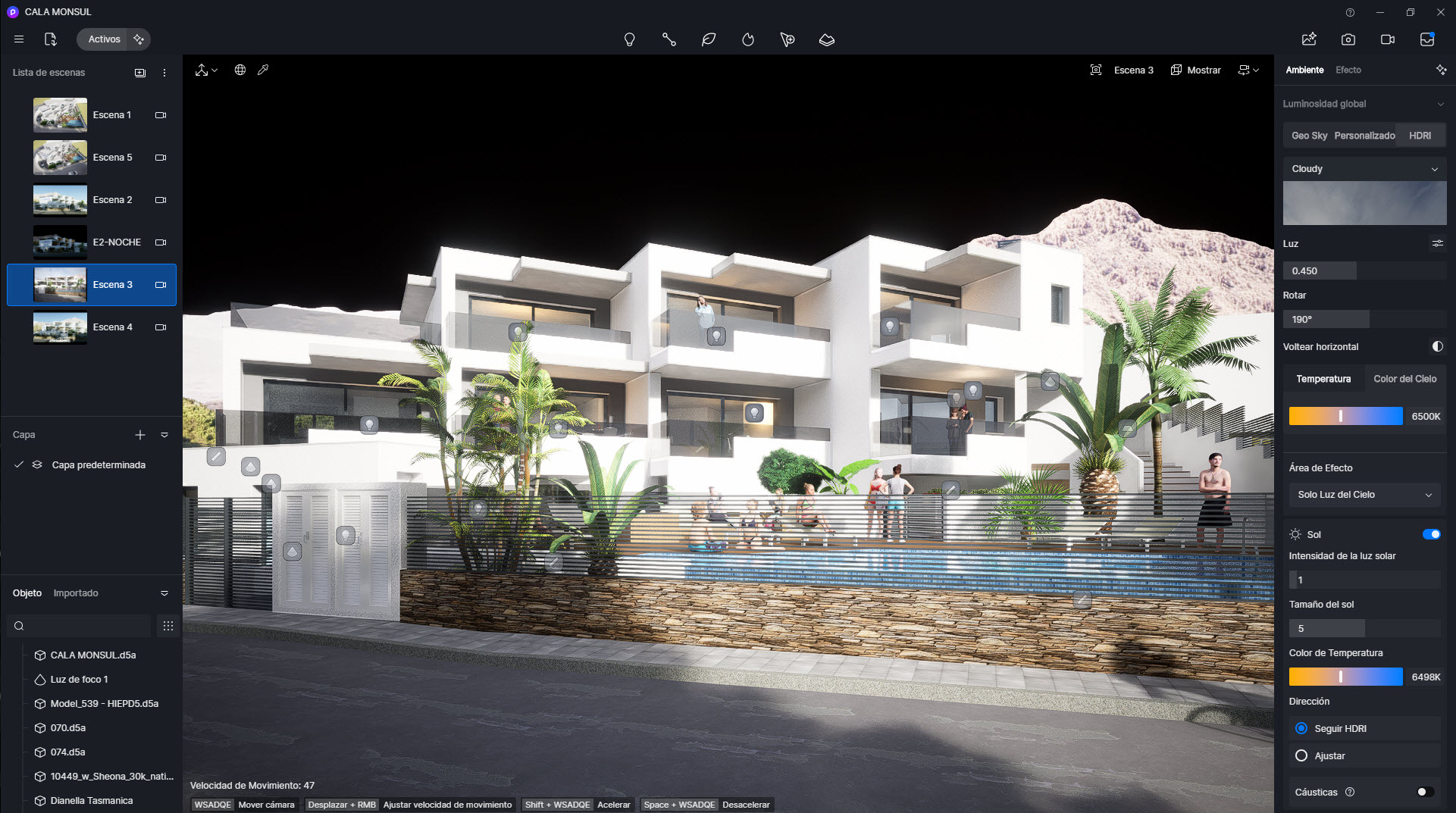

Issue Description:
Suddenly opening all my D5 project files, Scenes are not showing sky backgrounds from HDRI. Also noticed that my model file is not showing after reloading from Revit workflow. In general I have experienced a very rare behavior of the D5 software just now. I tried this with a couple of my recent projects and the same result so is not file specific setting
Screenshots/Videos Description: Attaching image files where skies are shown black, check scene thumbnails
