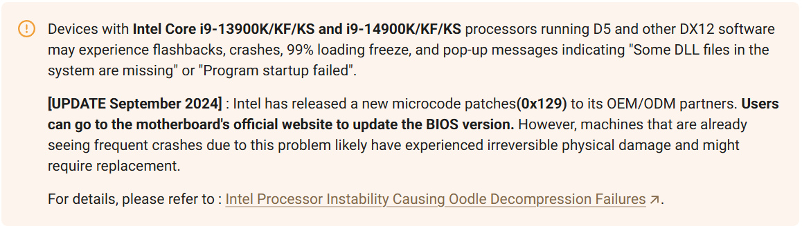

Hi @lfhernpernia
If its happening on all of your files even empty ones, then it might be best to update your BIOS since the processor you’re using is Intel Core i9-13900HX.
  • Although i9-13900HX is the laptop version of i9-13900, we still suggests updating it.
