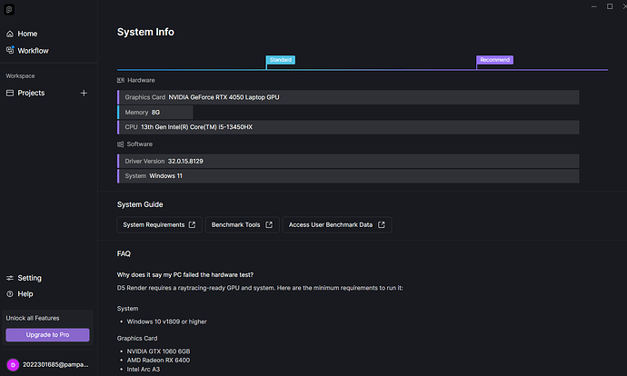

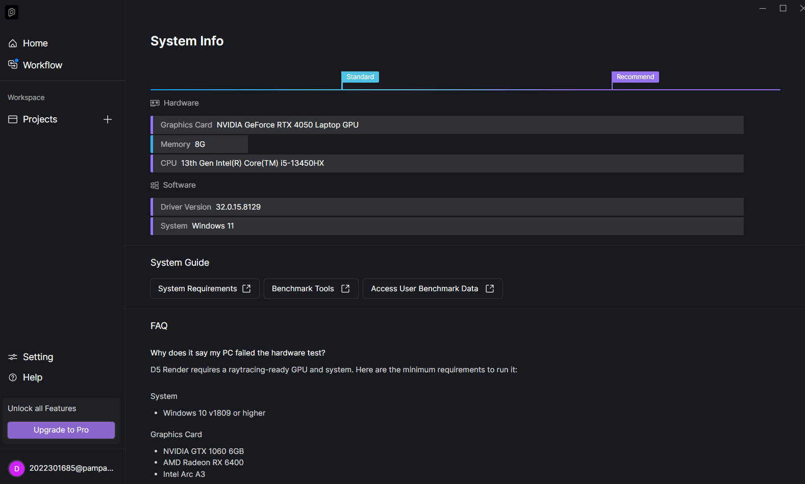

D5 Render Version: 1.0.0.0205
Graphics Card: NVIDIA GeForce RTX 4050 Laptop GPU
Driver Version: 32.0.15.8129

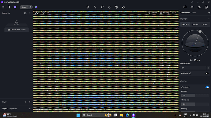

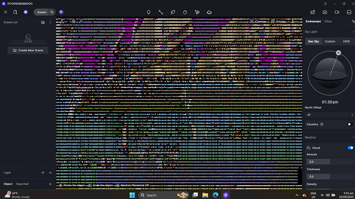

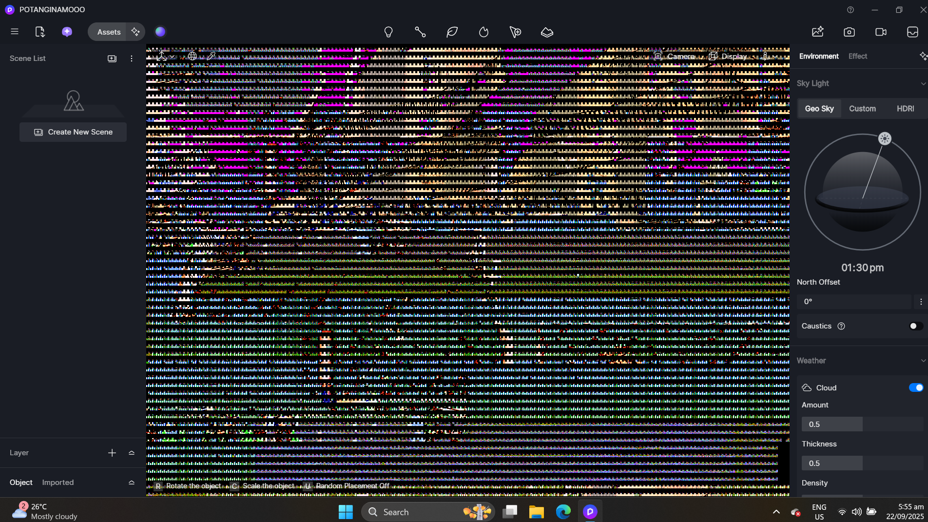

Whenever I open my file, it would look fine at first. I can see my site and everything but when I try to put an asset, the screen glitches and I cant see anything at all and the d5 would crash. I already tried dowloading a graphics driver and updated it but it still resulted the same.

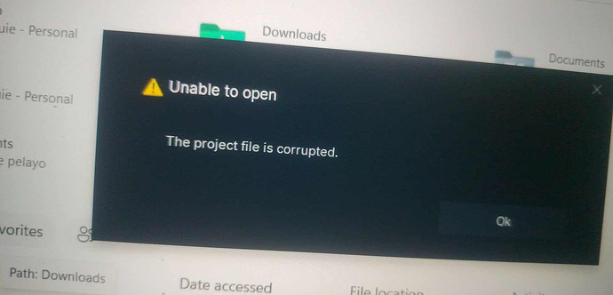

Hi! so i let my classmate try the file on his laptop and it said that it was corrupted.
Hi @2022301685
How did you send the file? If you only sent the DRS then it will surely corrupt; you need to send the whole D5 file folder. Refer to the image below.

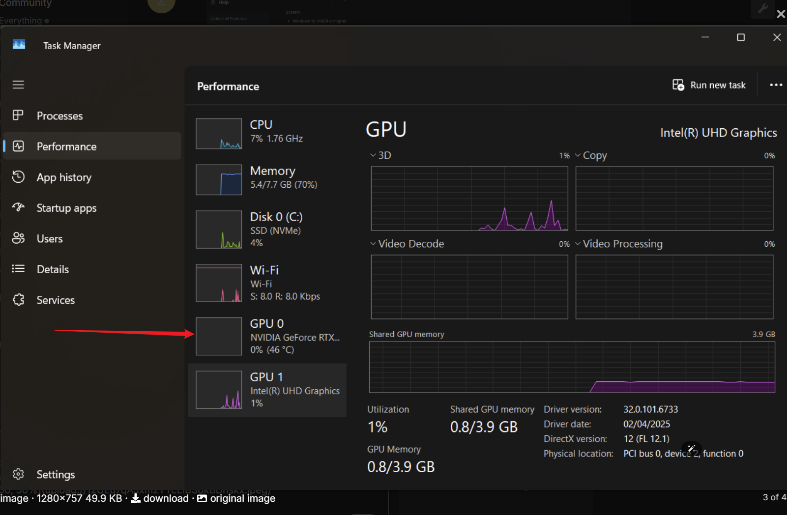

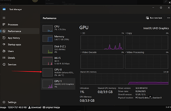

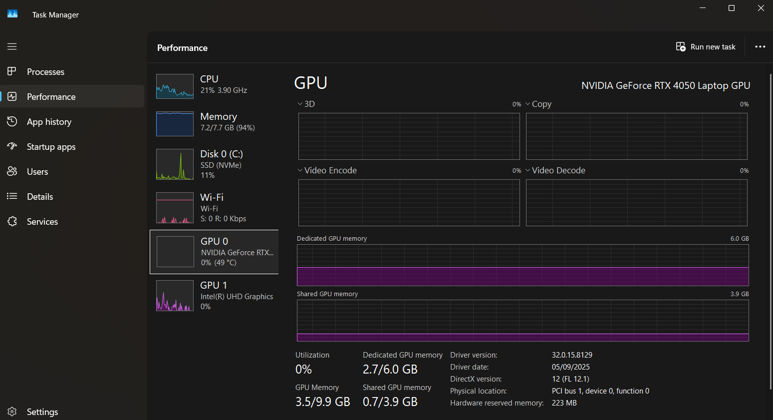

  • Please click GPU 0 instead of GPU 1, i need to check your Dedicated GPU.

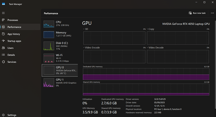

also here is the GPU 0
