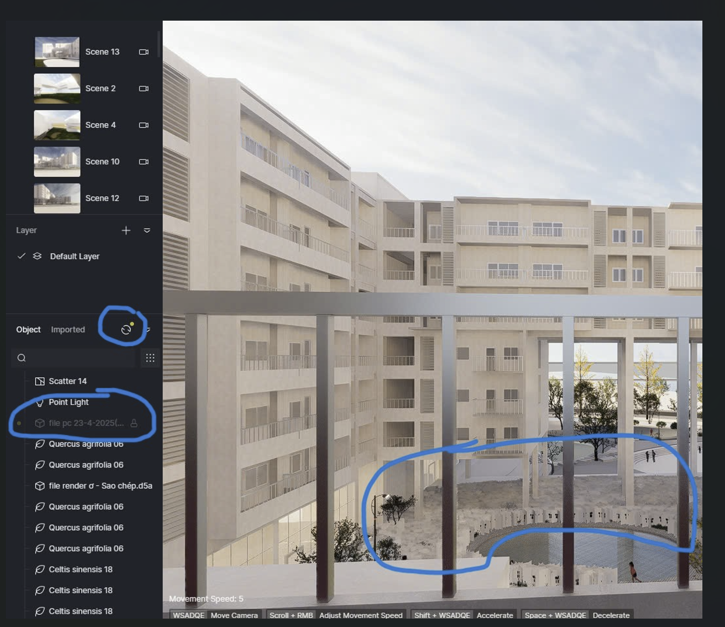

Hello, my D5 suddenly has an issue where the grass is scattering into patches like this. Could you please advise how to fix this problem? I’m in urgent need of help, so I’d really appreciate your earliest response. Thank you!

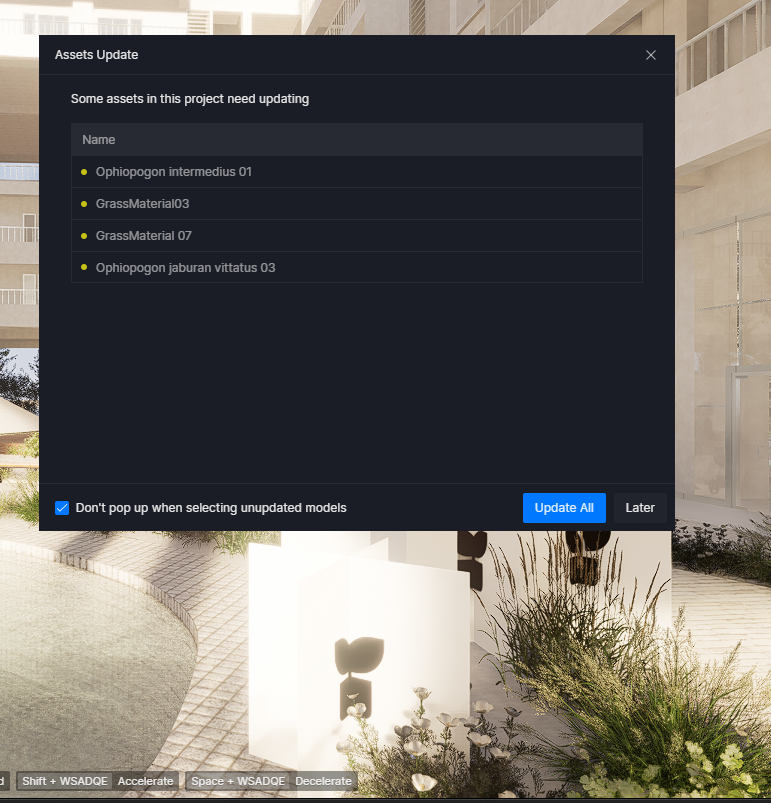

Yes, I updated them, but the process keeps repeating, and the lawns remain as white patches

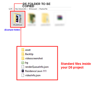

Are you perhaps using a cloud storage to store these files? Including the Workspace folder perhaps?
If so, can you please download them locally (local file path and not to google drive, one drive, etc.)

Oh I meant that the D5 Folder of this specific project should be placed in your local path. You can simply copy the folder then place it in either C or D drives.
i saved it on my D drive, but the issue still persists. Is there any other way to fix this

I just tested your file. I have updated the assets and it seems to be normal on my end. I will be attaching a video recording.

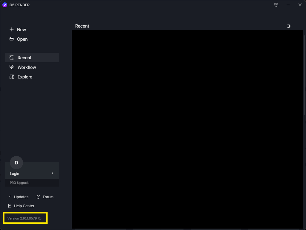

- Please also show which Version of D5 you are currently using.
