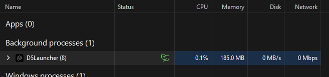

Haven’t gotten around to the log files yet. All I know is that it’s doing strange things with Firefox and not allowing me to maximize Firefox during a session. I also noticed that D5 Launcher is taking up a lot of memory even when idle or “closed.” I set it to disabled on start up but once you start it it stays in memory even after it’s closed.

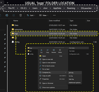

That’s certainly unusual. Can you provide us with the following to better troubleshoot this issue? (We’re currently closely monitoring issues involving D5 Launcher)
You may send these logs to support@d5techs.com and have it titled ‘2.11 Clov-Forum Scatter 2.11 and Misc’. Please let me know if you have already sent it so I can immediately pick it up. Thanks.

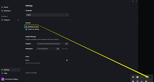

  • Regarding the launcher, although closed, is still consuming memory. Can you please check if you have enabled ‘Minimize to Tray’? If this option is enabled, the launcher will just minimize in the Tray Icons and will consume memory but in small amounts.

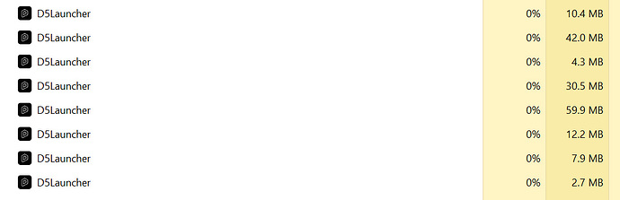

Are all those instances of D5 Launcher normal?

Yes, the instances from the launcher when minimized in the Tray Icon is normal.

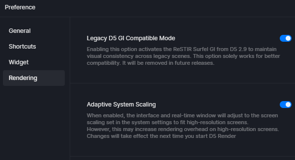

  • As for the issue regarding firefox, I tried replicating it on my end with the same process but firefox is maximized. Were you able to explore some settings in Firefox or perhaps enabled D5’s adaptive scaling?
