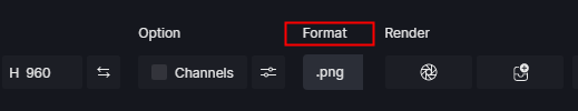

Hi here, you need to turn on the Advanced Image Rendering in Widget. After switching this widget, you can select .png .jpg .tga .tif .exr in the Format option, when rendering images. Hope it helps.

Thanks for your feedback. You can turn on the Advanced Image Rendering Widget and then you can select the format you want ( .png .jpg .tga .tif .exr in the Format option ).
