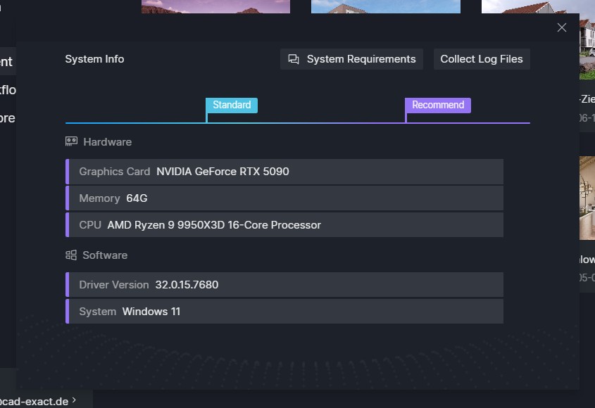

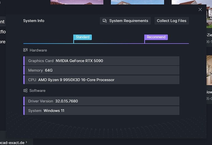

**Graphics Card: RTX 5090
**Driver Version: 576.80

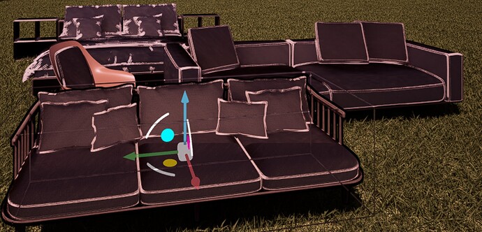

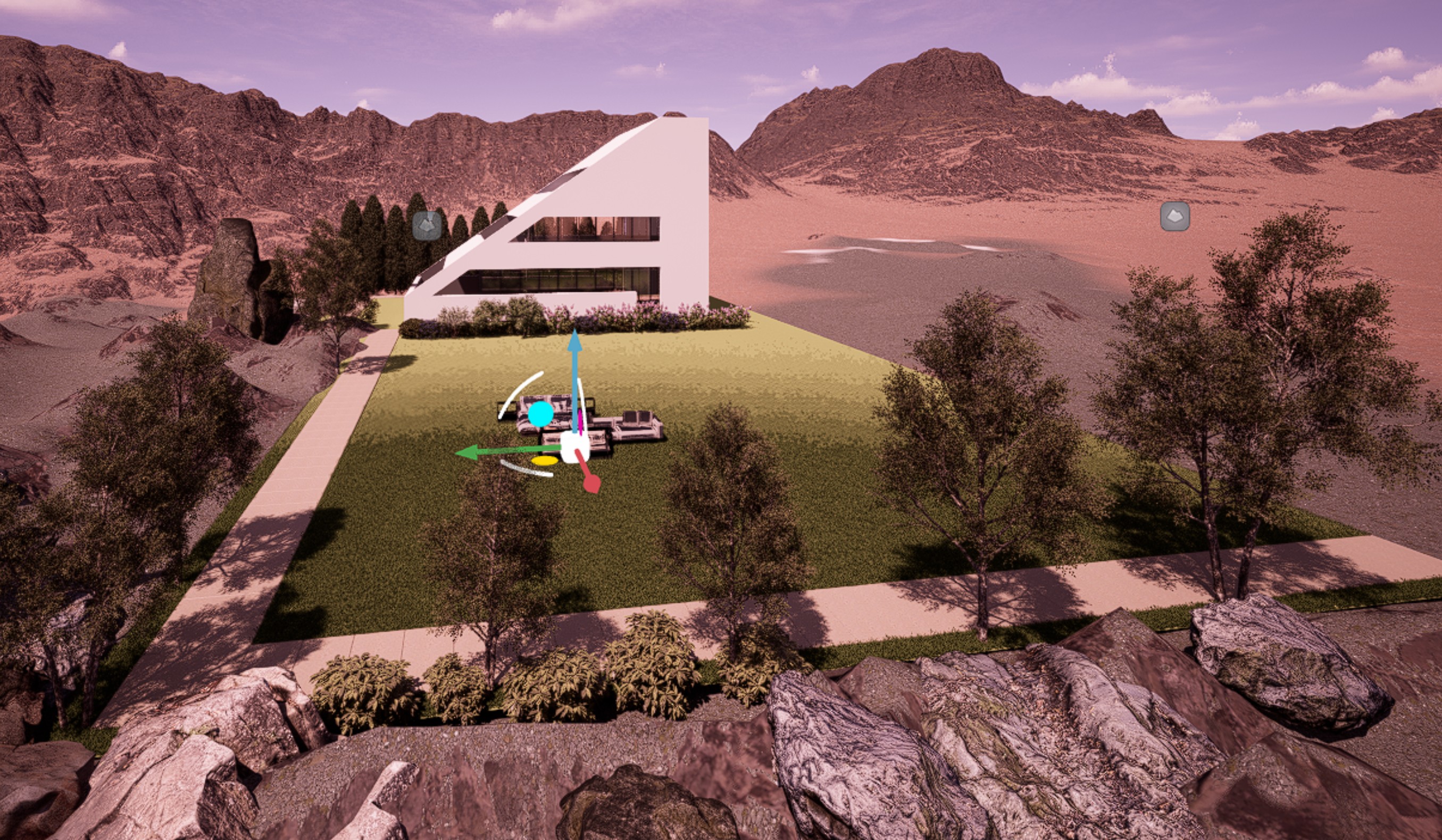

The display is much worse with my new RTX 5090 than with my previous RTX 3090.
How can I change this?
Here are some screenshots showing my problematic display under the RTX 5090:

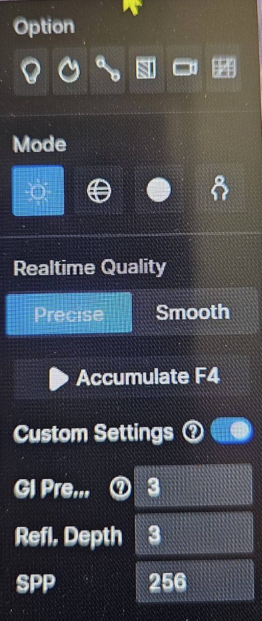

Here are some screenshots of my settings:

Hi @a.drexler
I apologize for the inconvenience, but can you please include images on how this scene normally looks?
  • Additionally, we do have an issue with Drivers 576.02 and beyond for RTX 5000 Series devices (round corner enabled, please use 572.83 for the time being. This round corner issue will be addressed in the next D5 Render Update.
It’s a driver bug.
Select textures and uncheck “round corner”.
All new objects have this box checked for most textures, which was not the case for existing assets.
… Thanks for the info.
Bye
Andreas
Thanks for the confirmation @a.drexler
This issue will be addressed in the next D5 Render Update.
