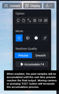

Hi there @julienfischel
Path tracing provides a more accurate representation of how light interacts with surfaces, which can lead to a perceived loss of roughness. However, this is often a more realistic depiction of the material’s behavior under natural lighting conditions.
If you wish to have the same roughness, I suggest:
After modifying the parameters, you can proceed to “Accumulate” to check and preview the final results before rendering.

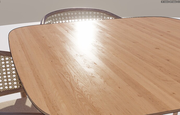

it’s the same with this floor, I can’t get anywhere, the roughness effect never appears in path tracer mode
normal render
And if you increase the rougness in the PT VERSION?
no way… I tryied many options

here’s the material I used
if I could find this quality in D5 with path tracing…
My opinion: wood floor 032 is wrong.

what do you mean “wood floor is wrong” your tests exactly match what we expect from this material
I will share the D5 material afterwards.
The error (not yours) was due to the type of jpg file created. If you open the file “WoodFloor032_4K-JPG_Roughness,jpg” in Photoshop you see that the color method is grayscale. It must be RGB color.
