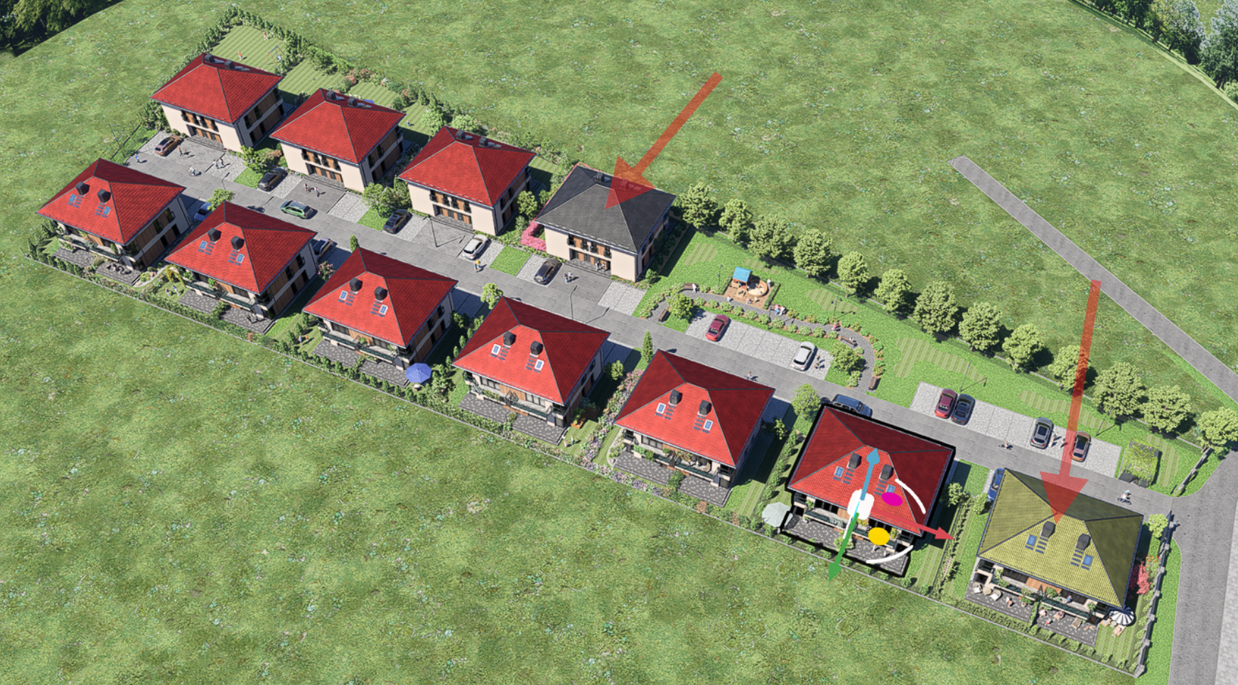

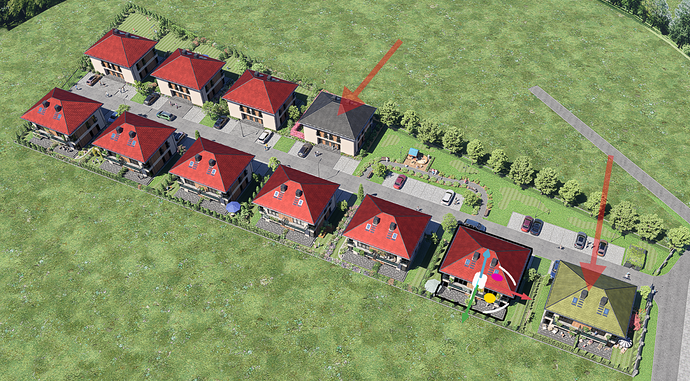

Replace from Local, Reload cause that objects loose their instances status - they are treated as unique
No way to update them all !
Hi @Smolak
When you use Replace from Local, D5 often breaks the original link between assets and their instanced status, causing them to be treated as separate, unique objects.
To preserve instancing and enable proper batch updates, please keep the same file path and file name, and use Reload instead of Replace from Local whenever possible. Once instancing is lost after replacement, it can’t be restored automatically.
