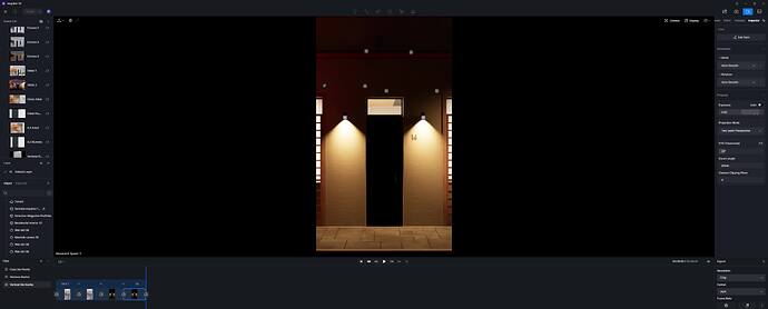

I’m doing a video where my scene changes from day to night. The night frame still shows light up in the rendered video even though the preview in D5 shows dark.
Restarting D5 didn’t solve the issue.

I will try to reinstall and see if it works. I think it could be something to do with the exposure but even disabling automatic exposure will not get it as dark.
Here you have the video:
Thanks for the help
As I see in your video, you have 4 scenes set for your shot, I think the last shot(in which the light will turn on) is mistakenly set with the light layer still on! Can you check the last scene in the video sequence again?
the 4 scenes are just the day and night duplicated to start the movement a bit later and end the video a bit after the movement ends. Also which light layer are you referring to? What I do is set the ambient sun to dark hours to make the scene dark, I don’t know if this is the correct way.
