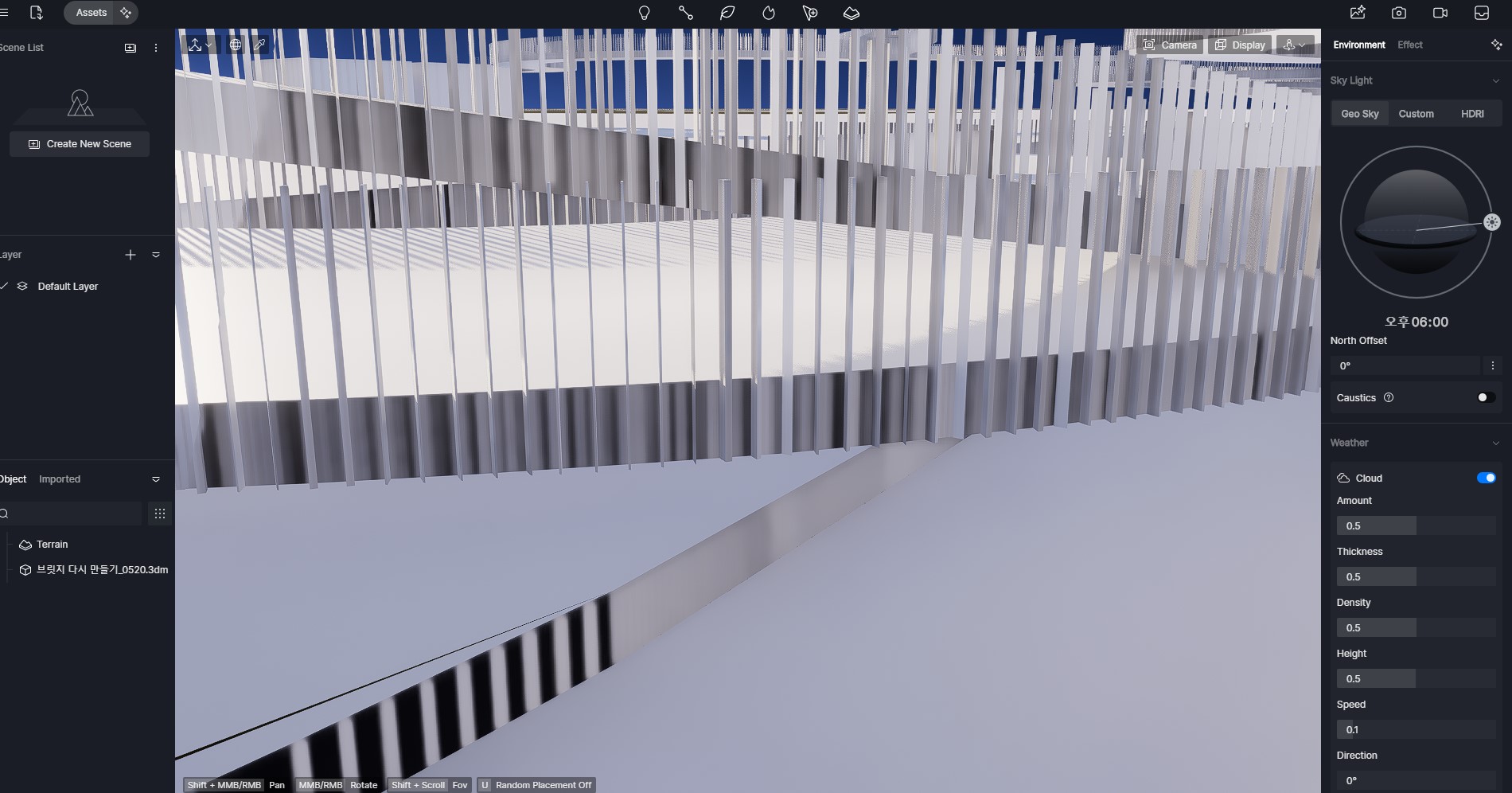

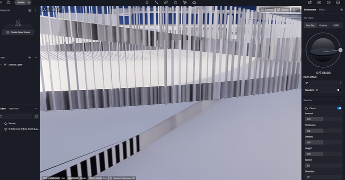

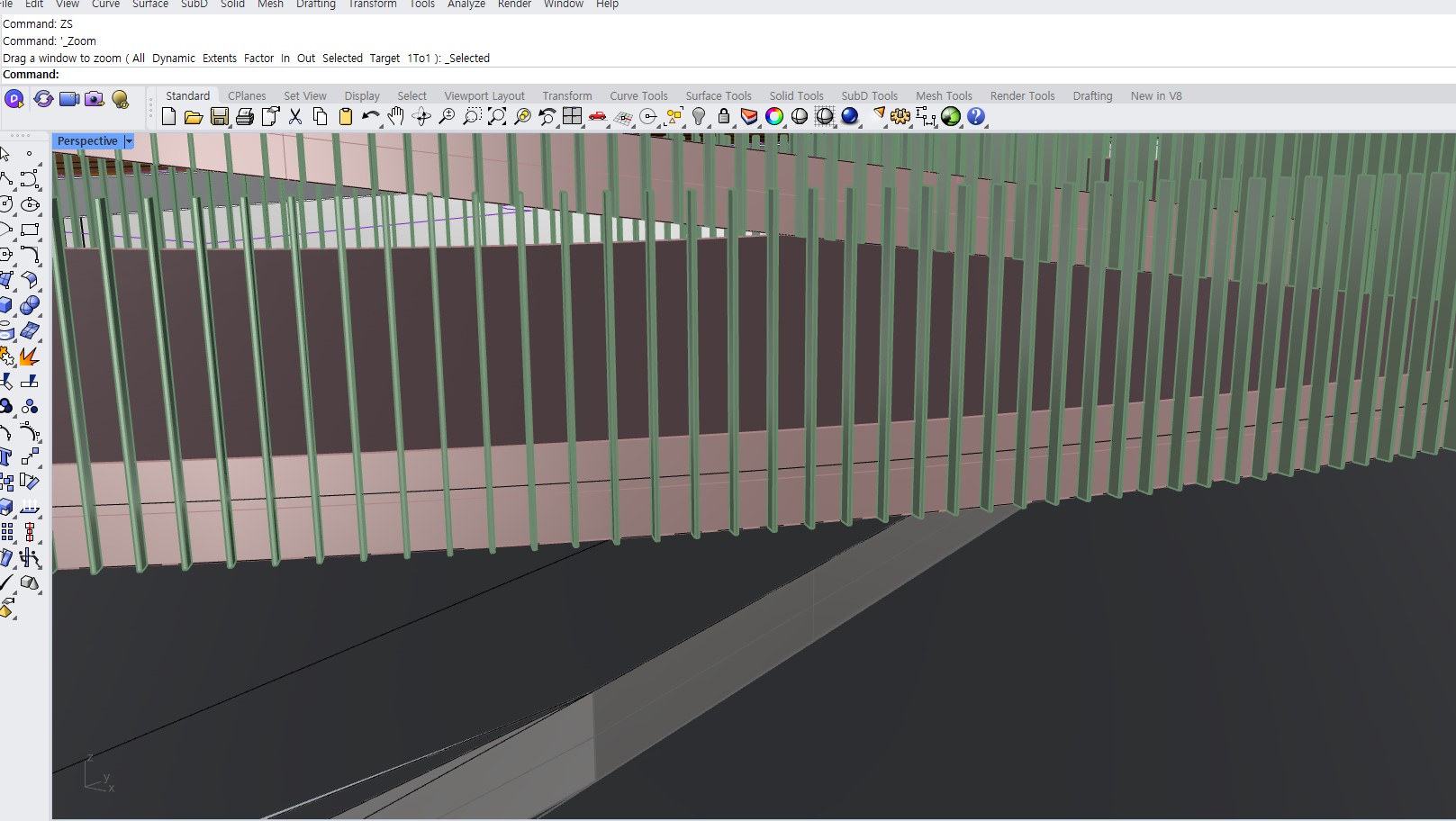

There is no problem with the Rhino model, but when rendering is performed, it crashes like this. help me please
  1. shape explosion
  2. Unidentified black line

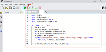

If it does not work, then please try the following:
  • Check if your model is located near the origin in D5 Render. If it’s too far please move it near to 0,0,0 XYZ Values

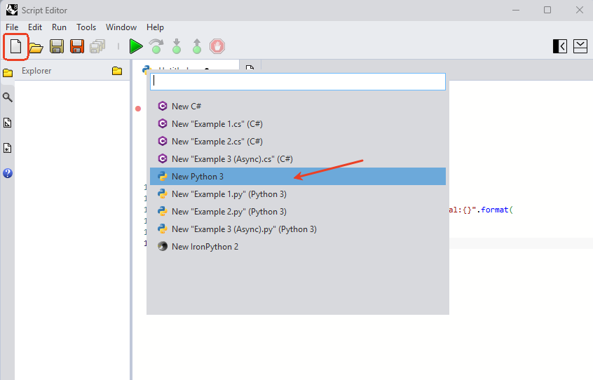

  • If changing the values in D5 does not work then, please also check your model’s location in Rhino you may move it manually or do this process

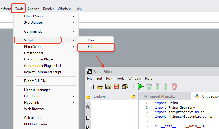

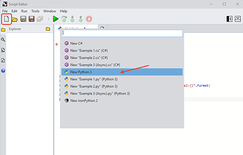

  1. Open Rhino - Tools - Script - Edit
  2. Select the Icon - Select ​New Python 3

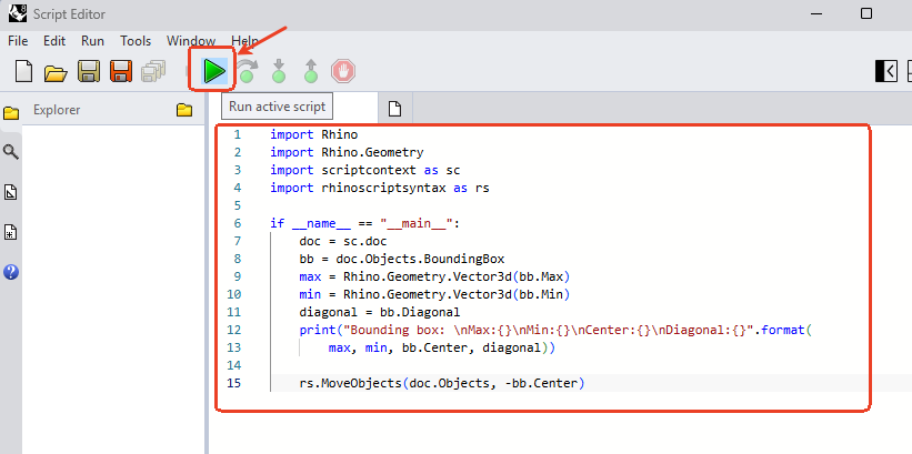

  3. Please copy this text and paste it. Then proceed to press the button.
importRhino
importRhino.Geometry
importscriptcontextassc
importrhinoscriptsyntaxasrs
if__name__==“main”:
doc=sc.doc
bb=doc.Objects.BoundingBox
max=Rhino.Geometry.Vector3d(bb.Max)
min=Rhino.Geometry.Vector3d(bb.Min)
diagonal=bb.Diagonal
print(“Boundingbox:\nMax:{}\nMin:{}\nCenter:{}\nDiagonal:{}”.format(
max,min,bb.Center,diagonal))
rs.MoveObjects(doc.Objects,-bb.Center)
