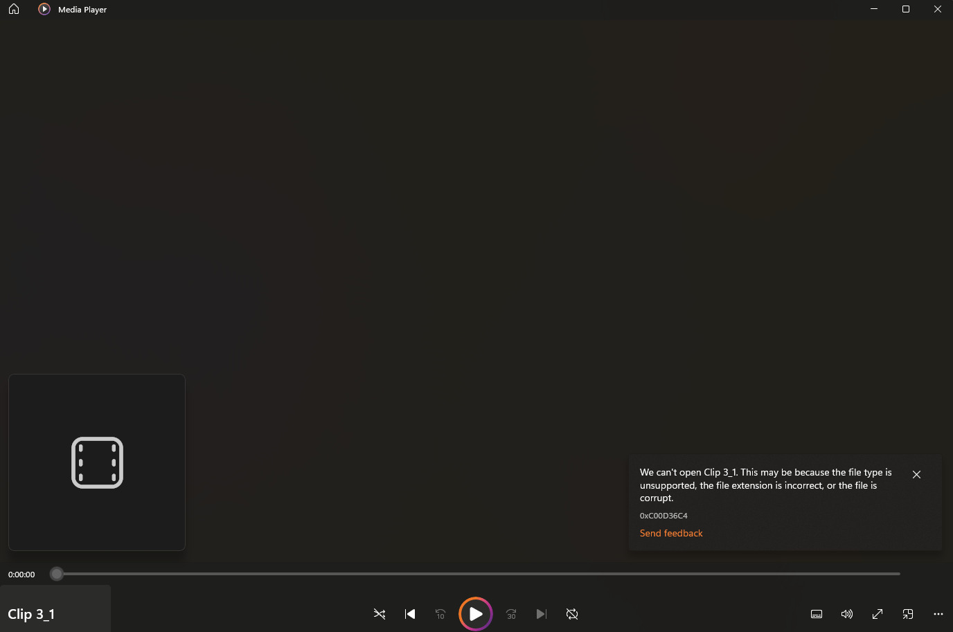

Issue Description: Can’t create video render properly. Created videos are always corrupted.

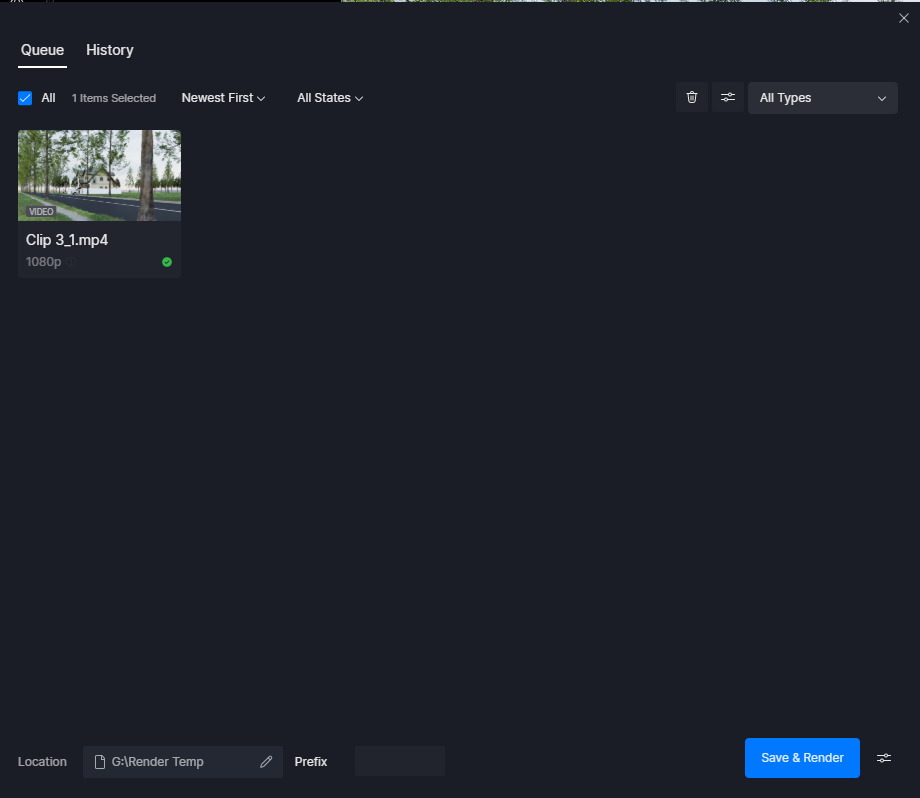

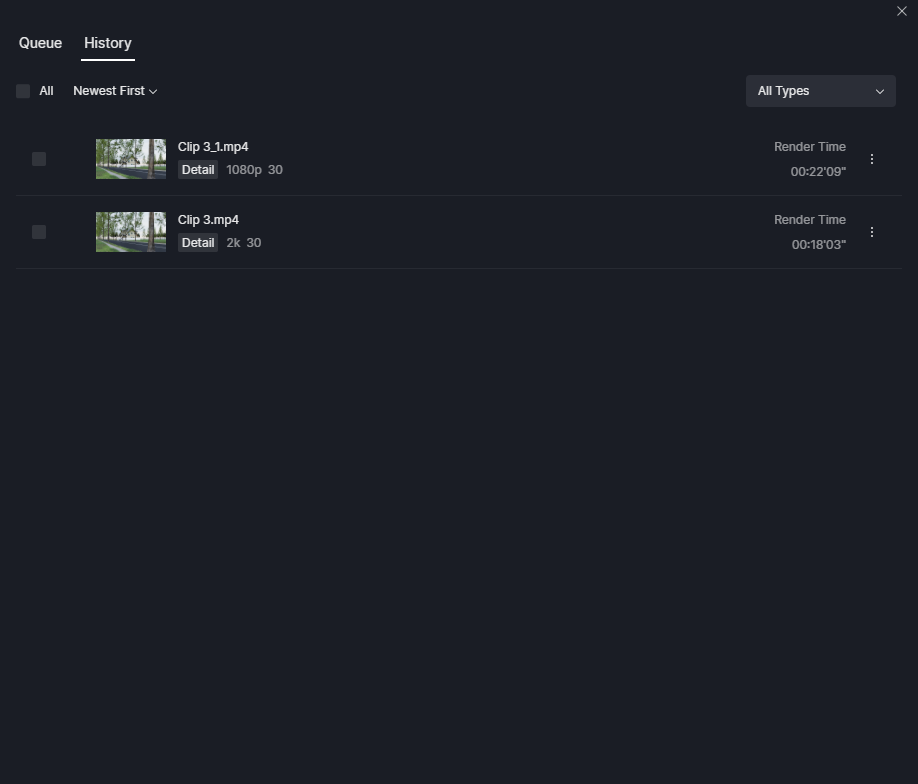

I use Render Queue after creating 100 seconds animation with the settings: 1080p, mp4, 30 fps… It goes though the render and took 22 minutes and 9 seconds. when I open the video file, my video players (Media Player and VLC) cant open the created file. I’ve tried to render 10 time already and wasted quite some time. Also set the video quality lower but D5 render still cant create a video I can use.
I also disabled Super resolution and FPS Booster and still cant open the video created. Always have this “video corrupted” issue.

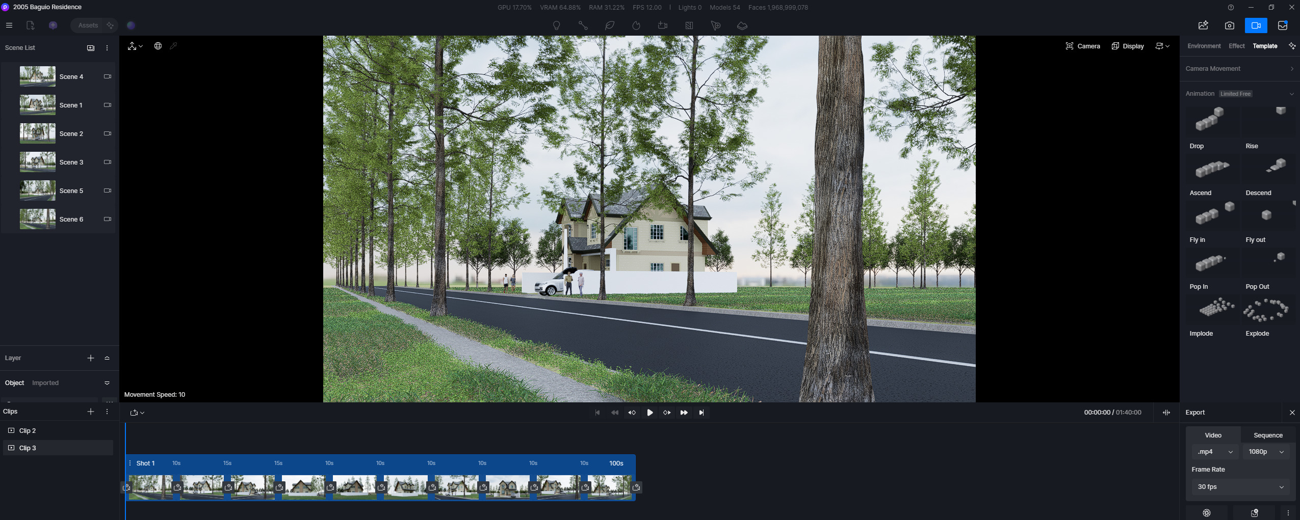

I deleted the video clip and recreated a new clip and it worked. It seems problem happen while creating clip shots. I will definitely do your recommendation on reporting in case it happens again. Thanks for the help. Cheers!

I just tested your file from the email you sent a few days ago. Basically, I rendered the clips (mp4 format and not .avi) that were already ready to be rendered and changed their quality to 2k just to see if a higher quality yields video corruption.
