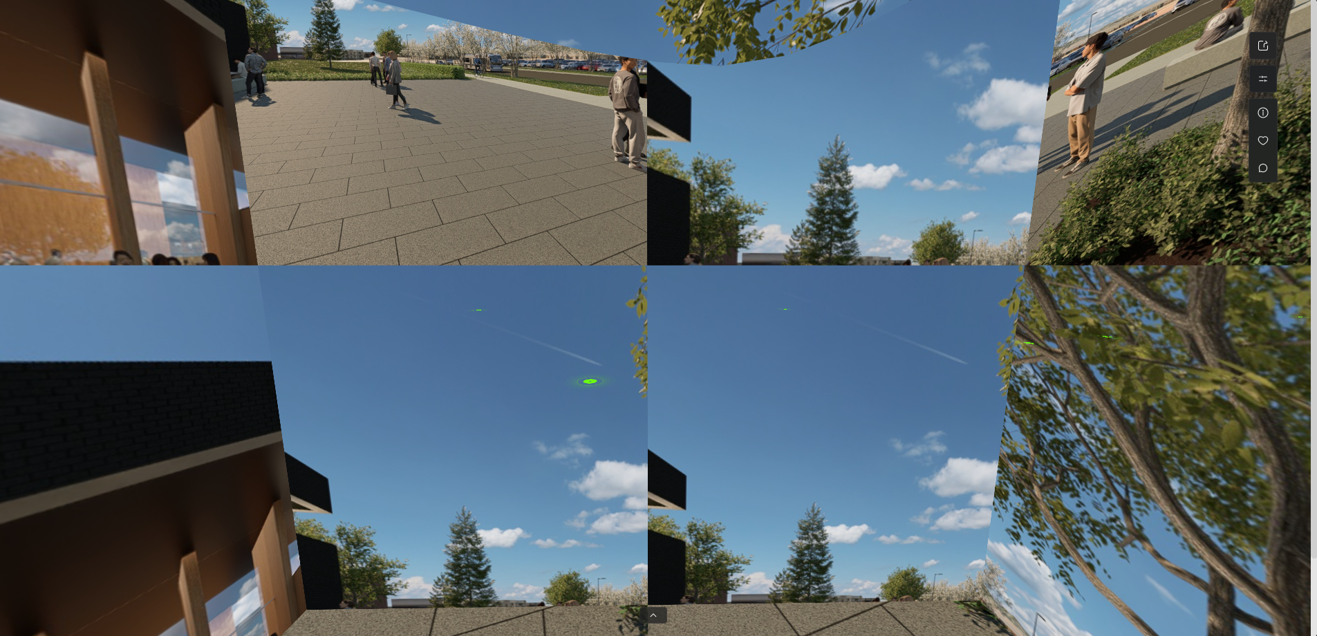

I am working on creating a Render Tour to use with the Meta Quest 3 for a client and when I rendered out 79 Scenes the renders are creating a “tiling”. Its almost as if the tiles are in the wrong position and if they were to be repositioned the image could work. See attached screenshot.
I have done this same project with less scenes, maybe closer to 30 and had no issues.
One thing I did notice is that this “tiling” issue only occurs in showreel. I have opened this same project up as an exe on a local folder and it looks great.

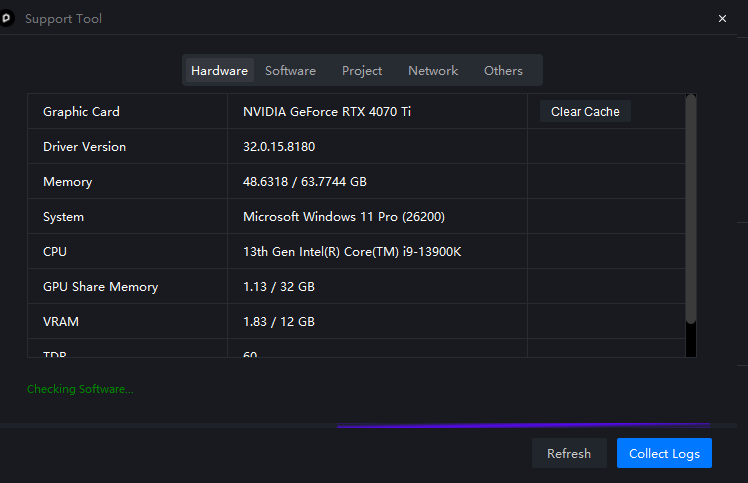

Log Files Screenshot:
Thank you!
Apologies, here’s the ziplog:
zziplog.zip
Hi @bcross Please install the latest Render version from the official website and let me know if the rendered tour is still the same. I have shared this with our team for further investigation. Apologies for the inconvenience.
Hi Anthony,
I have gone ahead and updated to the latest version of D5 Render 3.0.0.076.
I tried rendering it out again with all 79 scenes and experienced the same tiling problem. I also tried exporting just the first 50 scenes and it displays perfectly.
Please let me know if you’d like for me to attach anything extra for your team.
Thanks again!
Hi @bcross The issue has been resolved after updating some configurations on our end. Please try again and let me know how it goes.
That fixed it!
