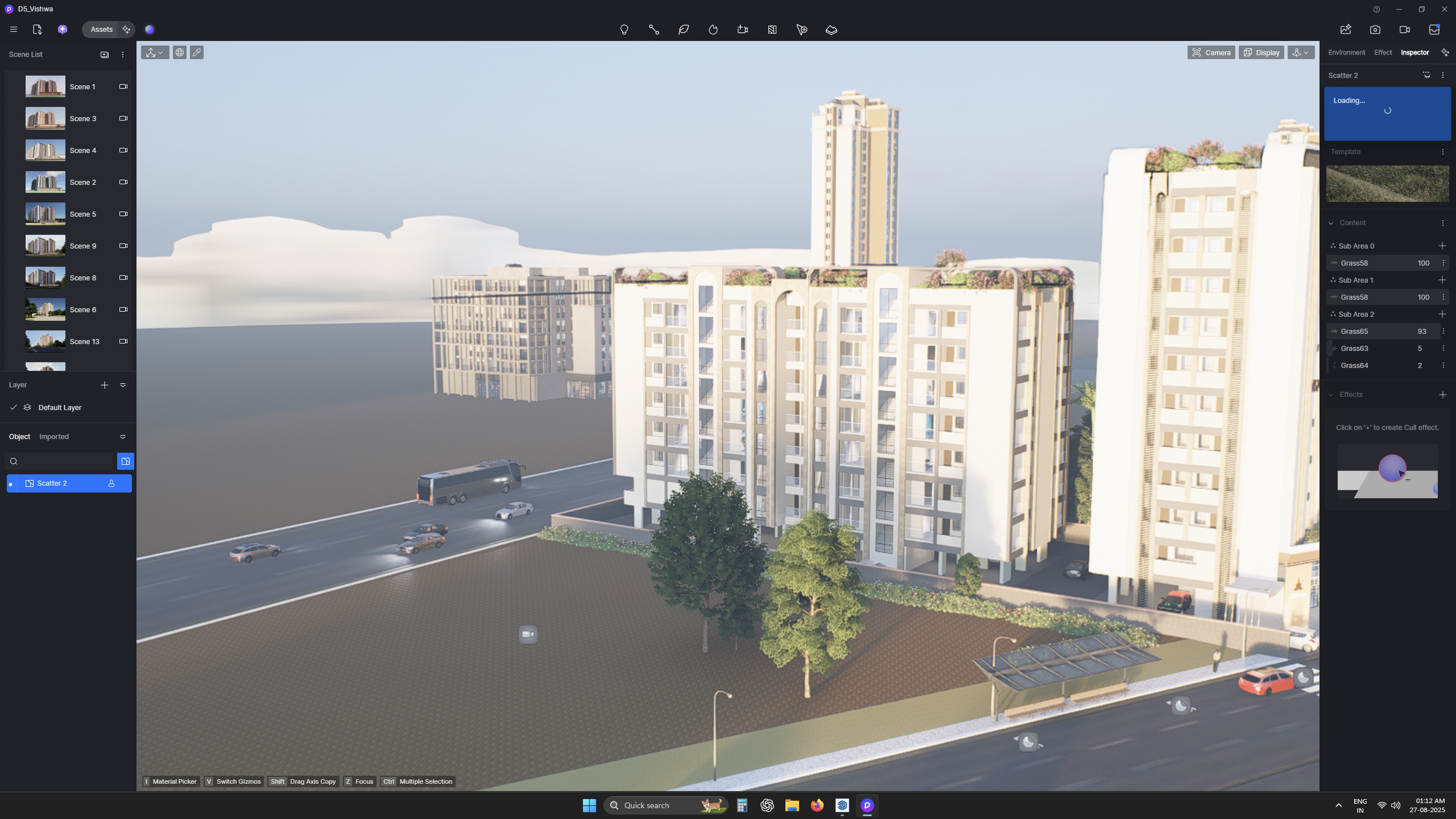

The issue is whenever I have to do something with the scatter it regenerates and I have to wait for it to load and after that D5 render crashes. I need an urgent solution for that cause Im on a tight deadline. is there a way to just delete the scatter without it going in that ridiculous loading situation.

I havent changed any scatter or the 3d positions in D5 but i have to hit regenerate. All i do is change a few thing on the base sketchup file which has all the building and the surrounding context.
I cant delete the scatter until the regeneration is complete and after a few hours D5 crashes

Making changes to these surfaces where the scatter is located essentially requires regenerating it. I’m not just talking about the changes in D5, but also in your 3D model.
You can send us your model so we can check the problematic surface. Thanks
