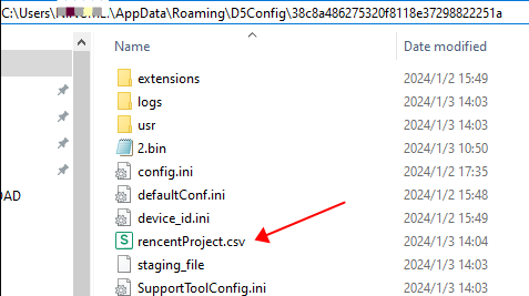

Can you let us know when this issue occured? Is it after a recent installation/reinstallation?
  • This issue typically arises when D5’s installation path has been changed from its original location. The RecentProject.csv file, located in the D5 configuration directory, is used to keep track of recent projects. If D5 has been reinstalled to a different location, this file may be missing.
  • If this is the case, you can go to the previous path, copy the file recentProject.csv, and paste it to the new location. Alternatively, you can reinstall the software in the same path.
