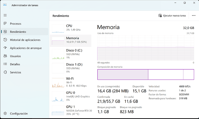

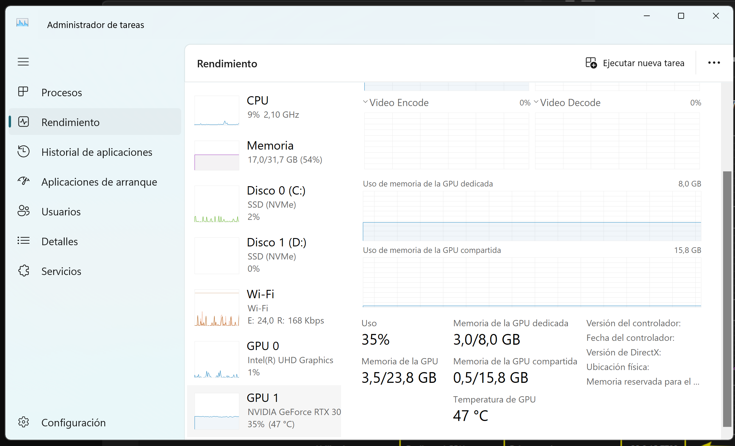

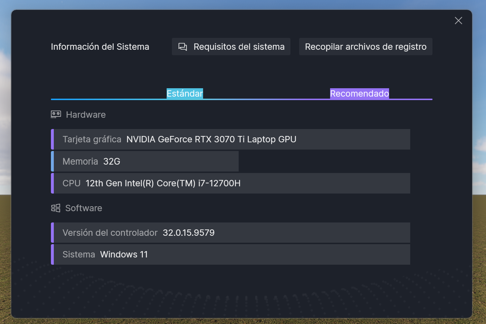

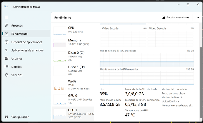

Can you send us the following images:

The images you’ve sent are normal; there’s nothing wrong with the values presented.
