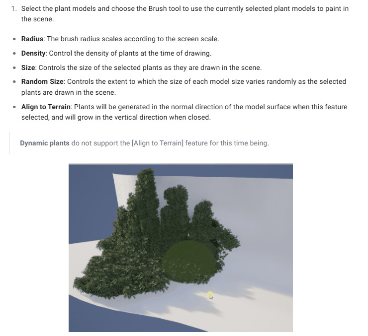

Hi @spencer.k527

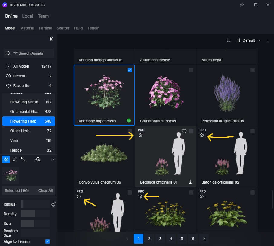

I apologize for the inconvenience. Currently, the Align to Terrain feature does not work with Dynamic Plants.
Dynamic Assets or Plants usually have this icon above their thumbnail
